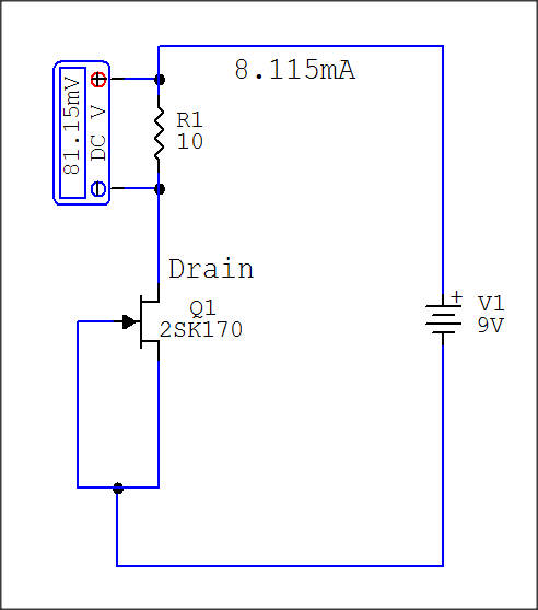

2SK170BL Idss
Testing jfets for the pre-pre. The measurements are a bit strange.
Tested over 10 2sk170bl jfets and they all measured 8.75 Idss exactly.
Some went to 8.76, then dropped to 8.75. They all arrived from the same shipment. The power source was a 9v battery.
Is it normal for so many to have the same Idss?
I'm not complaining, but has anyone else seen this happen before?

Although, it's a shame and most likely not the same case here, but I can share my experience getting similar results. It's just that my DMM was turned to mV instead of mA. Reaction was the same: „How's is this possible to have that kind of matching?"
Although, it's a shame and most likely not the same case here, but I can share my experience getting similar results. It's just that my DMM was turned to mV instead of mA. Reaction was the same: „How's is this possible to have that kind of matching?"![]()
That's it!! Thanks!
Follow this with your DVM in mV maybe it will be stabler in your case. Let time after you had touched each JFET or better use a tool so it will not get or keep your fingers warmth. During measurement wait until the rate of climb is minor or set a limit same for all. Say 2 minutes.
Thanks Salas! It does sort of stablize after 30 seconds or so, then the climb is slower.
I've been recording the reading when it stay on the same value for 10-15 seconds.
Will that get me close or should it stop complete?

That will get you close. Only do the batch tests same day @ ~same room temperature. If it is a hot day use the aircon.

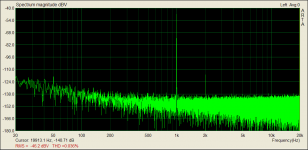

Yes, the pre pre can have some Idss variance but not much. I don't trust the stability and noise of battery chemicals over time and brands. I prefer the active filtering. ~15mA per channel is going to drain them fast also. But its your choice. See the noise floor of a pre pre I made recently without battery on electronics PSU only. 5mV output, 1VRMS=0dBV. I think its adequate.

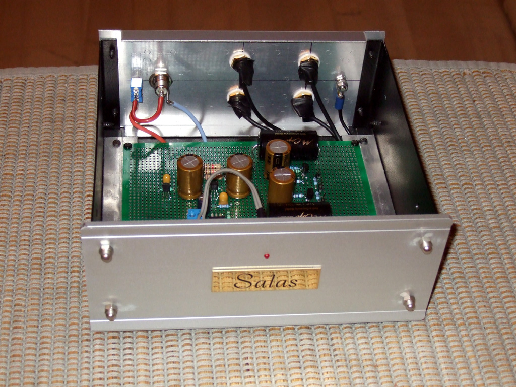

Congrats Salas, very nice & neat work. Could you post more pics of insides & psu, are you using Nichicon Gold Tune in the pre-pre?
Yes those Gold ones are Nichicons for audio (oh, oh). No new pics because I have sent it abroad. I used an external linear regulated wall brick for no AC cables to enter. So its pre regulated also.
