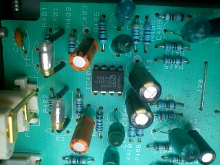

I tryed connecting Low MC pre-pre to EB lineamp without MM pre: sounds low as expected without buzz with music in both channels so as I suspected is the Rotel MM the issue of buzz in channel left & no buzz no music in channel right, I will open to inspect.
I can't see nothing wrong

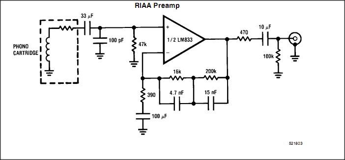

I suggest you check your TT. MC pre pre, and SUT to another MM stage of friend's if possible, or make a typical stage from cheap op amp datasheet. Nothing makes sense till now, contradicting evidence, that can't make us useful opinion givers.
Yes it droves us crazy, I always suspected of it😡
