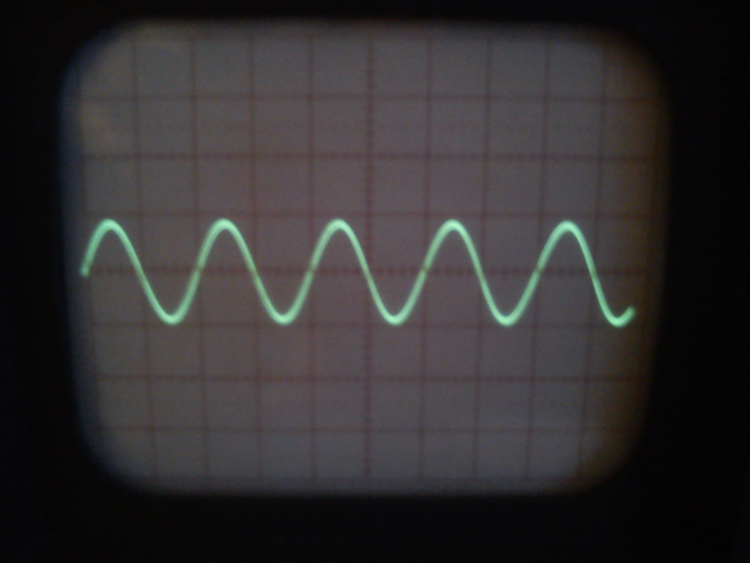

Try to put your scope on your hole amplification chain.
Do you still get a healthy sine wave?
If still yes, then maybe there is either a ground loop or you are missing a ground somewhere.

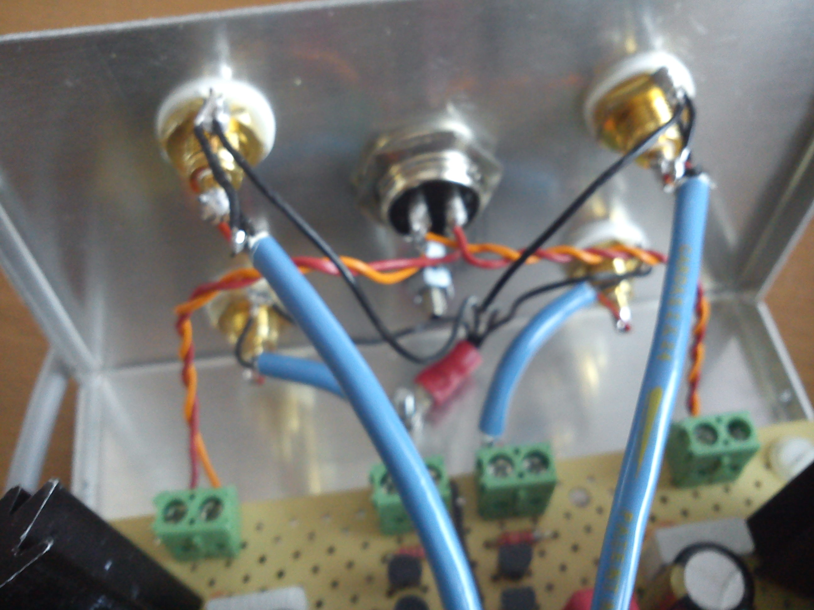

In the Low MC pre-pre the signal ground isn't connected to chassis, TT ground is connected to chassis ground.
In the Partridge step-up the TT ground is connected directly to Rotel MM.

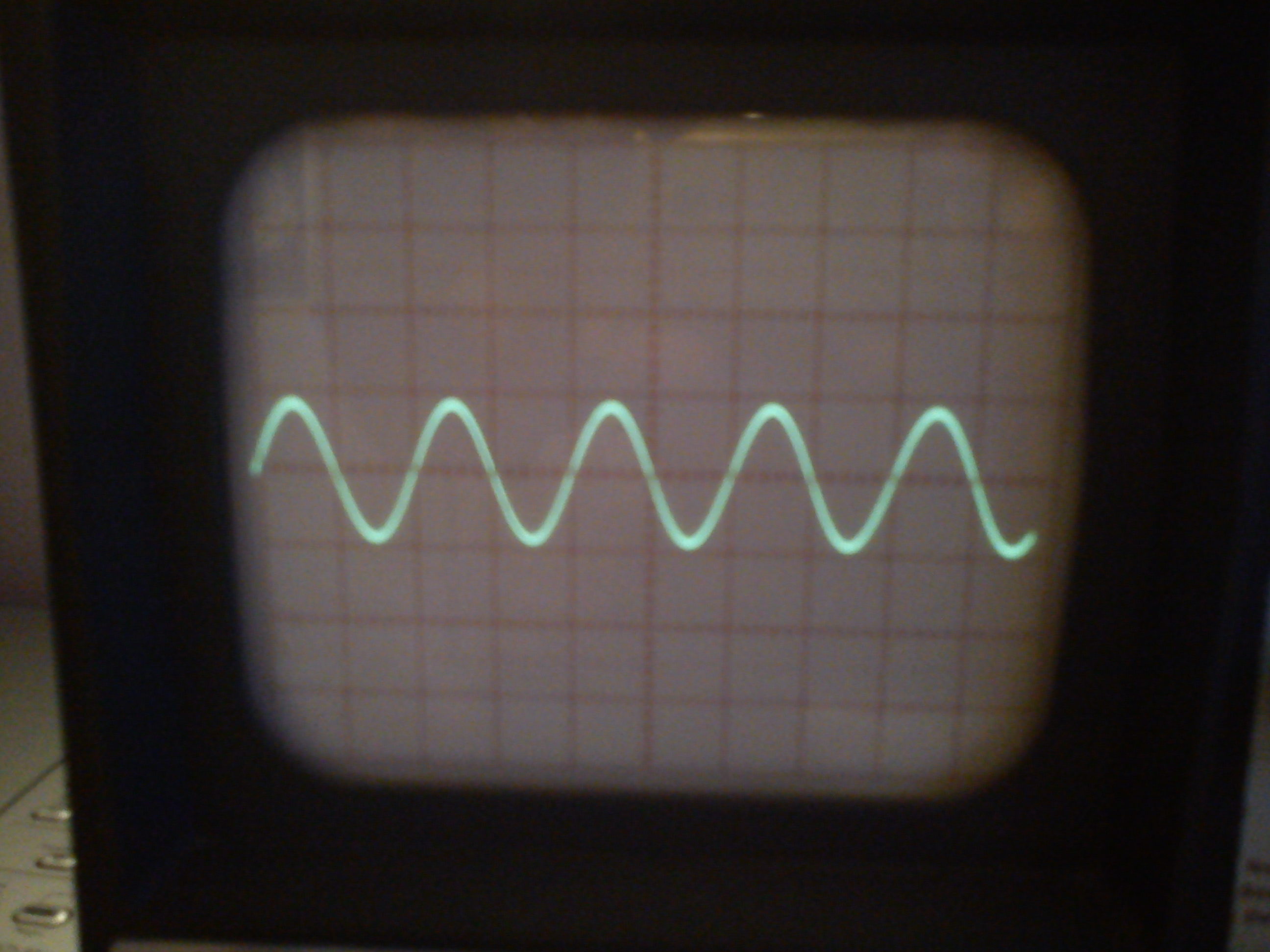

I connected the Low MC pre-pre to Rotel MM and I have a perfect sine wave🙂
I suspect is a ground loop in the Low MC pre-pre so I will do proper wiring gnd to avoid it.

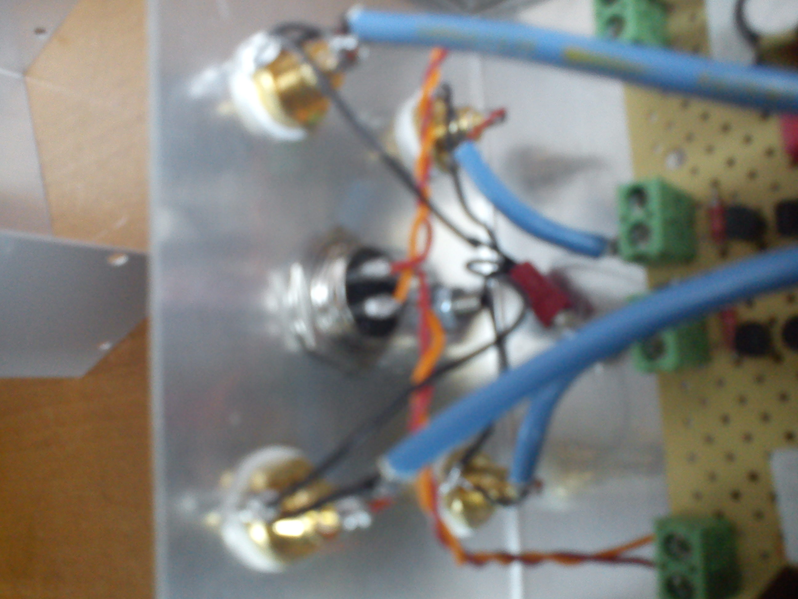

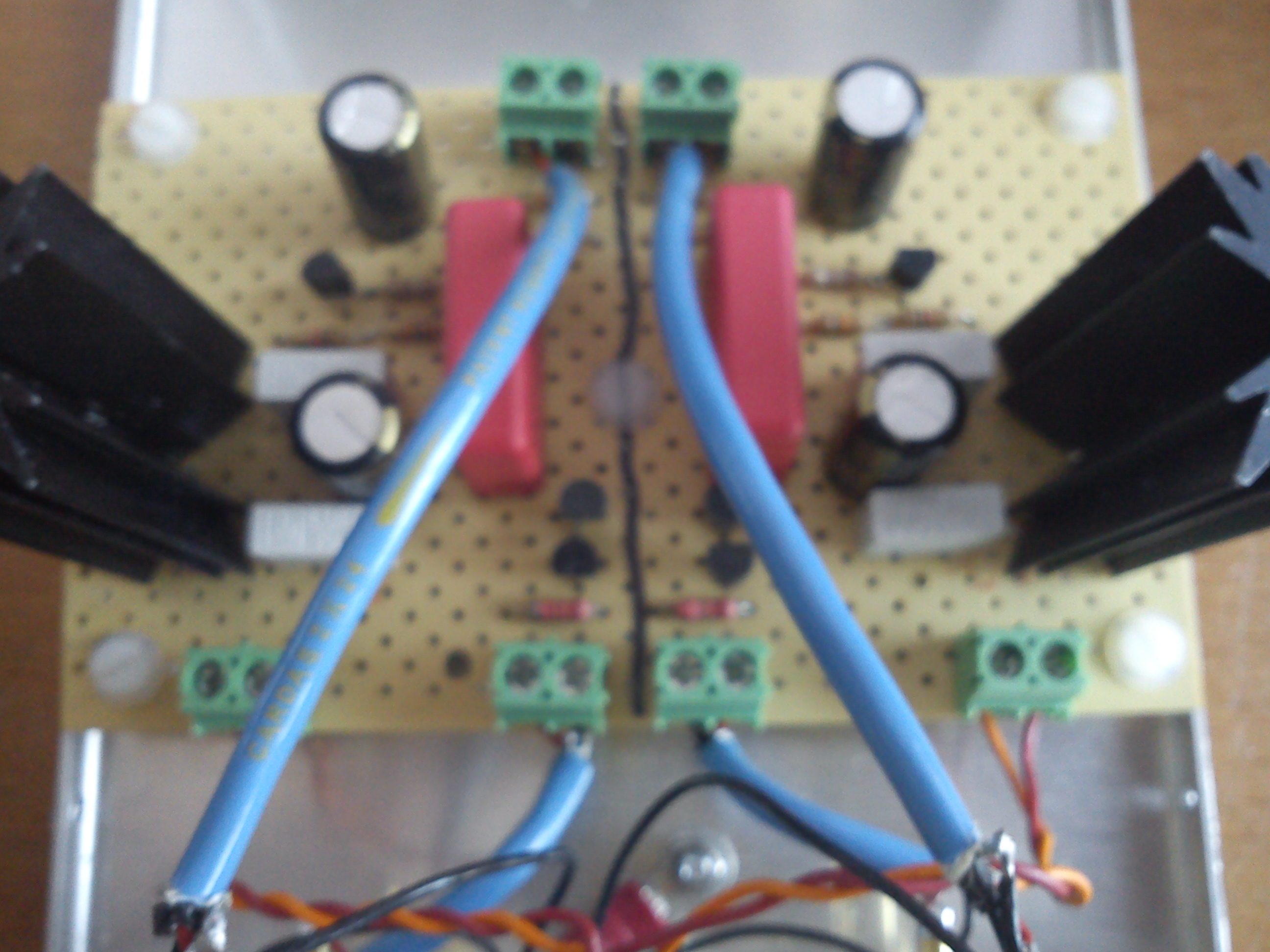

Something is not connected properly. If you have a sine from the scope you should have music. Maybe post a picture of all the cabling, so if somebody with a sharp eye can help.
For start, I would remove all ground wires from the rca to the chassis and check.
Then one wire from the star of your circuit to the chassis.
These are just suggestions, I would recomend to try various grounding arrangements and see.
Why are both input and output gnds tied to the star gnd?
Would it not be better if they were both floating?
I have to ground stars one for each channel, have I to connect the two ground stars togheter & after one wire to chassis or have I to connect two wires (one of each channel) to the chassis?
