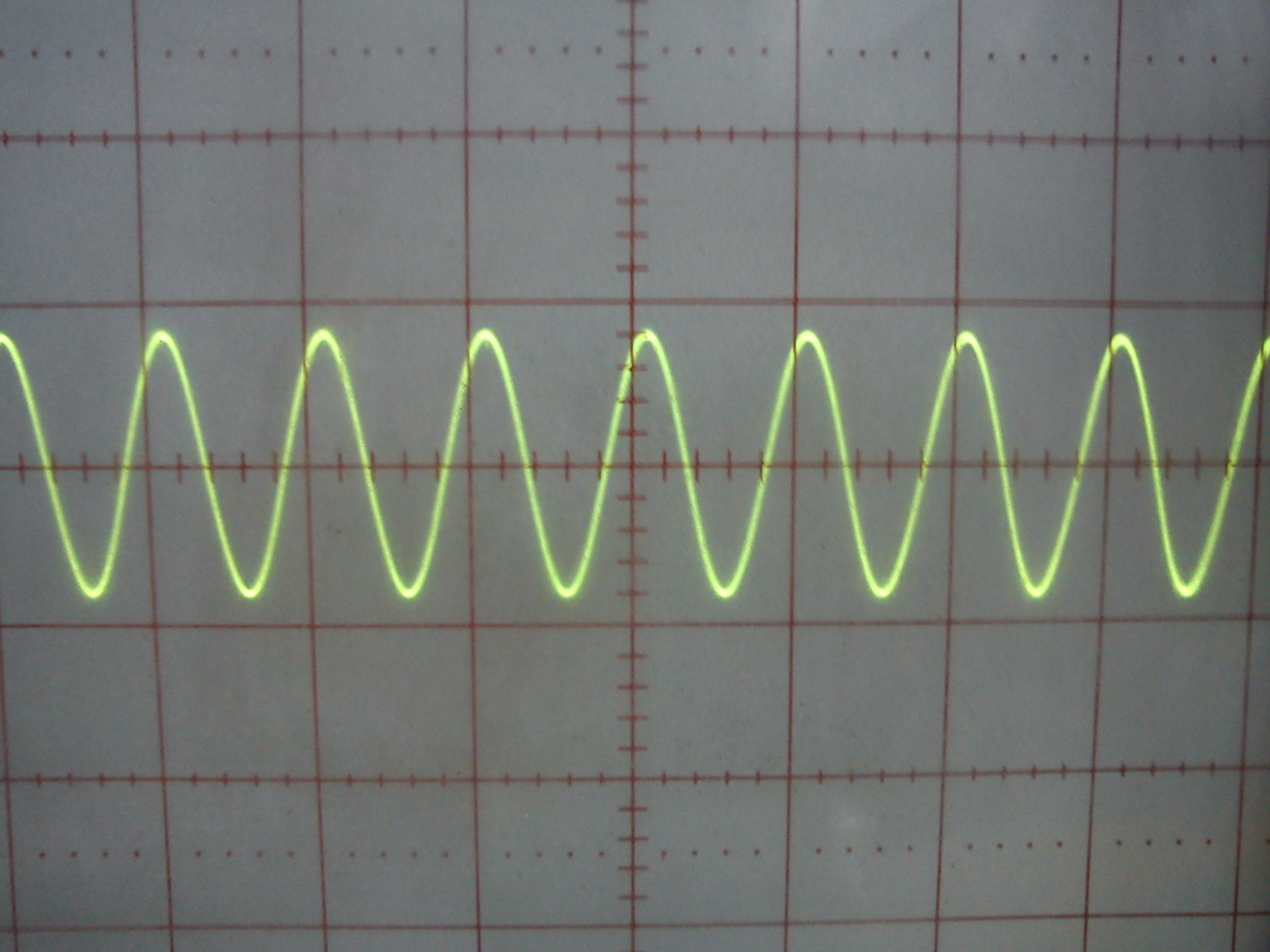

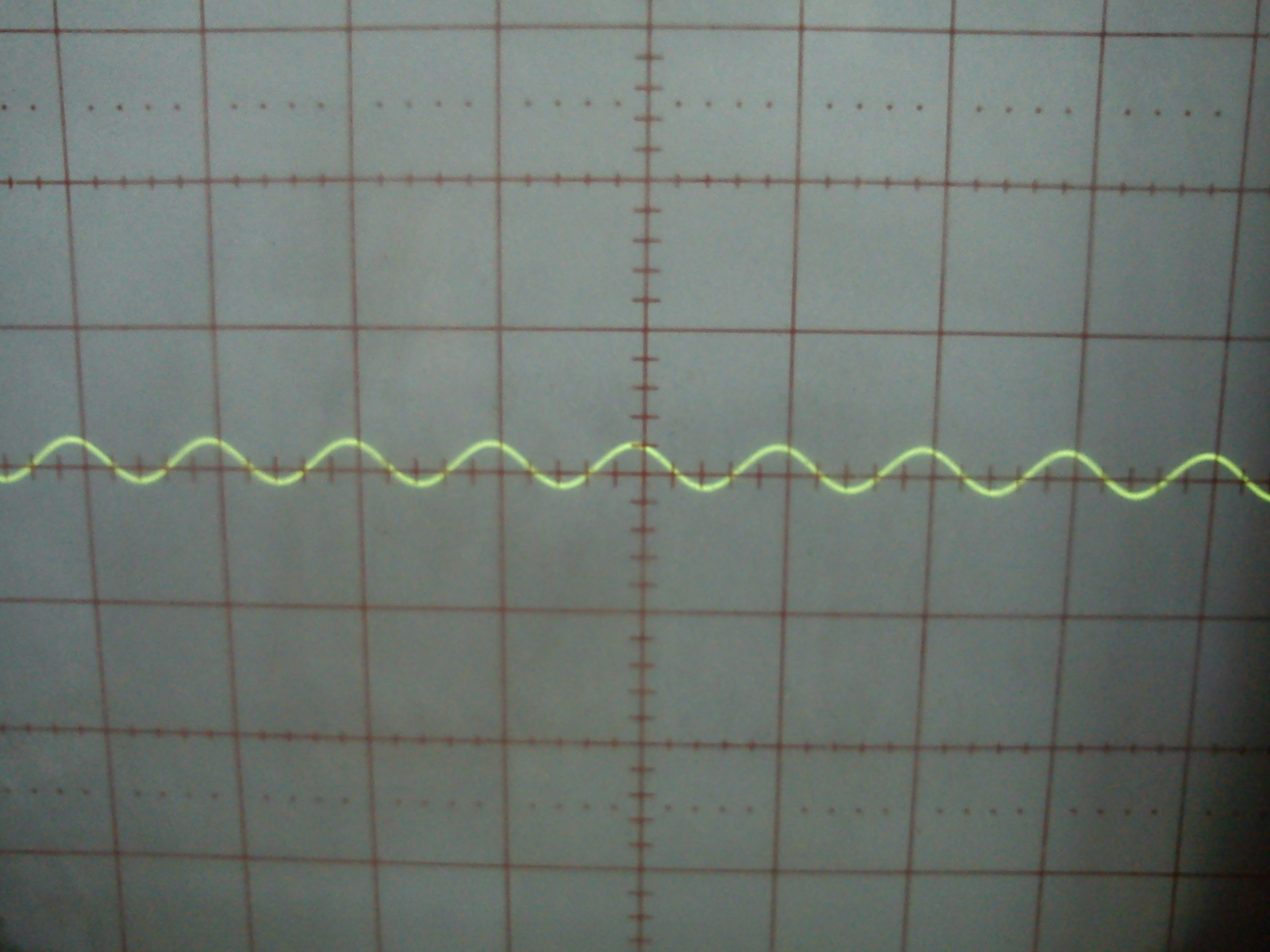

Simplistic NJFET RIAA
1st pic left channel, 2nd pic right channel, both always feed 1st the 1kHz from signal generator & after connected the scope at the output of Low MC pre-pre
Lets say 1.6mV pk-pk to me because the line is thick to watch such low and looks less than 2 sub divisions, give it some vertical scope tolerance, your#7761 displays look 16mV pk-pk, that's 10 times=20dB, channels look identical, you are A OK.
