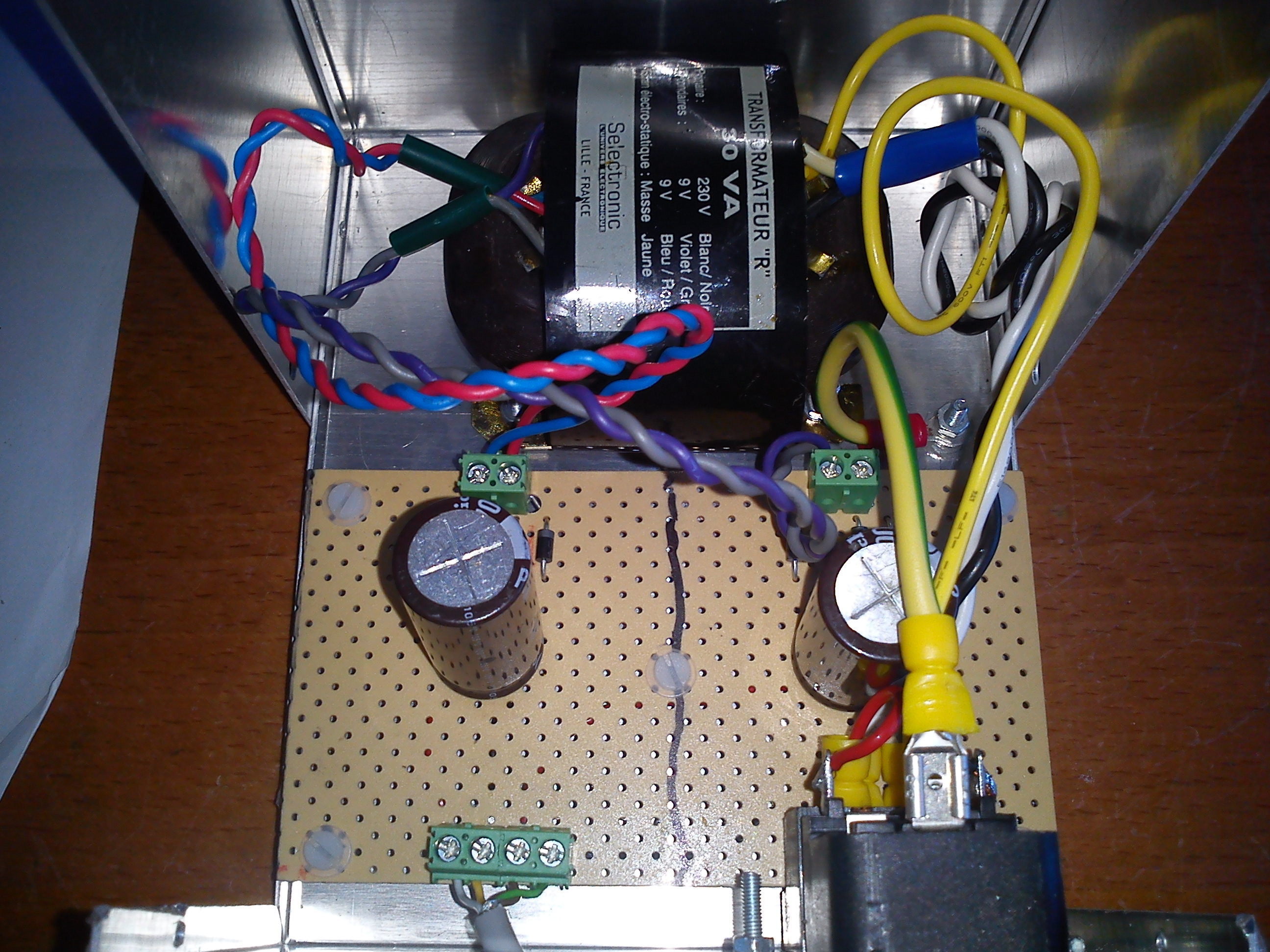

Why you want to take out the cap multiplier. Use the circuit as designed. There is a chip reg at 9V then a filter. The cap multiplier filter eats the reg's noise by much and brings down the voltage also. Its designed to work form that final voltage.

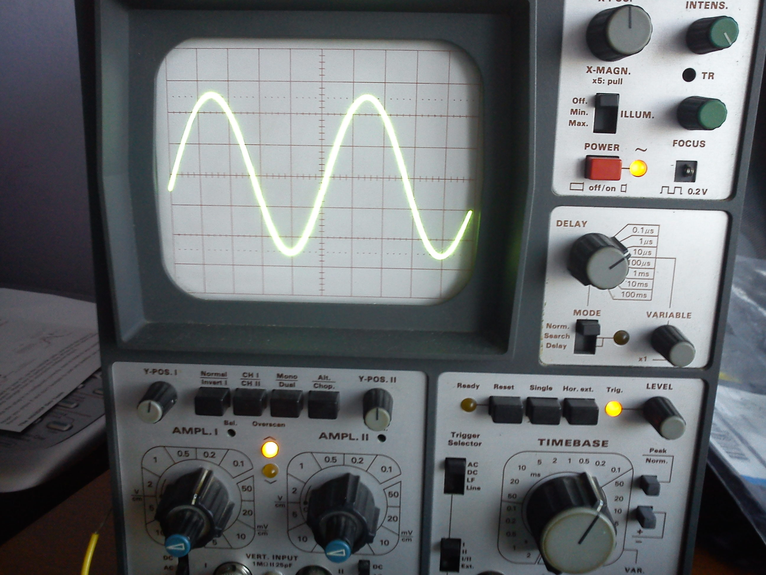

Build & measurement pics Low MC pre-pre
1st pic right channel
2nd pic 1kHz direct audio generator 30dB attenuation

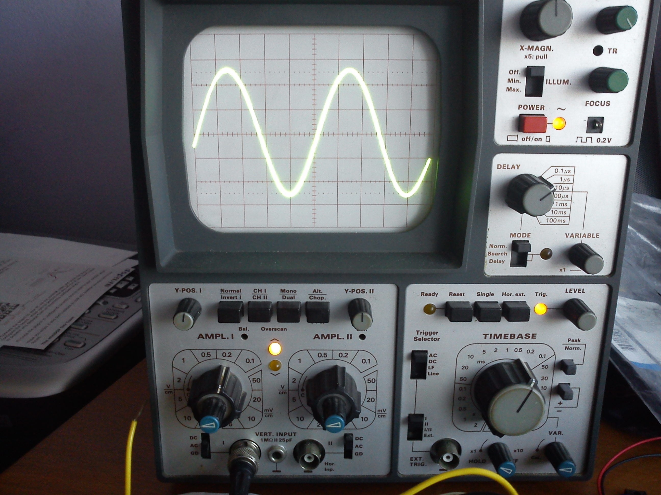

3rd pic lefht channel
probe x1

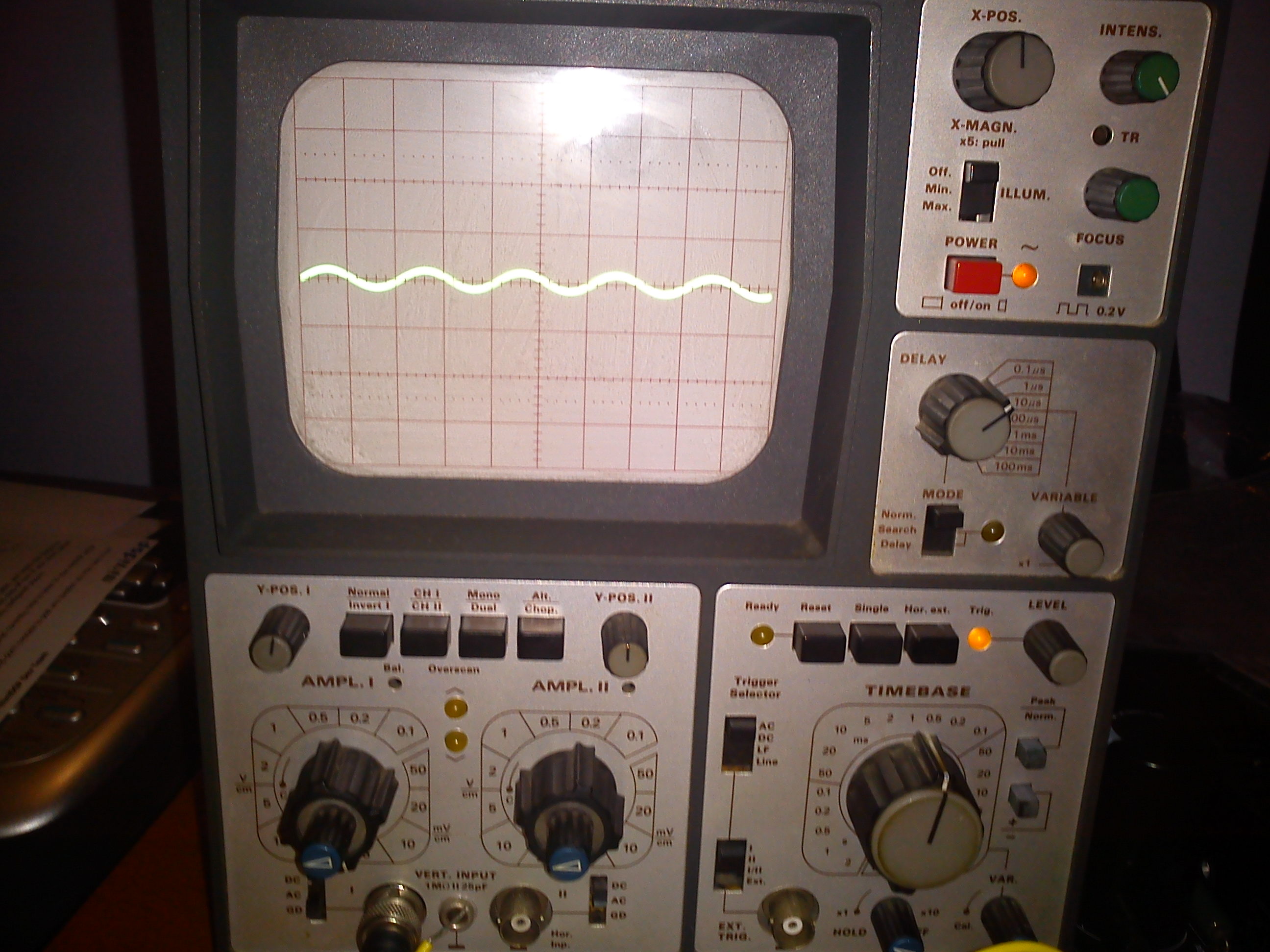

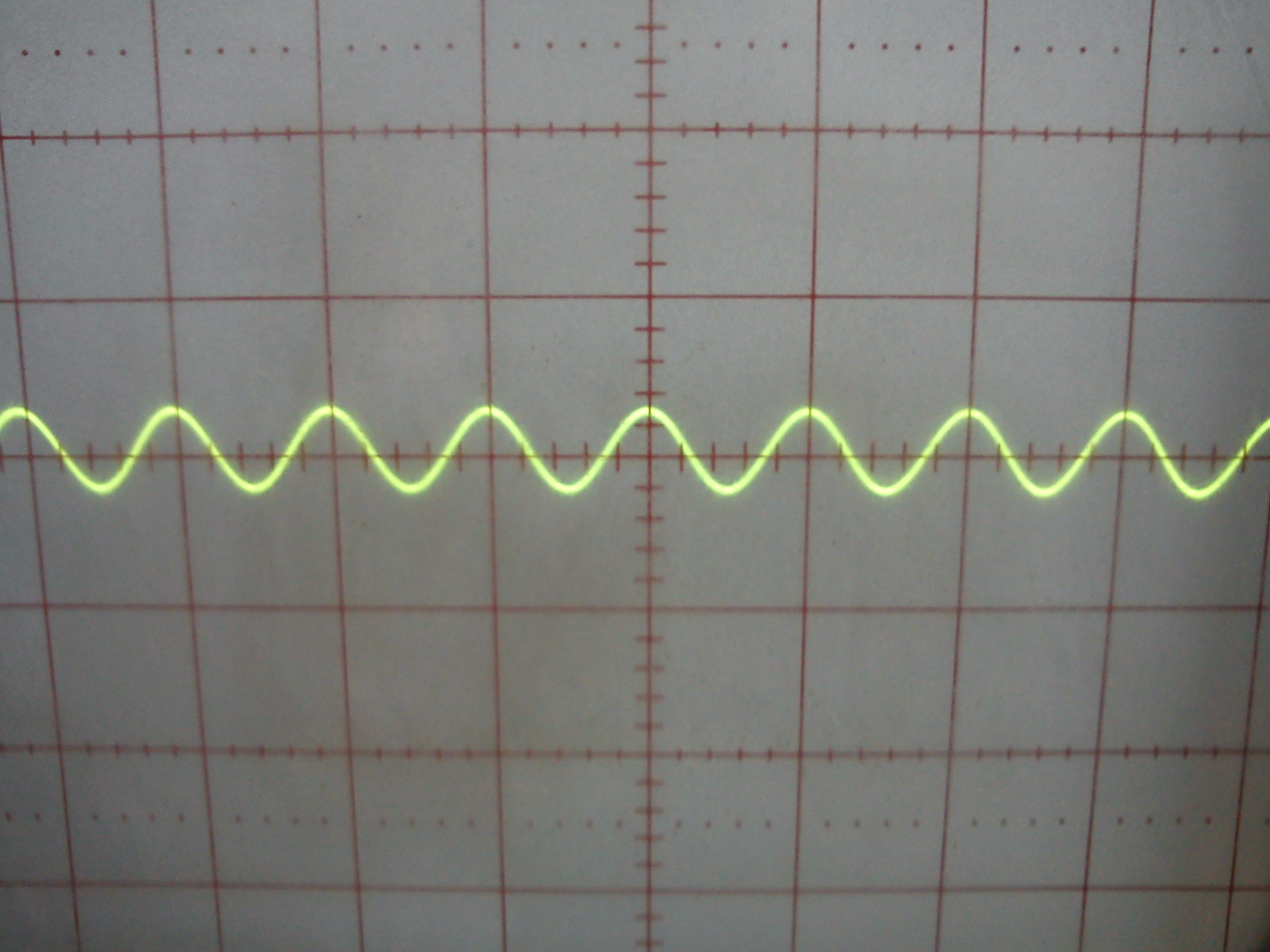

4th pic Low MC pre-pre including capacitance multiplier
5th pic R-Core separate PSU
Are the measurements OK?

When you feed from gen's Zo Ohm to cart load value, better tap off to scope as you feed the pre so to be sure what actual input remains when comparing output to the other channel. What is the signal source impedance and what is the input pre-pre's load?
Its simple. 600 Ohm to 220 Ohm form a 1/3.7 Lpad. So you lose much of your signal that you saw on 1 MegOhm scope channel before. To have 1mV pk-pk (0.35mVRMS) on the pre, see 3.7mV pk-pk on your scope directly from your generator first.
