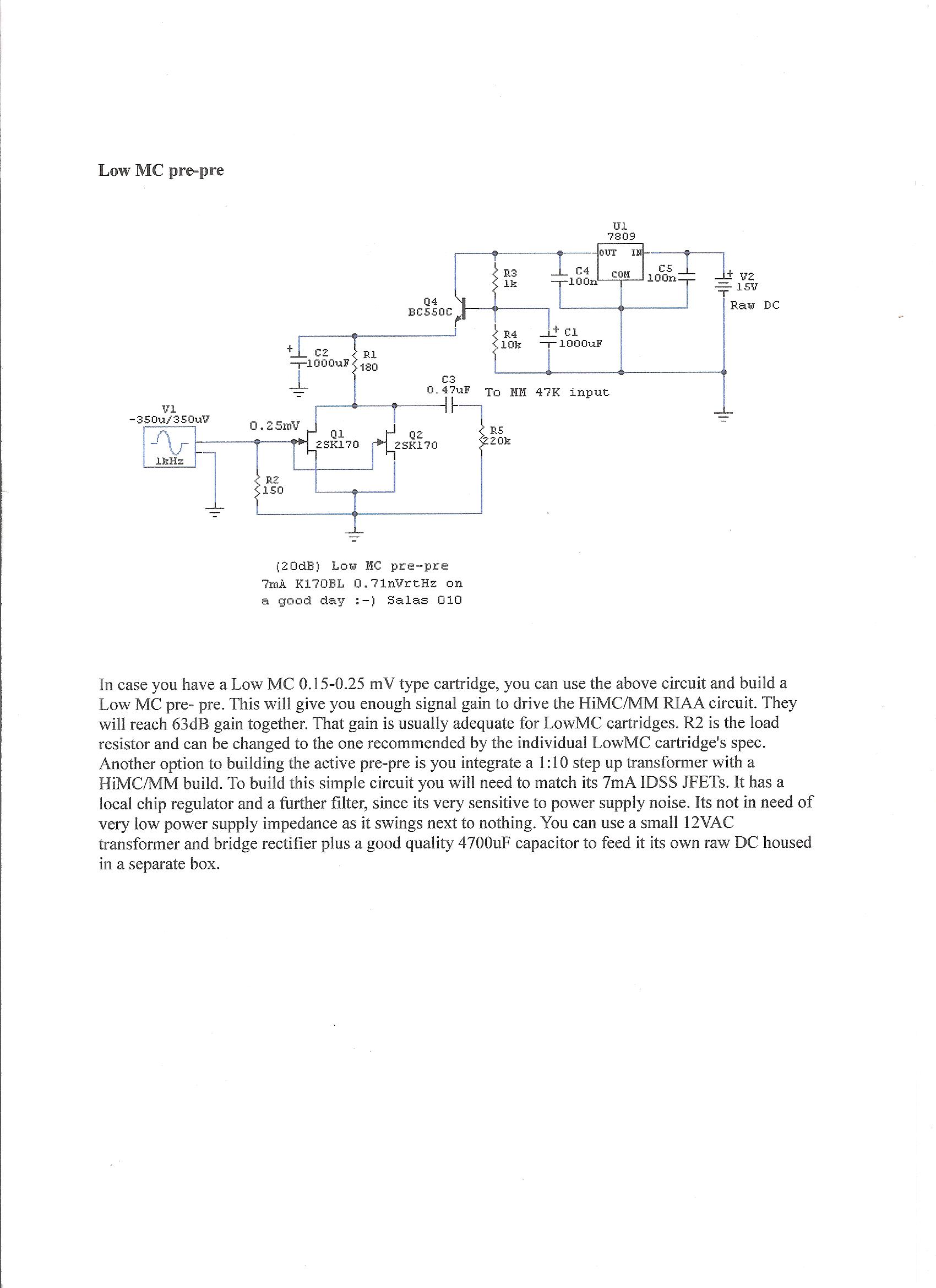

How well did your battery hold it's "starting" voltage till the completion of the 28 measurements?
If it started @ 9.0V and held at >8.9V till the end then Vds was in the range ~8.3Vds to 7.8Vds. Good enough for rough batching to 2 sig fig.
However if the battery voltage fell to ~8V, then the Vds range changes to ~8.3Vds to 6.8Vds. This range of Vds being very significantly different from the 10Vds specified for Idss will increase the "errors" in your results and between your results.
A quick scan of your 20 posted results shows Idss between 6.3mA and 10.1mA
Just measured the battery and it's 9,09V!
pre-pre low MC 20dBs
How can be modified the pre-pre low MC 20dBs schematic to run with batteries?
