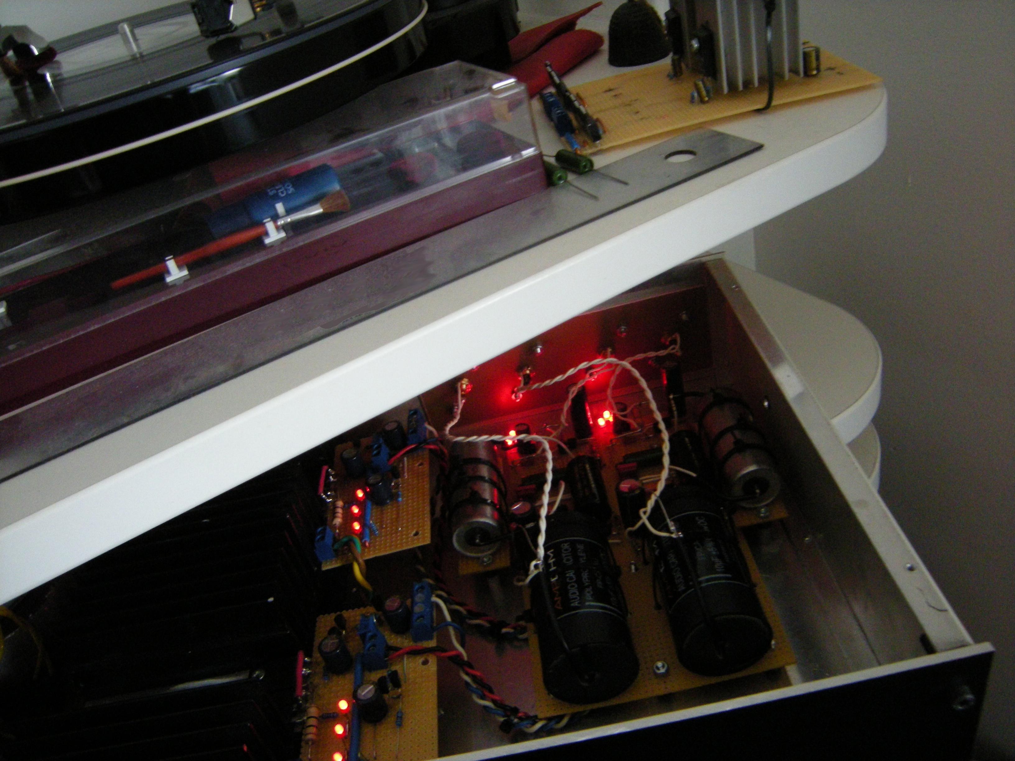

today I finished Salas-RIAA-V1102F0. It sounds very nice and detailed, thank you Salas, but at the moment I think I over done it with takman carbon resistors, it is a bit to mellow. I like it but I'll change 47k in the signal path to metal film (PRP). Also I started with 1uF(Ampohm paper in oil) at the output and that took away some very low end. Paralleling another 1uF brought the low end back. I'll avoid PIO as well, and go for the polypropylene at the output (100n is Mundorf Supreme).
The only thing that is a bit of a problem is that I'd like to have more gain. My R2 is 100ohm (Grado black 5mV). I'd like to get closer to the CD output level so I don't need to change the volume so drastically when switching from TT to CD.
Any ideas how to get more gain? Another gain stage? Or changing R2 to 39ohm?

Nice initial outcome and room for tuning to your liking then. Congrats. Try lower R2 as you mentioned, in steps though, down to the point you will feel the gain has raised significantly but before audible overload distortion is kicking in.

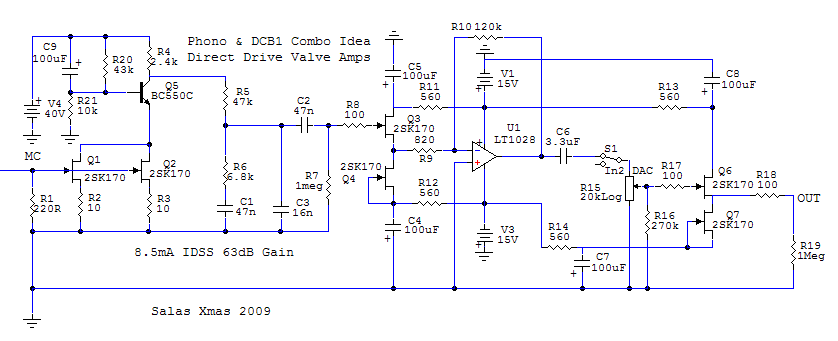

Maybe you remember this alternative MC&PRE combo I had shown once? Its a matter of Rf/Ri on the OPAMP the output gain and 2nd stage won't shake for THD.

I went for 28ohm R2. No distortion, sine wave looks good on o'scope (pre fed with 7mV sine 100Hz). Now I'm much closer to CD out (~1.6V).
I also paralleled 100n with 330n Russian pio, and changed the output cap to 4.7uF. I was short of very low sub frequencies 🙂 . No hum, buzz rumble etc.
When music is not playing nothing at all comes out of the speakers.
This pre sounds fantastic, thank you very much again Salas. Another improvement and not small at all IMHO, are 10uF PIOs bypassing 10000uF PSU caps, but I'm not sure I'll be able to fit them in the box.

Nice enlightening experiments Milos 🙂
