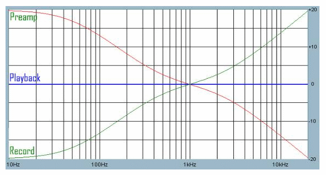

I am waiting for 1% Vishay capacitors to install in the RIAA filter section of the CCT. Are there any matching procedures for the capacitors? I bought 20 of each value. There seems to be more opinion and possibly snake oil regarding capacitor preference. Listening impressions rather than test results.

If you got any trusty, better than 1% LCR bridge you can match them down to 0% between them and against the CCT values, as far as the bridge goes I guess. Can't do anything possibly better. Here's a Riaa curve to know your target if you got any FFT means to check it out later on. Not that's sure its precise on the production of all vinyl out there, but to do our part right.

Our part will be as close as we can get it. I will study and take a stab at the bridge matching of capacitors. The FFT is ready to go.
Perhaps I can breadboard with the capacitors and run the FFT until the two stereo channels match.

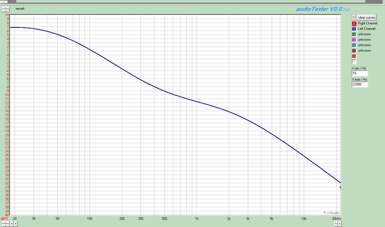

DT you have the right attitude. I built version one with 5% Wima's, I just matched them. Then changed parts out later for better polystyrene and teflon ft-3's. The boutique parts will help voice the system to match better the rest of your stereo.
Matching is important in this excersize and is part of the fun. You can get fantastic results by taking time to do it.
The attached chart is my Simplistic RIAA response curve. Both channels are plotted if you look close. 1V= 0dBS. That doesn't come from randomly pulling parts out of the bin. The rest is musical bliss.
