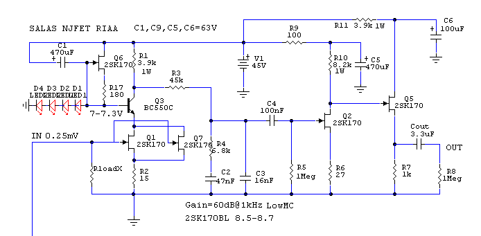

I'm going to follow this schem:

With 15V & 0.02A measure 6.3V it's ok? wich measured voltage I need to look for 7-7.3V?
0.02A (20mA) seems quite a bit too high.
Try 10mA and 5mA and measure the string voltage at these lower currents.
OR
use your chosen jFET+R17 as the CCS and test the string voltage using the actual jFET.
The R17 value of 180r will reduce the k170 current to much below it's Idss.
Using post4728 for circuit details & values.
diyAudio Chief Moderator
Joined 2002
It won't be wise to run that ccs fet at full idss because it sees a high potential across and it will dissipate much. He could use a dropping resistor before it if deleting the idss resistor. Say 3k3 1W between B+ and fet. Leds are at their most quiet from 2-7mA normally.
