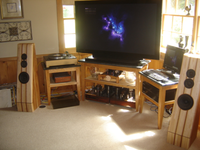

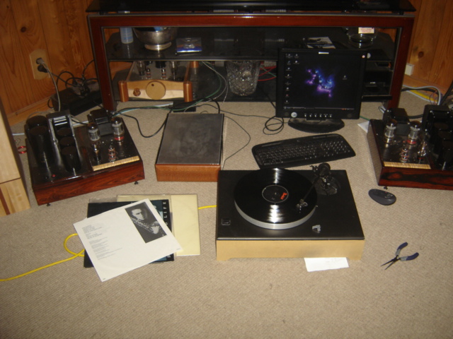

Now that WAF is much improved, see attached before and after, I can continue with the v1.2 build....
Not an optimal set-up yet since my media room is under construction and will be for some time. But is much better than before..
The Salas RIAA fits perfectly under turntable.
So far no issue with feedback. I had my concerns as well, but is a temporary compromise. For serious listening I can pull the speakers away from the stand. The table weighs about 30kg so is itself very stable.
Right now I am glad to have the stuff off the floor and away from underfoot.

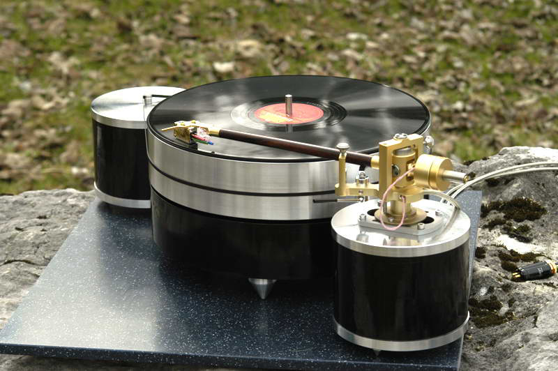

I really like the heavy tables.....
What is the figure on the screen ?
Me too. Here's my VEGA Masterpiece
Looks impressive, the arm is an original Schroeders? wich cart are you using? the base is Silestone or Corian?
Compared your TT vs ours TT, ours TT seems toys!!!!!

A little big the TV🙂
The speakers are Proac future diy clons, wich drives & specs, how sounds?
About tube preamps are also diy, wich tubes, topology are you using?

My wife would be very un happy bringing in the boulder you have your turn table setting on. It would be the ultimate TT stand, however. Nice TT by the way;-)

The speakers are my own design based on my experience with Thiel's back in the days. Drivers are Scan Speak Revelators. I am very happy with the sound. "Quasi" first order crossovers. Very hard on the tweeter. +/- 2db down to about 32hZ. What is interesting and happened quite by accident is that they have a very nice impedance characteristics for tube amps.
The Preamp is a 12b4. CLCLC filter regulated by series 0D3. It is in flux right now. Currently using a ccs load with LED bias. I am very happy with sound of 12b4, however, they tend to be feedback prone and noisy. Currently using GE JANs. I have in the works several experimental boards to optimize the design and operating points including discrete CCS and a Gyrator load.
