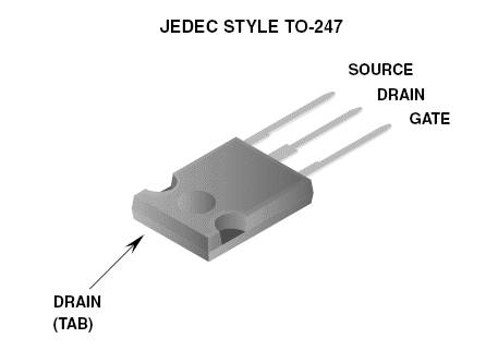

Pleas confirm the following. On the IRF9610 and IRFP9240, the pinout is as follows.
Looking at the device from the front, pins 1, 2, 3 from left to right. Pin 1 = Gate, Pin 2 = Drain, Pin 3 = Source.
Is that correct. I have verified the rest of the BJT's and JFets to be correct.
What I have now is no current passing what so ever. LED is out. Drain on Q1 is at 0V while S is at 60V. Gate is 0.15V. E and B of Q7 are at 60V while C is at 0.15V,
That is way above the max allowable Vgs for Q1 so I will assume it is blown. Q7 is probably also toast as it has a Vce of 45V
Assuming your connections and orientations are OK, some things may have blown in your previous NMos power up. I would change the error amp BJT and 2SK170 first. Mosfets don't blow up in that circuit so easily. But in such a scenario you may have well given it a general haircut. The LED would need some Vin-Vout to come up. Well above 0 Vo. Also did you start your trimmer half way? Are the sense and force all connected across the dummy?
