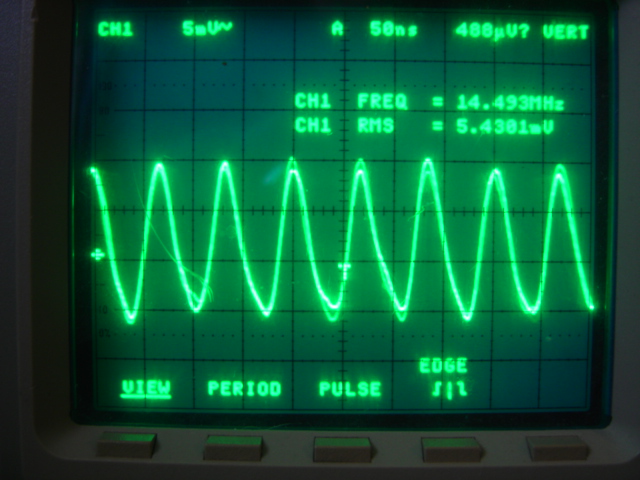

I put .1uF mkp on Vin. Big change but not a solution. Frequency jumped to 14mHz and is a cleaner sawtooth. See before and after in attached.

BTW please take Vpp and Vrms from scope and multiply by 10x. Had the probe in 10x configuration. At 1x I am seeing 80mVrms. 13MHz

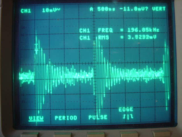

The lytic decouple at the output did reduce what appeared to be higher order harmonics, but did not have the impact the the mkp did on Vin. I will re-install the lytic Vout decoupler and report back.
80mV is too much, its oscillation. Lets see, can we move the compensation from the error amp nearer to the CFP? 9140 has 140pF Crss when 9240 has 81pF. We can be having a resonance there that can be read across the reg. I have done that once when I had to use a more capacitive shunt Mosfet because I was out of 9240.

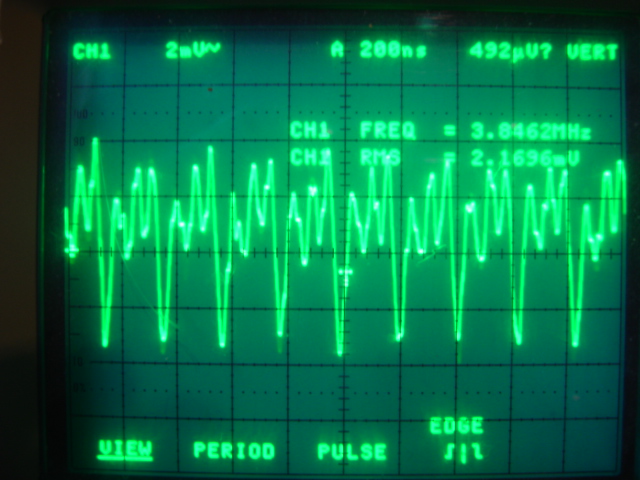

Tried the lytic on the input. Same as the mkp. Rest of circuit as designed except for gate stopper at 60R

With it regulating, I never saw a straight line. I only see the sonar ping with the lytic on the output. Without the lytic on Vout it is a steady state oscillation. I should clarify the cap on Vin makes it SS oscillation closest to sine wave.
