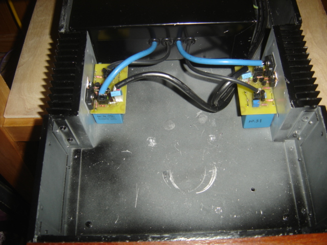

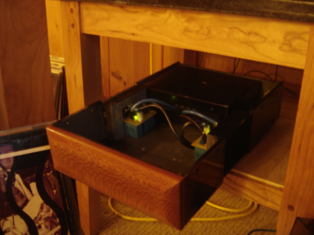

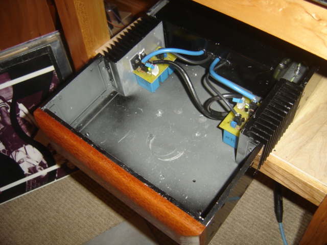

Here are a few quick photos. Not as exciting as it use to be. Still need to put the brick where the old torroid use to be. Otherwise there would be a lot of wasted space. 🙂
Ignore the plywood shelves in the stand. The glass I ordered hasn't arrived yet.
I would put the Rcores and pre filter inside without screwing them in and see if they are acceptable before going de facto two box. But if its a brick in the end, paint it white & blue before you glue it in and stick a Mykonos postcard on it. Its better for the sound.😀

I like them. Very compact and looking like hiding ammunition in the bomb bay underneath.
