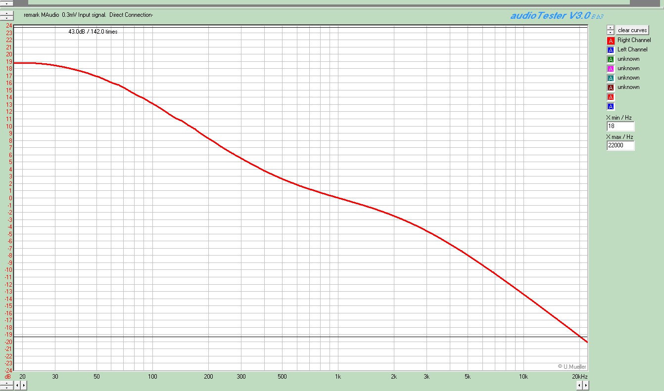

Attached is the RIAA curve. I would like to tone it down abit bit as it is a little bright. The measurement confirms it. I was thinking of dropping R13 to about 250k as it is presently 1M. Is that appropriate?

Textbook is 19.27dB at 20Hz and -19.62dB at 20kHz when 1kHz = 0dB. Make a 0dB 1kHz crossing by adding what is needed for level in the memory bank and confine in 40dB range so to see it in context. No don't change the load, it will swing. Add to the C3 value step by step.

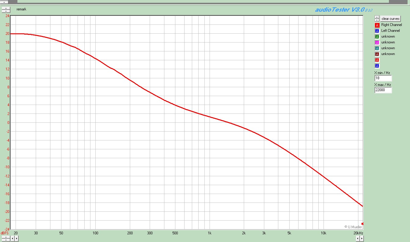

Represented that way it looks close to text book. Found a neat little checkbox that does the 0dB at 1kHz automatically. Nice

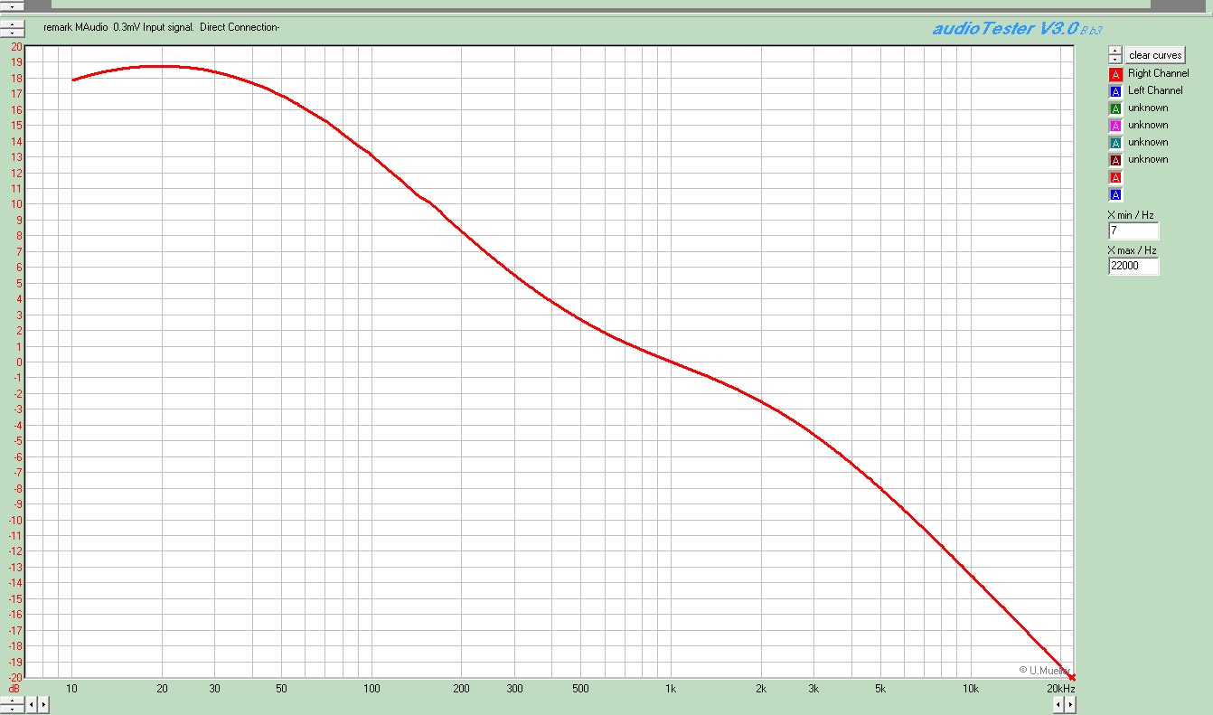

Added an expanded plot showing more of the LF response. THE LF roll off helps it stay short of target.

Its very good. Is there in any way any flattening file that can be just a wee bit off? If not, we are in experimental error territory of the LCR bridge, measurement set up etc. Add 270pF silver mica to your HF Riaa cap. Measure, but where we are now, mainly listen in the context of your speakers and room. If it will go bland, check out 150pF.
The LF will roll off a bit at the low sonic edge because it has to make a high pass for rumble too. Also we don't know how the high source series Z of the divider that feeds current to the shunt 15R copes in combination with the card. Down there its your speaker & room interface that reigns. Modal region. See to bring it mainly subjectively where you like to the right of 1kHz. Left hand has the proper shape. 20Hz will not do something real.

Yep. Add 270pF, measure and listen, and let us know. Just use Mica. Mine hits the 19.27 at 20Hz. But it may be the capacitor tolerances and our LCR. It will have bass if it does not have a bit more presence than absolutely correct in the mid highs. Its a psychoacoustic scales. You probably need to save off a wee bit towards last octave. Tune it out without changing the main caps. Also you use styroflex, some find it a bit glassy beyond very clear.

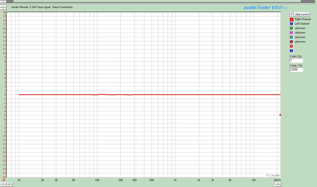

P.S. attached is a direct feed through with load of divider

The load of divider on card's input? If yes, its high Z easy. The phono is 150R.
Looping the card, right? So the 15R is fed current by the series (over 1k?) and drives how high Z an input? Anyway, lets forget the measurement system. Its fine touch tuning time. Its high time now you got your final regs on. Trust your tone at heart.
