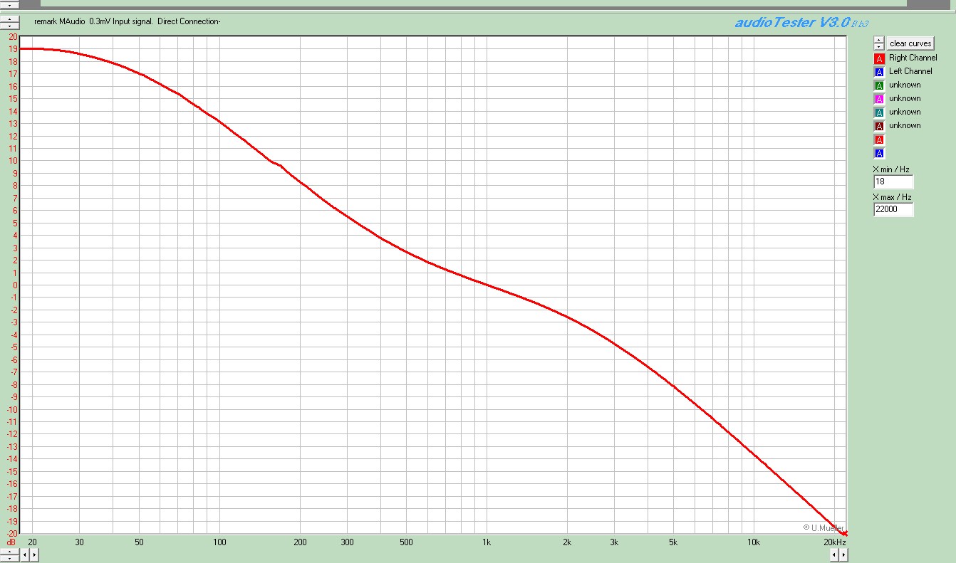

Had a little time to play. Started off the evening listening to it as I had left it last night. My opinion was still the same so I deceided to add the 250pF cap accross C3. The first measurement shows represents what the impact was. I could not really see a change, but I listened to it. I noted a small reduction in the extreme high end, it was a little better. I gave it a couple of sides of albums and decided to kick it up another notch. THis time I replaced the 15nF polystyrene cap with a 15.1nF poystyrene cap. so basically in total I have added 350pF or so to C3. The measurment is the second plot. Again not a huge change in the measurement. I have been listening to it ever since. At this point I don't want to change it again for another couple of days as the cap breaks in. Went back over some of the same albums and my initial perception is that the mids are more pronounced. Still great detail and stage.
In a nutshell, I can't measure the change, but it has changed perceptively. It will be interesting to see if my impression stays the same tomorrow. I wonder how much is me wanting a change.

I saved them ib bmp format. Here is the last in jpg format.

In simulation it would give a 0.1-0.2dB overall trend above 1kHz. There it shows. With pink noise and cards its difficult. I see easier such differences if I watch with 1/96 oct. but there will be no lows to see, they shrink bandwidth with such an octave resolution. Now its subjectively tamer maybe you can feel the lower notes progressing better.
P.S. Textbook Riaa at 50Hz=16.95dB, 40Hz=17.79dB, 30Hz=18.59dB, 20Hz=-19.27dB, 5kHz=-8.21dB, 10kHz=-13.73dB, 20kHz=-19.63dB. I.e. your graph looks good I think.

Audio Tester uses a sweep not pink noise. But you are correct it is hard to see.

Sinusoidal sweep can be better. Depends on how it connects the gaps. But your sweep looks great VS theory.
Using your comment above, and measureing on the plot on the pc using the cursor bar, this thing is spot on to the RIAA standard now. At least within +/- 0.05dB as the cursor is limited to 0.1 dB.
