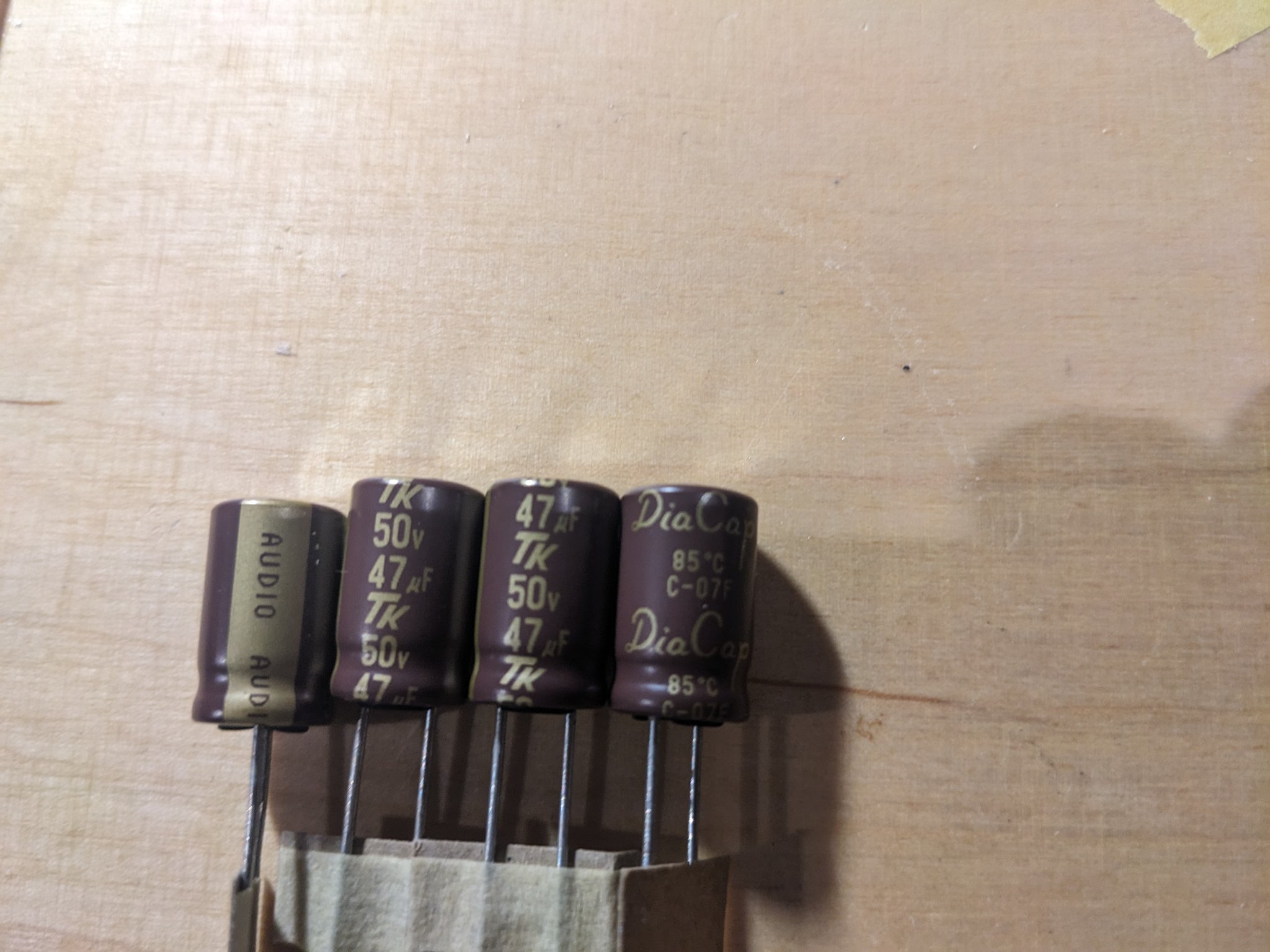

Today I bought Toshin UTJH audio grade expensive caps at local shop.
The leg is not magnetic.
100uf50v was too expensive (3.5usd)
So I bought 47uf50v(2usd)
Just for fun.
Before I tried 100uf16v on dac but I choose nichicon KZ.
Panasonic FC 100r is good, detailed sound.
Nichicon KZ 100r have more bass but sound overflowing and losing detail.
This time for Njfet RIAA,Toshin UTJH won.
It had detail and more colour in good way.
I want to try audio note kaisei cap if I have chance to buy.
I also have good results for adding 10R on regulator R1 5.6R.

Hi tamra
thank you for the interesting experiment.
It seems you are able to easily swap the caps - do you use sockets?
Which caps did you swap (C5 - C9?)?
