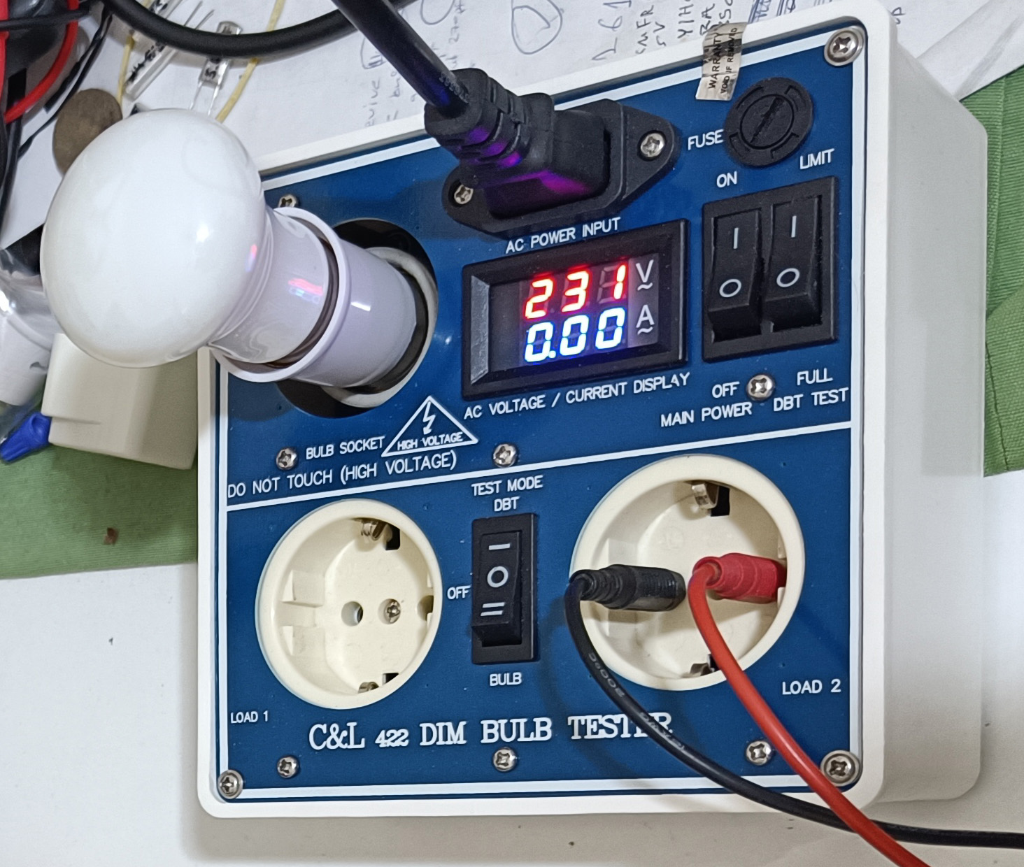

The DBT will drop some AC mains Voltage but a correctly working UFSP doesn't pull too much power. Not eating all its raw DC headroom due to moderate AC drop. The TP setting is on a regulated rail. Should be alright with a 60W EU-100W USA incandescent bulb. Just recheck TP when off the DBT for peace of mind.
Power amplifiers running on unregulated rails is indeed a waste of time to bias when still on the DBT.
I once found a nice ready made DBT that I grabbed but didn't see it offered again. I also found few incandescent bulbs in local old electrician stores. Up to 200W. In most test applications a 60W is good at 230V. I once surely needed a 300W for a big tube amp though but I am still looking for one. Since it has two outputs I stick a meter in the unused one to monitor the final AC voltage after the current limiting drop and I switch bulb to bigger if necessary. Glow intensity is the instant hint but when also having a reading it is even better.
