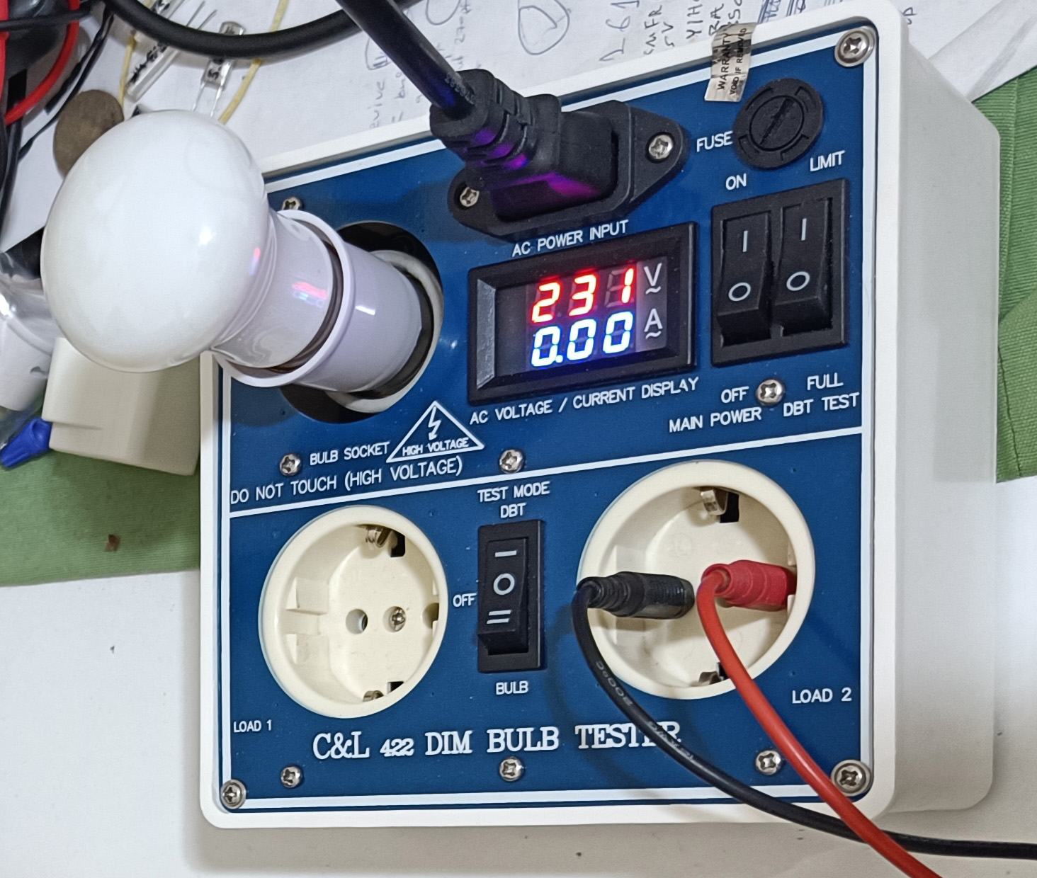

I once found a nice ready made DBT that I grabbed but didn't see it offered again. I also found few incandescent bulbs in local old electrician stores. Up to 200W. In most test applications a 60W is good at 230V. I once surely needed a 300W for a big tube amp though but I am still looking for one. Since it has two outputs I stick a meter in the unused one to monitor the final AC voltage after the current limiting drop and I switch bulb to bigger if necessary. Glow intensity is the instant hint but when also having a reading it is even better.
Nice! I have an e27 socket on a plank 🙂
Dual button On/off thru bulb and bypass bulb. I also added banana females in series later to plug an amp meter to.
I mostly use it for quick testing of unknown trannys and faulty duts. Quick tell if smoothing cap has a short or so.
Yea, inrush current from big donuts can kill bulbs.
Cold bulbs has quite an inrush themselves, abt 15 times steady state. Wakes up sleeping electrons 🙂

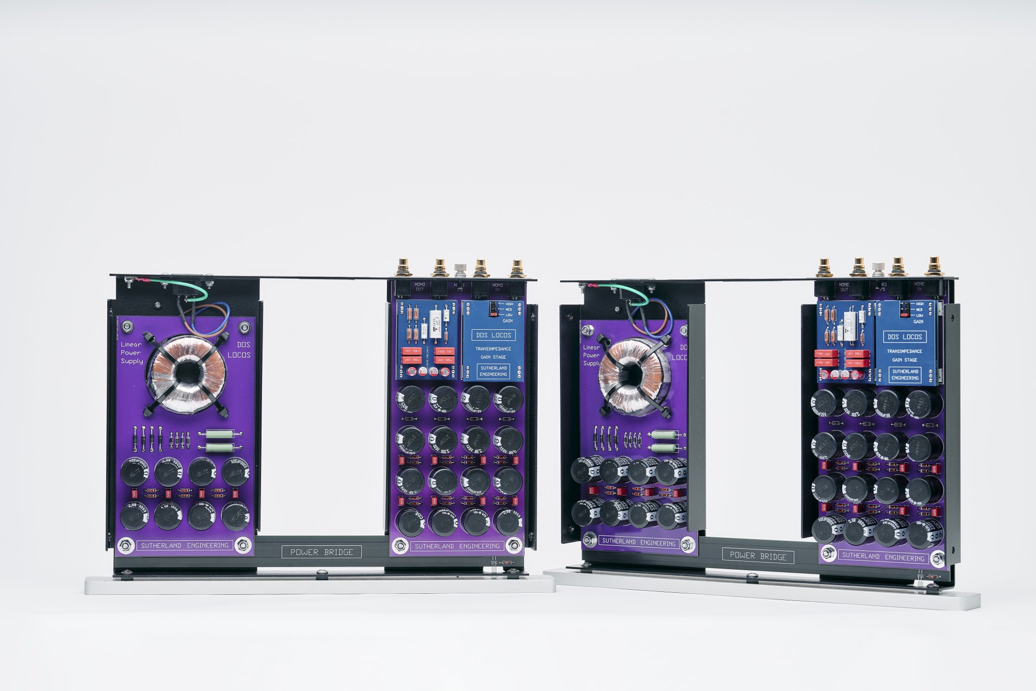

My plan is to make PSU and UFSP in the same enclosure, something like this below.
and cover with the 3D-printed enclosure.
UFSP has strong on board shielding that can be friendlier to non all ferrometal boxing.
