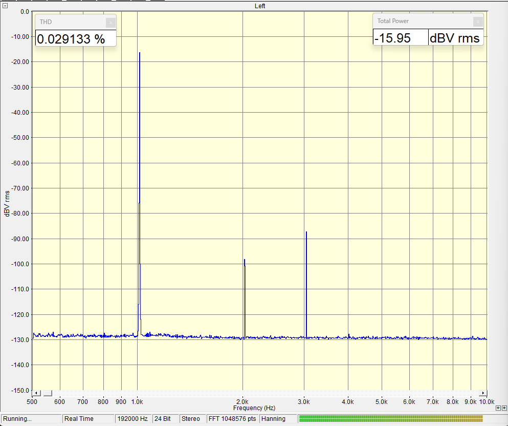

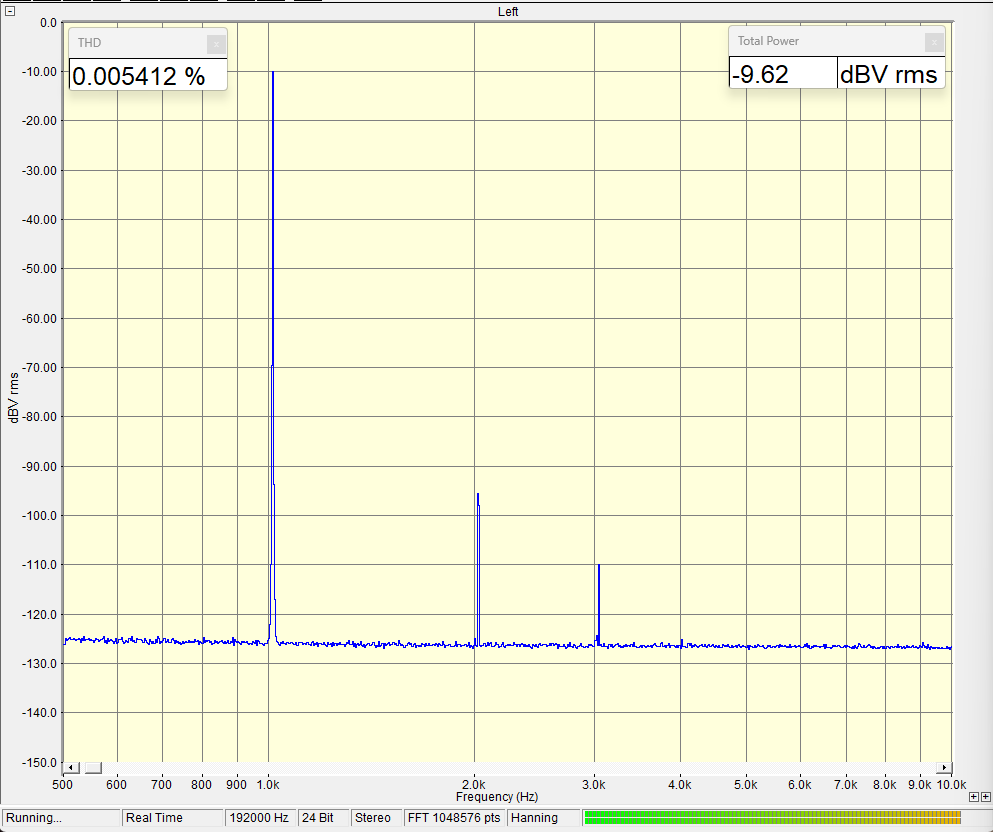

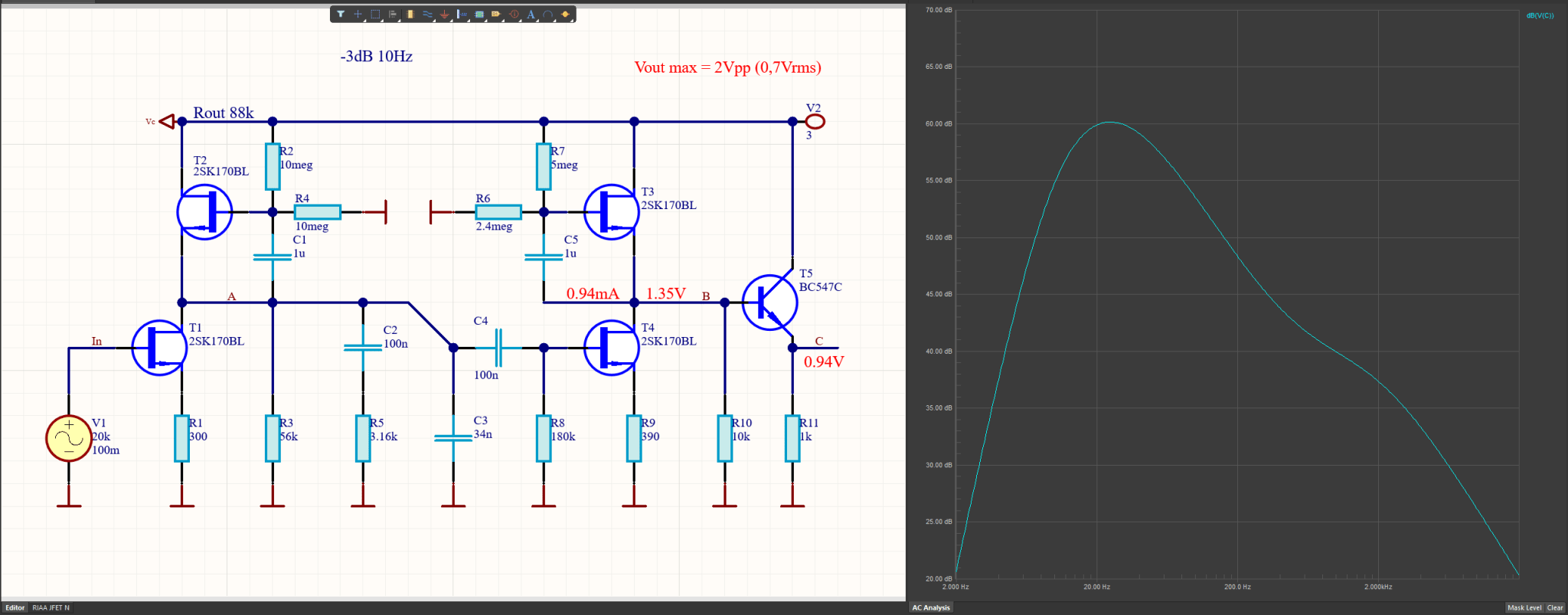

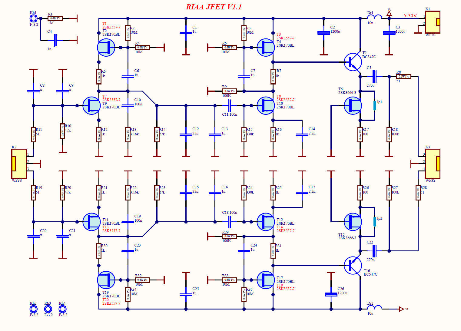

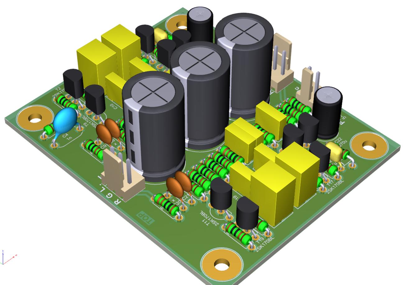

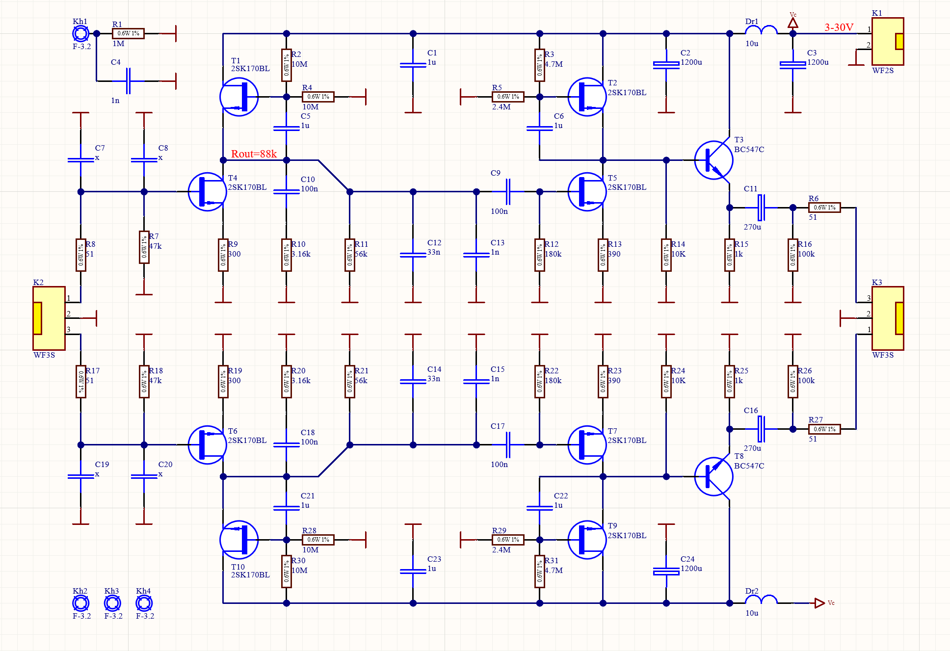

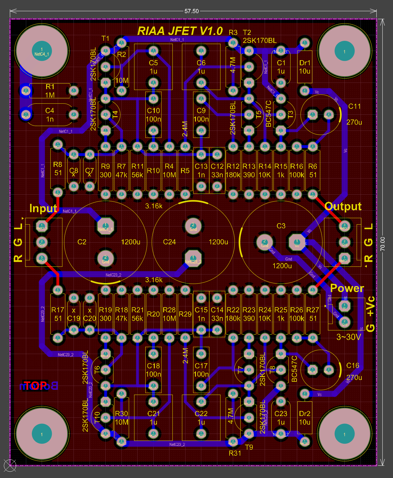

The scheme has undergone cosmetic changes to improve the parameters.
The advantage of this circuit is that it can work at different supply voltages 5V-30V

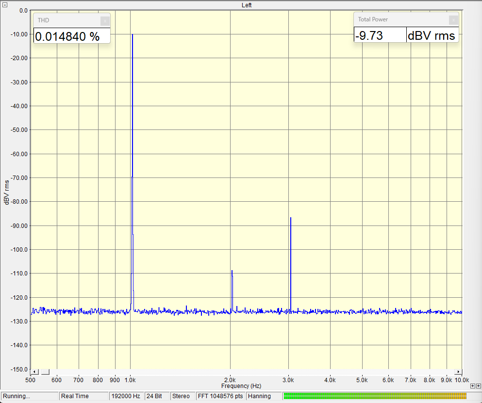

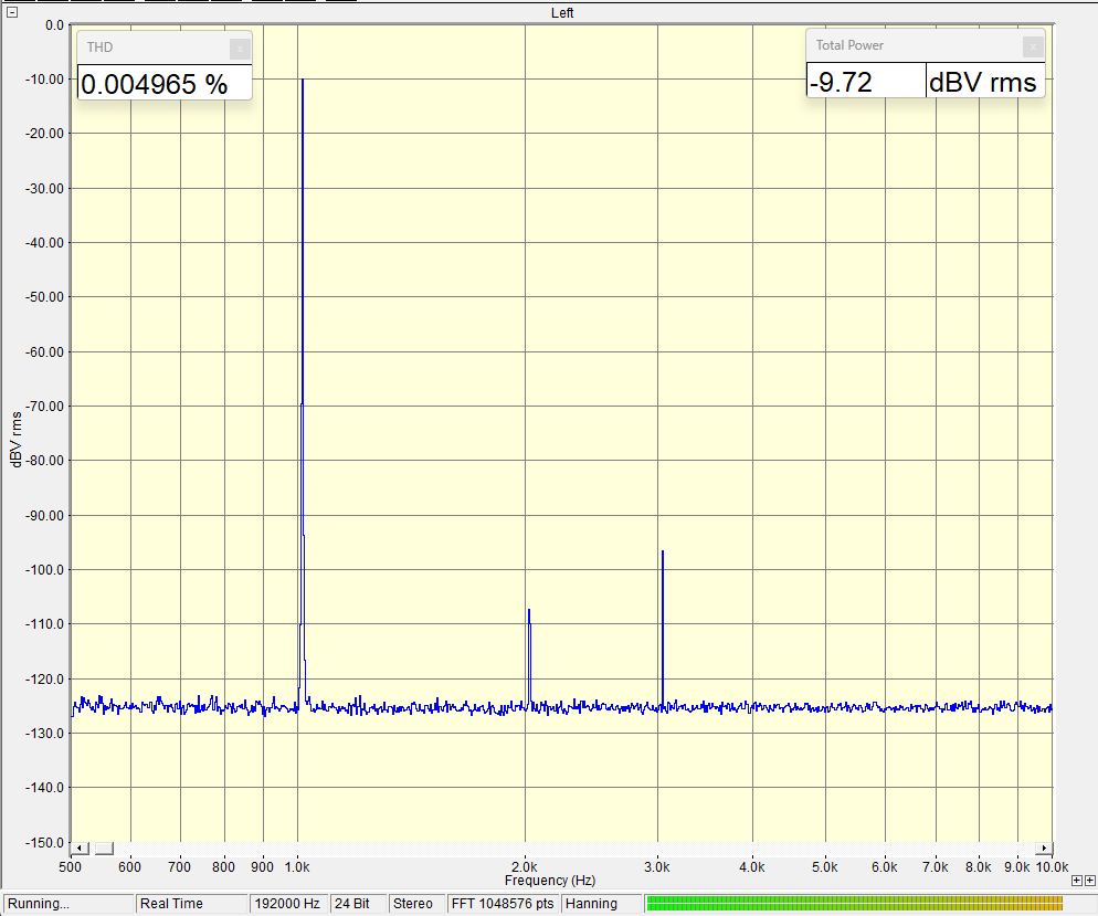

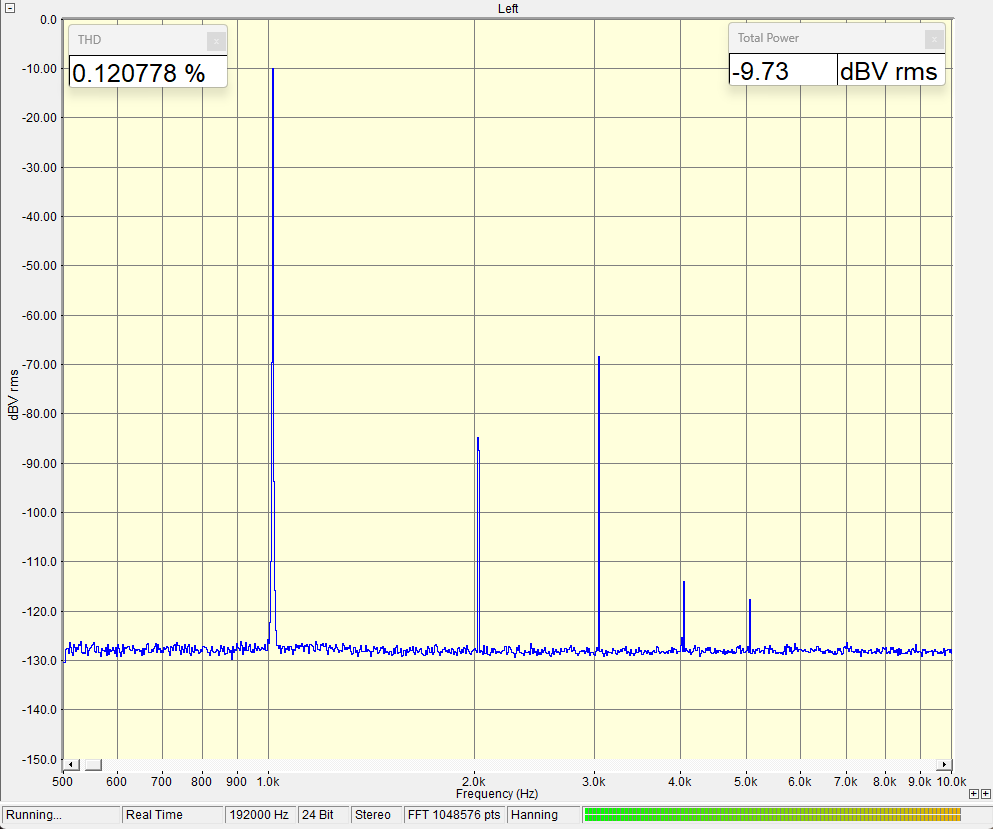

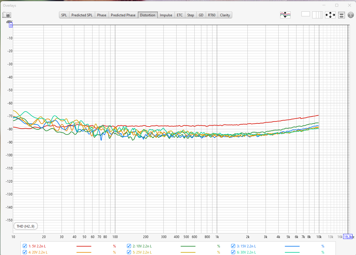

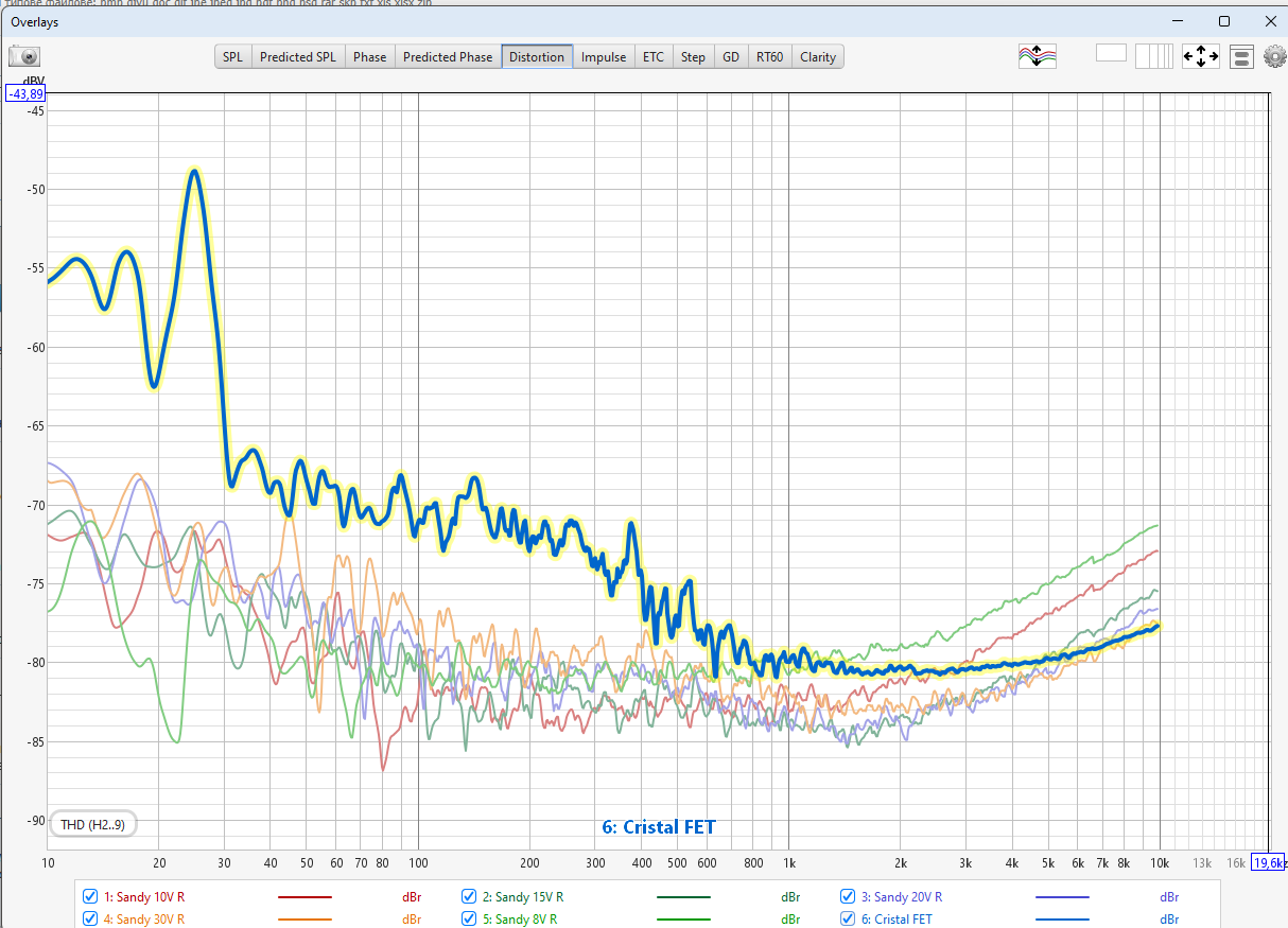

THD graphs are at different supply voltages 5V, 10V, 15V, 20V, 25V, 30V

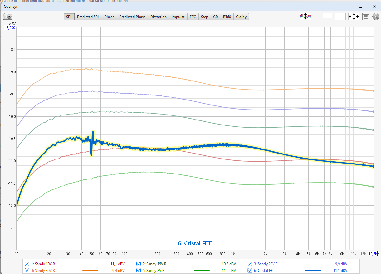

The frequency response was also measured at different supply voltages, with RIAA compensation.
For comparison, graph 6 is of the Cristl FET from the forum.

oh soundcard I see. be aware sometimes these measurements are not accurate, but using REW and Cosmo or other card and calibrate it against calibrated analyzers will offer reliable results. I was wondering what the noise density for this phono is. what is the distortion at 500uV input ref? What is the headroom offered? Any data?
These are the distortions at 0.5Vrms and different supply voltages
And RIAA gain is 100 (40dB) for 1KHz.
