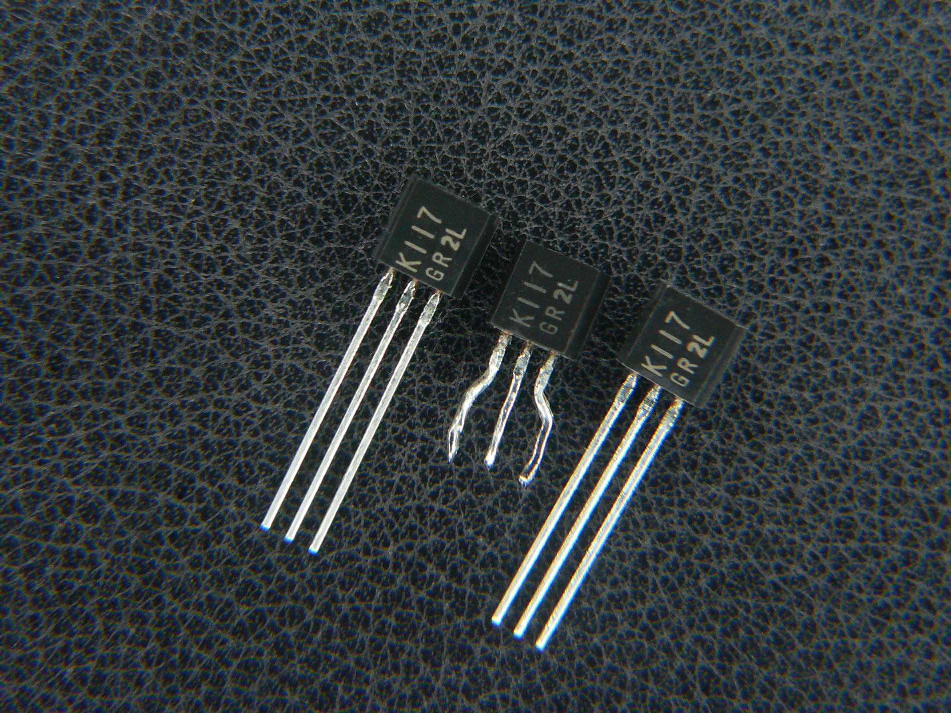

Post a close up picture of your new K117 before installing it. We usually can tell a genuine by print, shape, legs.

FETs arrived today.
If they are fakes, it's a good copy.
The middle one is from the latest fireworks on HV supply. Marking color is darker yellow/brown, maybe due to heat or dirty fingers.
New ones looks to be laser etched. For the legs I cannot say.
Laurent

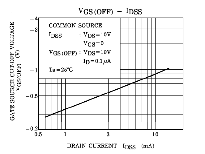

Look at this chart I clipped from the K117 datasheet
Yes, "the higher IDSS --> the lower VGS(OFF)".
And this also : "the higher GM --> the higher IDSS"
So am I wrong if for a given current the polarization resistor is better bigger than too small as a first approach, maybe with the bandwidth limit due to the gate capacity ?
Anyway, I just need to revert to a GR FET and all should be OK. I don't want to rework too much a stable design and finish with an oscillation prone PSU.
Thank you for your great work and help Salas.
Laurent
The higher the IDSS in a certain type's range the higher its VGS(OFF) as an absolute number. Think in terms of power tubes. When you got a tube that produces more mA at a certain voltage bias than its next same tube, don't you need more negative grid voltage to completely shut it off than its neighbor? That's higher VGS(OFF).
VGS(OFF) as an absolute number....That's higher VGS(OFF).
OK, got your point.That was a question of convention. When talking about lower VGS(OFF), I was thinking more negative, not absolute value.
