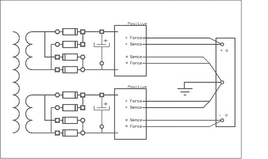

I need +/-300vdc and will use the attached setup as below.
The only transformer I have has one secondary winding of 646Vac with a center tap (@ 323Vac). Can I use my transformer or do I need two separate secondary winding's (of 323Vac) as per the attached cct diagram?

Possibly in p2p for one, not on the positive board, but I haven't looked into it because I prefer this scheme, which is anti ground loop also:
Your diagram shows a dual secondary.
If you want to use two positive regulators you need dual rectifiers and dual secondaries.
you cannot use a centre tapped secondary where a dual secondary feeds into dual rectifiers.The only transformer I have has one secondary winding of 646Vac with a center tap (@ 323Vac)

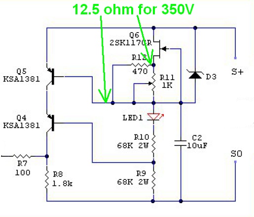

I'm running two SSHV2 regulators for 350V DC and 17+20mA overhead per one channel. Hovewer I've noticed that R11 multiturn resistor is very sensitive in the output voltage settings. Looking in the schematics it is in parrarell with R12 (470 ohm) resistor. Maybe I should replace R12 resistor with different one to have more precise tuning?

You could drop 90% of your voltage over the fixed low tempco resistor.
The other 10% could be across the variable resistor. Double the value that gives the 10%. To allow the VR to move around thw half value setting.
eg. you have 350Vref
320Vdrop across 100k gives a current of 3.2mA and a Pdiss of ~1W (use >3W)
The 3.2mA and 20% of 350V gives you the required variable resistance of 70V/0.0032A = 22k, use a 20k VR.
A 20k VR of 500mW max Pdiss has a maximum current of only 5mA.
For this I would increase the 100k to drop nearer 95% and drop the VR to 10k.
Consider what current passes down the Vref string. How much can it be varied?

I've measured resistance over parallel connected R11 and 12 (as in the schematisc) and is about 12,5ohm.
Let me "translate" Andrew. The output voltage is defined by the current from the current source Q6R11R12 (which can be changed by R11||R12) and the R9+R10 (through which the current flows and the resulting voltage drop almost = the output voltage). You measured the R11||R12 rather low, it means that you are approaching the high current margin of the current source. You can lower the values of both R12 and R11 certainly, but it will help only partially. So it is better to increase the values of R9 and R10 and stay near the "designed" current - in such case you'll have smooth changing and less heating of Q6.

Do you think that 82k/2W (R9,10) will be OK for more precise 350V setting?... So it is better to increase the values of R9 and R10 and stay near the "designed" current - in such case you'll have smooth changing and less heating of Q6.
