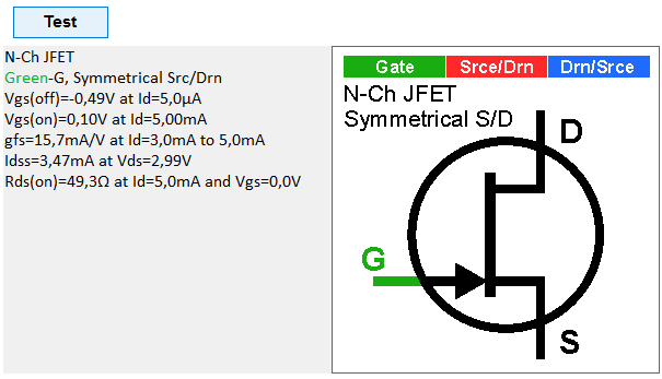

Waiting for ordered 75K for R9, 10 I'm considering replacing JFET in my two SSHV2. I've measured JFET' IDSS my spare 2SK117s and the strongest I have got are: 4.9 and 4.1mA.
Do you think I could have better Vout regulation around 350V if I replaced JFETs also? Currently I have soldered JFETs with IDSS 3.4 ~3.5mA

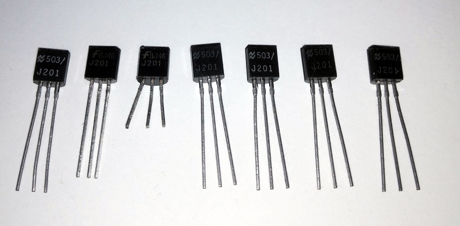

Laurent those figures you saw in the datasheet but maybe I still got some J201 samples somewhere let me dig them up and I will measure them for you. Vref resistors value easy to change when its good to use the lowest Vgs (off) J type.

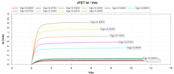

He, he, I dug few up. J201 is a stable guy indeed but below 1.5V it loses uA fast when pressed between fingers while even a 4mA K117GR can be steady at 0.6V VDS in that rough test. Because J201 can have around -0.9V pinch off even at 0.75mA idss when the 4mA GR had -0.5V only. J201 Fairchild and NOS National random samples were well consistent for idss. 2SK117GR lowest possible idss samples and used as near to 0 Vgs remains the best choice in this situation. 😉

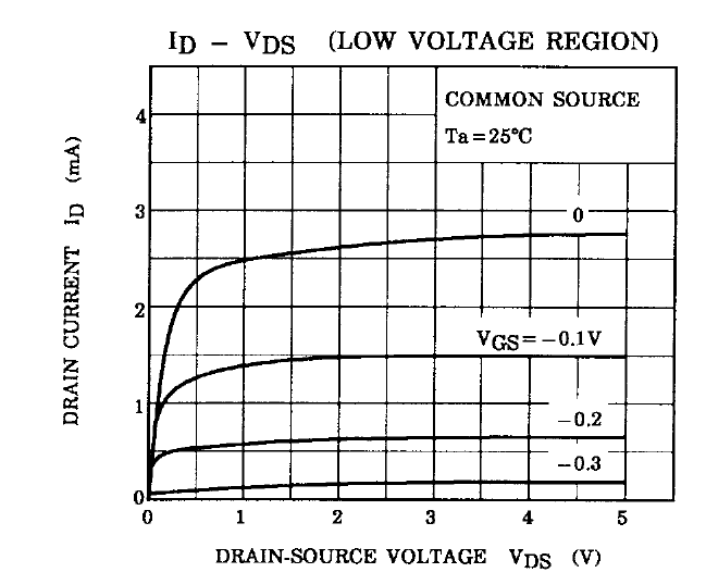

Nice curves, very linear in positive VGS.
As a general figure, pinch off occurs at a smaller VDS with K117, so right, better stick with K117.
OK, having VGS near 0 leaves the voltage drop almost totally for VDS, allowing to be as close as possible to the saturation area. I have one GR sample at 2.7mA IDSS, I'll give it a try at 1.8mA which is my current setting. I also ordered Y version to see if it's getting better with even a closer IDSS to my target. All that looking for the zero tempco of course.

Vgs is really a negative number in NJFET polarity. Its this tracer working with positive Vgs number figures in Id/Vgs. Although it knows to put a minus in the test page and in the Id/Vgs tracing page. We can mentally adjust maybe but they could fix it in the software. If asking it to start from a minus it only traces zero. So it must be the hardware doing one way bias. I will contact them to know if they can use another display way.
Y grade is a good test idea when you can can find originals of them.

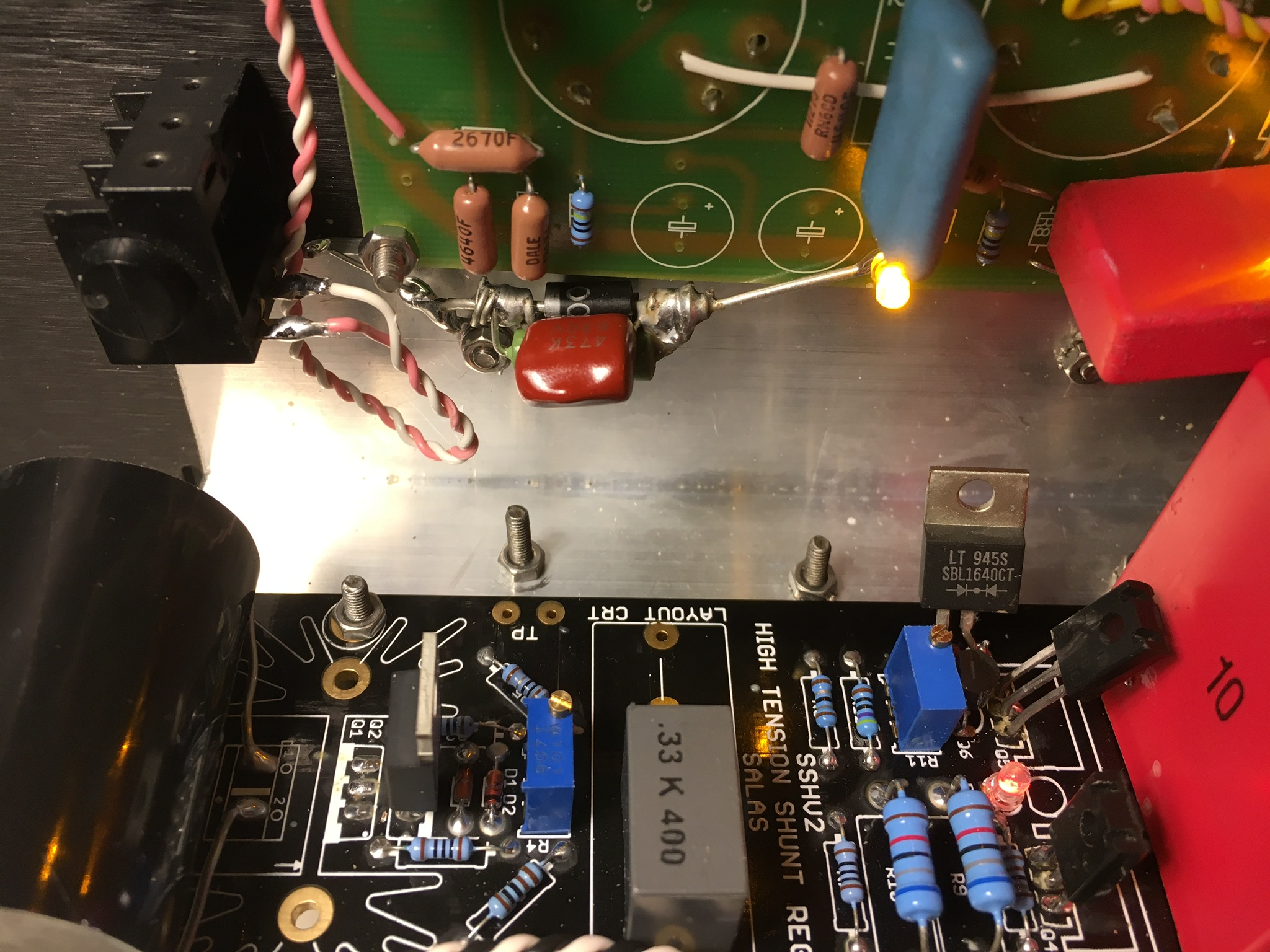

Hi all,
I have built 2 pieces of SSHV2 supplying a (relatively) lowish voltage (175V output) for a balanced Aikido noval. Worked like a charm from the start, both, so praises should go to Salas, the builders and contributors. I only use a tube rectifier with 10H choke and 2x15uF MKP caps at the input.
During the setup of the stage I connected a discharged 10uF cap across the live load and that killed the SSHV... well, a bit of a surprise, as according to my knowledge a shunt regulator is inherently protected at short circuits. I took me like 20 minutes to debug the issues in the circuit, and Q5 and Q6 were fried (shorted). Much more time to replace them, as the PCB is double sided...
Later, during fine tuning of the supply voltage, i did it again 🙁 I shorted the supply lines with one of the DMM probes. Same culprits, the JFET and the top bipolar from the shunt, and additionally the protection Zener (D3) was as well destroyed. All fixed now, but the PCB was a bit damaged (collector pad of Q5 from the top does not exist anymore which required a separate strap to connect it with emitter of Q4)
I wonder if anybody else have had similar experiences when shorting the output? Also, what could likely be the cause of damaging (systematically) of the Q5 and Q6 when output goes to 0? It seems that E-B junction of Q5 goes shorted (few ohms measured both directions) but as well it shorts the gate junction of 2SK117.
I assume it's the C2 (charged at almost the output voltage) that reverse biases Q5(B-E) and Q6 when Output goes to 0, while D3 is too slow to protect.
In this case maybe an ultra fast diode in parallel with the Zener do you think it would help? I think the Zener is protected by the B-E junction of Q5 ( 😀 ), but I guess the role of Zener is to prevent something more catastrophic.
I know, I have to be more careful (and I will be) but I am very curious to hear some feedback from Salas or others that have been through similar experiences.
Cheers!
Its not that the CCS does not limit the incoming current, its the C2 charge that does the little semis killing job when you short as you described. The Zener was put there for start up time protection of Q6 supposedly, but it surely can't protect the small semis in output shorts. That is why there is no instruction in the guide that you may short the output without some damage. With a 1N4148 in its place there is no change for normal operation so you may try it.
Thanks Salas! I guess, though, that 1N4148 is somewhat tiny for that job. This device should offer a safe path to discharge C2 in case of a short. I will try to bypass the Zener with a bigger Schottky and report back!
Sent from my iPhone using Tapatalk
Ok, problem solved [emoji16] . I have soldered half of SBL1640 on top of the Zener (this is what I had on hand) and the regulator survived successfully several short circuits.
I have added 2 pictures to show more exactly what I have done.
