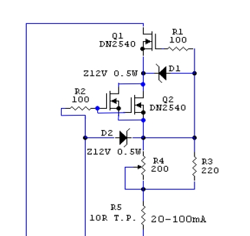

Poty, thanks for the idea. So I have put together 2 pieces of DN2540 as shown?
Salas,
I rebuilt a blown supply and have a problem. I feed it 240v DC with a target of 180v DC. My target current is 50ma. I can adjust the current fine with R4. However I cannot get above 140v DC using R11, with the current at 50ma. I can get higher DC voltage if I adjust R4 to get 60ma. The output voltage does change with R4 adjustment. I did have to replace the LED. I suspect that the replacement is the issue. I think it is a 20ma LED. Would the wrong LED cause this problem.

Salas,
In message 4493 you say that Q4 should measure in the kilo Ohm range. When I test it from E to B, it is always in the mega ohm range. Am I testing it correctly? To my untrained eye, looking at the schematic the mega ohm range should be correct.
I do get the expected reading for Q5.
I need around 80 to 90ma, I believe that this is within the operating range for the PS.
I am having trouble getting the IRF840. Does the Gate Charge (Vgs) matter?
Thanks John
