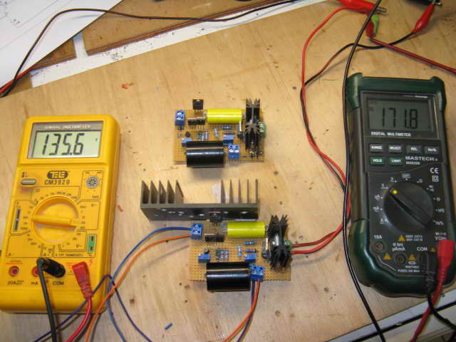

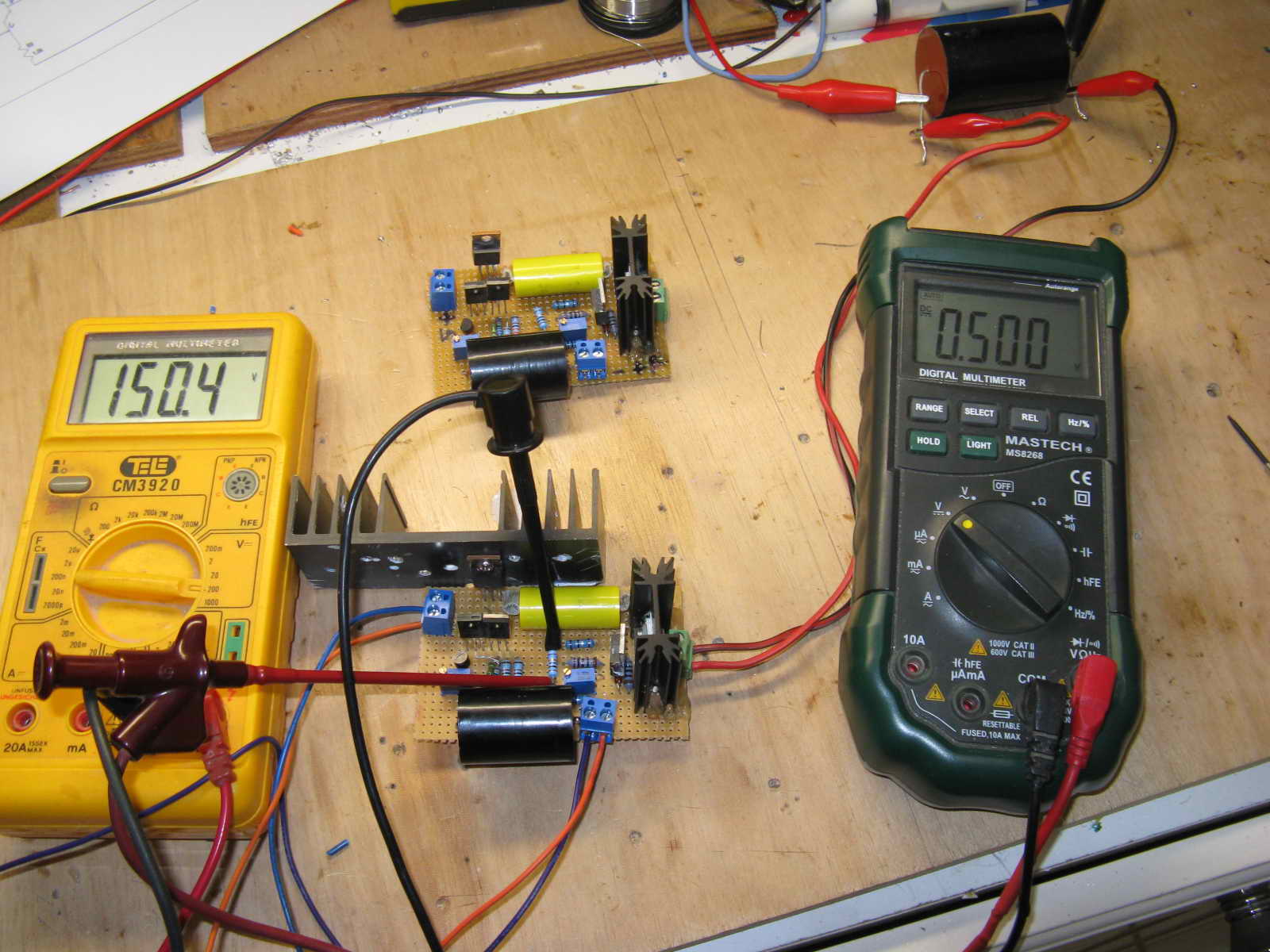

Today I decided to finish my second SSHV2 for the pre I am building.
Both shunts on the test bed working nicely, and voltage is very stable.
Just be careful if you use long cables without any decoupling. I managed to get it into oscillation with very long test cables. A cap near the input and everything is fine. Nothing burned this time, but future builders do not take the risk.

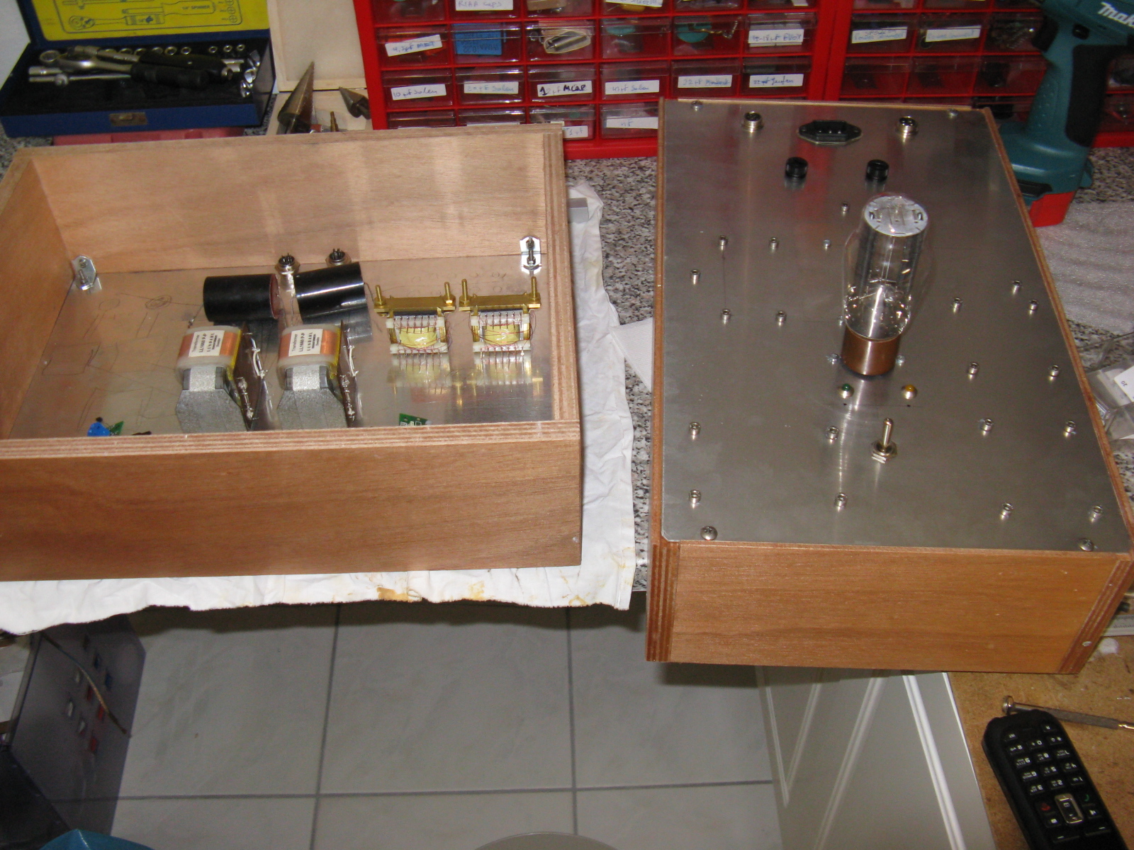

Just curiosity, wich pre are you building?
Please when you can post pics in the #26 thread. I'm very interested, still pending to buy the boxes so if I see your #26 I will have an idea. Nick sorry for OT.
Thanks for the pics, congratulations looks very good. Where are the mains transformers & B+ chokes, inside the box where is the tube rectifier? I use also the same AVC volume control & output tx, did you bought to Thomas as me?
Power transformer 2x220V, 5R4GY rectifier, choke input ll1673, ll1660PP for output transformer and AVC from Intact audio.
Also got some nice BIG 10ohm 100W Dale resistor for filament bias.
