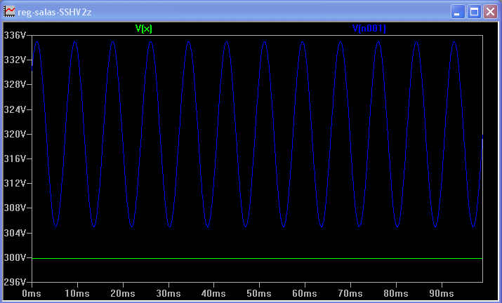

As for 120Hz ripple don't expect it to really pass, its more a matter of general grounding quality and absence of hum fields. See a Spice attachment for 30VP-P 120Hz ripple (blue) and output (green). From experience, the rectification's HF harmonics penetrate much easier like X rays any practical build through numerous parasitic paths. I don't think that any CCS is better firewall than a ballast resistor regarding such gremlins. That is why a basic CLC and not more than 200mV RMS AC riding Vin on the scope is a good rule of thumb. This CCS is cascode with smallest stable gate stoppers so to hold high well, but it won't surprise me if the rectification and filtering quality is possible to could be picked up still as a deeper black background or enhanced HF flow. Has a lot to do with the audio application's PSRR too. The output impedance of the pre-filter should not matter.

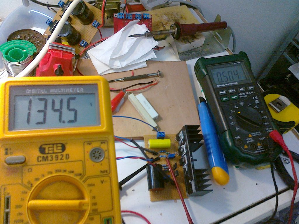

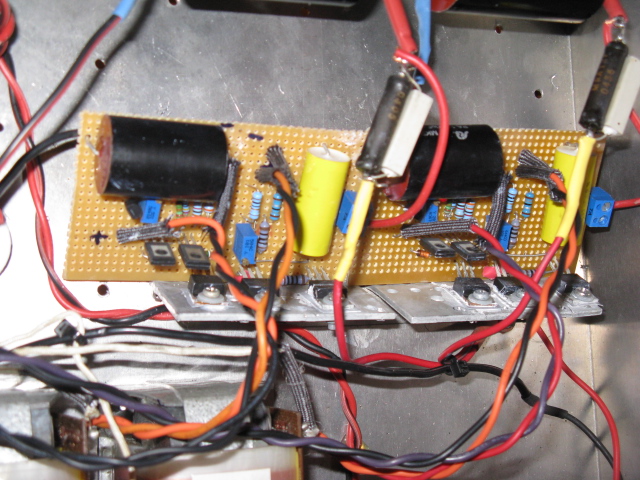

Very helpful PCB. I'm thinking to move Q1 at the same side of IRF840 to use a heatsink for both
Heatsink for Q2 ? Ithink no
Not necessary, if you look at my last layout previous on this thread.
Thanks. And a last question (I hope). For C2 10uF is the optomum, 15uF the up limit, The down limit?
Then 10uF electrolytic plus // 1uF MKT, because I can't find MKT or MKP and I don't like to buy from ebay

Try MKS. It usually has a higher esr and that combined with a "normal" electrolytic (not low esr) may just be enough to damp oscillation.
Maybe the electrolytic on it's own might work well enough.
Looking at Erse, SCR and Solen caps, for a good fit.
Of course box caps lend themselves to the board layout mentioned, but seem harder to find in that value and voltage.
