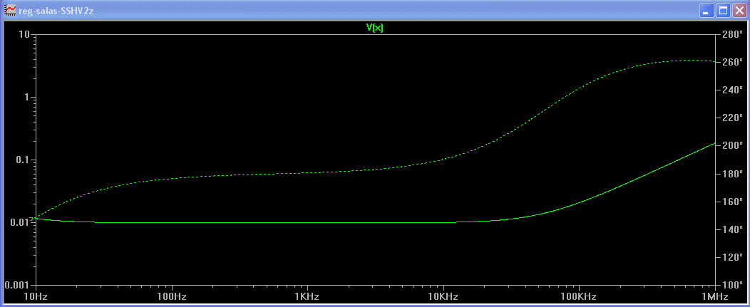

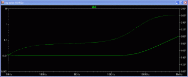

Power Supply Testing, Model and Physical
Hi Salas,
What would be the correct way to load and test the supply? Is a linear resistor really representative of the slightly more complex dynamic load of the tube (Or whatever load) being driven
If LT Spice was used, what would be done there to check the supply output impedance vs frequency?
Thanks!
Gary

Has much to do with the PSRR of the units powered. In typical non CCS loaded tube line stages maybe 5% - 10% better.

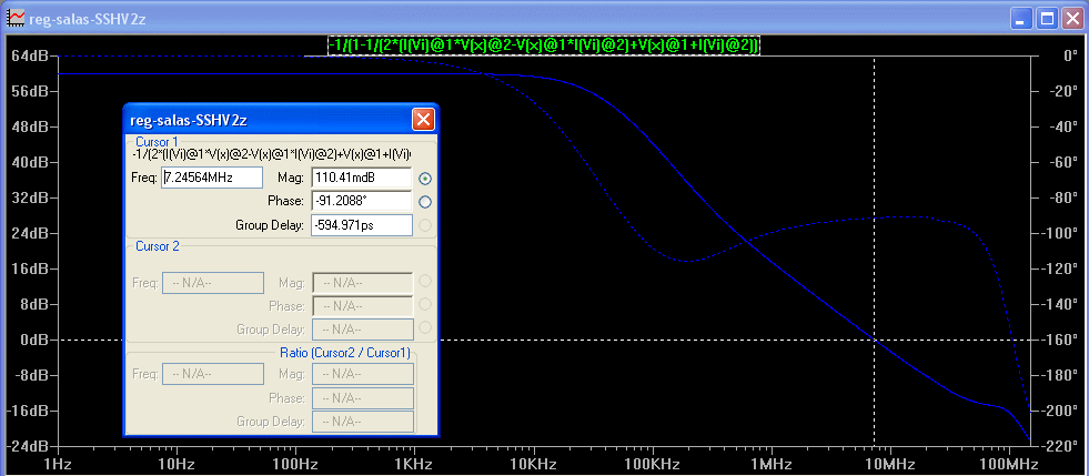

After its set with sources, you assign 1 as AC amplitude to the voltage sine source and also to I source load, you turn on the parametric probe and and you probe ''out'' point in logarithmic by clicking to the chart's left and choosing. Or in linear and Ohm if you assign out/1A function. For OLG I use the Tian method of internal loop breaking. There is an LTSPICE thread in diyA, there you can ask more.

Okay, so instead of a resistive load you use a current source. Which is really a "sink" depending on which way it's oriented...?
I'll check out the LTSPice thread.
What is OLG?
Gary
Open Loop Gain. The chart I posted last. Shows phase margin at zero gain frequency and gain bandwidth before feedback.
