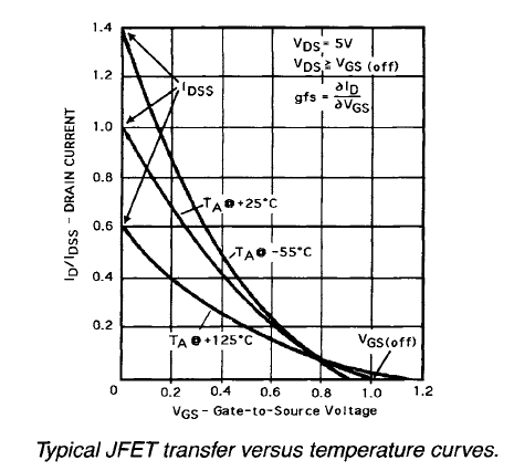

Regarding the temperature drift. Think about how much current goes through the voltage reference made of a current source (jfet) and a resistor. If the current source is set for low current, a temperature variation will be translated into a higher voltage variation because the resistor has a high value. Higher current will force you to use a smaller resistor in the voltage reference, and Vout will not vary as much with temperature. But then you need to deal with the higher dissipation. I don't see why 2sk117 and 2sk170 would be inherently different when it comes to tempco. Both will have a sweet spot in terms of tempco, and it will not be at Idss. Have a look in the attached image at how the current changes in a jfet as a function of temperature. Pretty obvious which operating point is the best.
Edit: I forgot to mention. In this position, one of the most important specs for the jfet is Vgs(OFF). Both the 2sk117 and the 2sk170 have a Vgs(OFF) of between -0.2V and -1.5V. There are not many jfets that have such small Vgs(OFF). J201 is another, but its Idss is much smaller at between 0.2mA and 1mA.
For Q2 Supertex N3 TO-92 package, could be useful for space saving, haven't tried it though. BF245A,B,C too much pinch off to work under just Vbe correctly. Maybe some low side IDSS samples of A grade but you got to measure they are under 0.6V. Don't know why K117GR was more stable than K170BL, maybe has different Gos or its zero tempco curves crossing point is different (no such charts from Toshiba), but it is surely steadier in test with alike currents and trimmer. It also goes negative drifting like BF245. K170 gains. In GR too.
