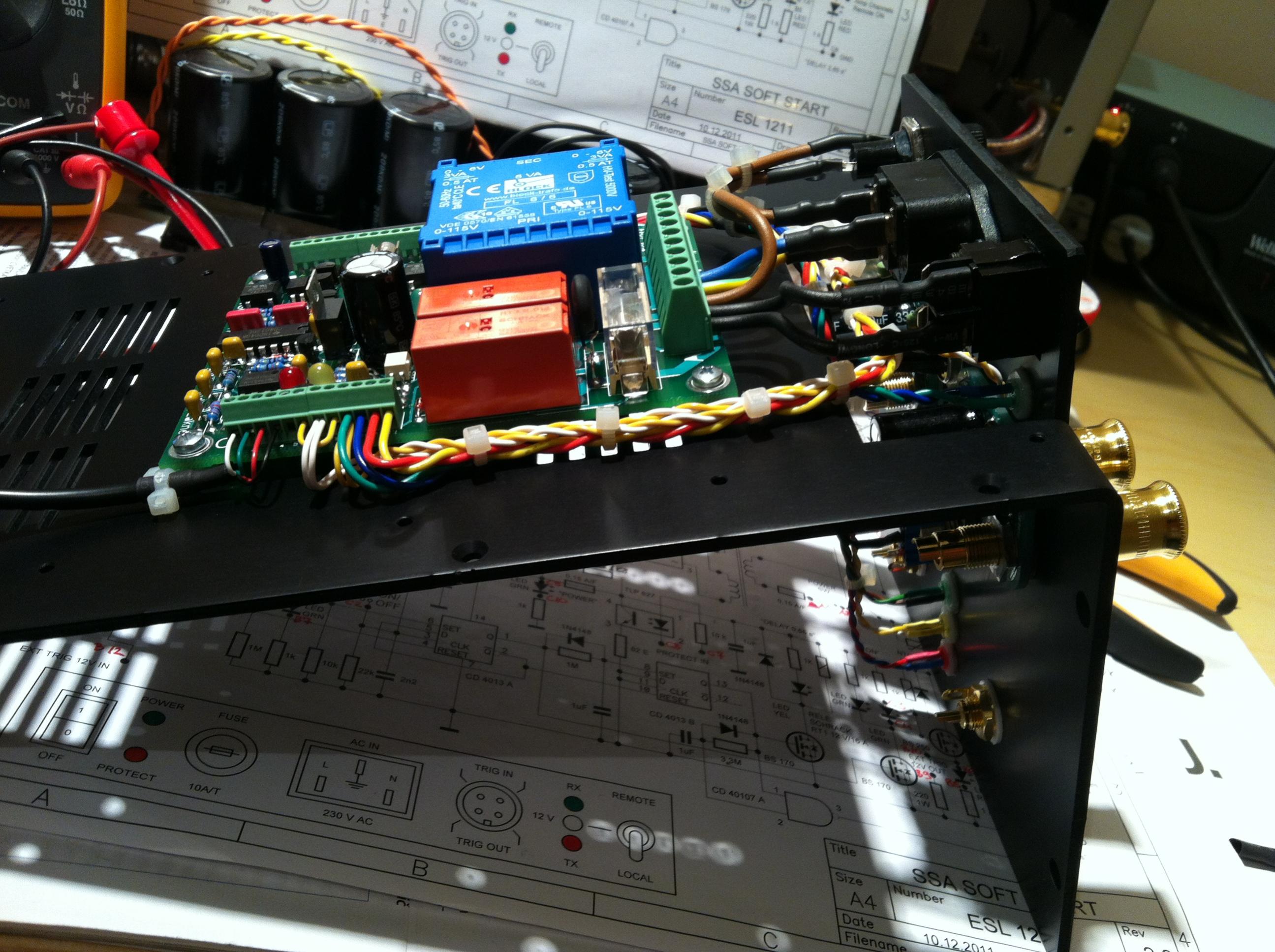

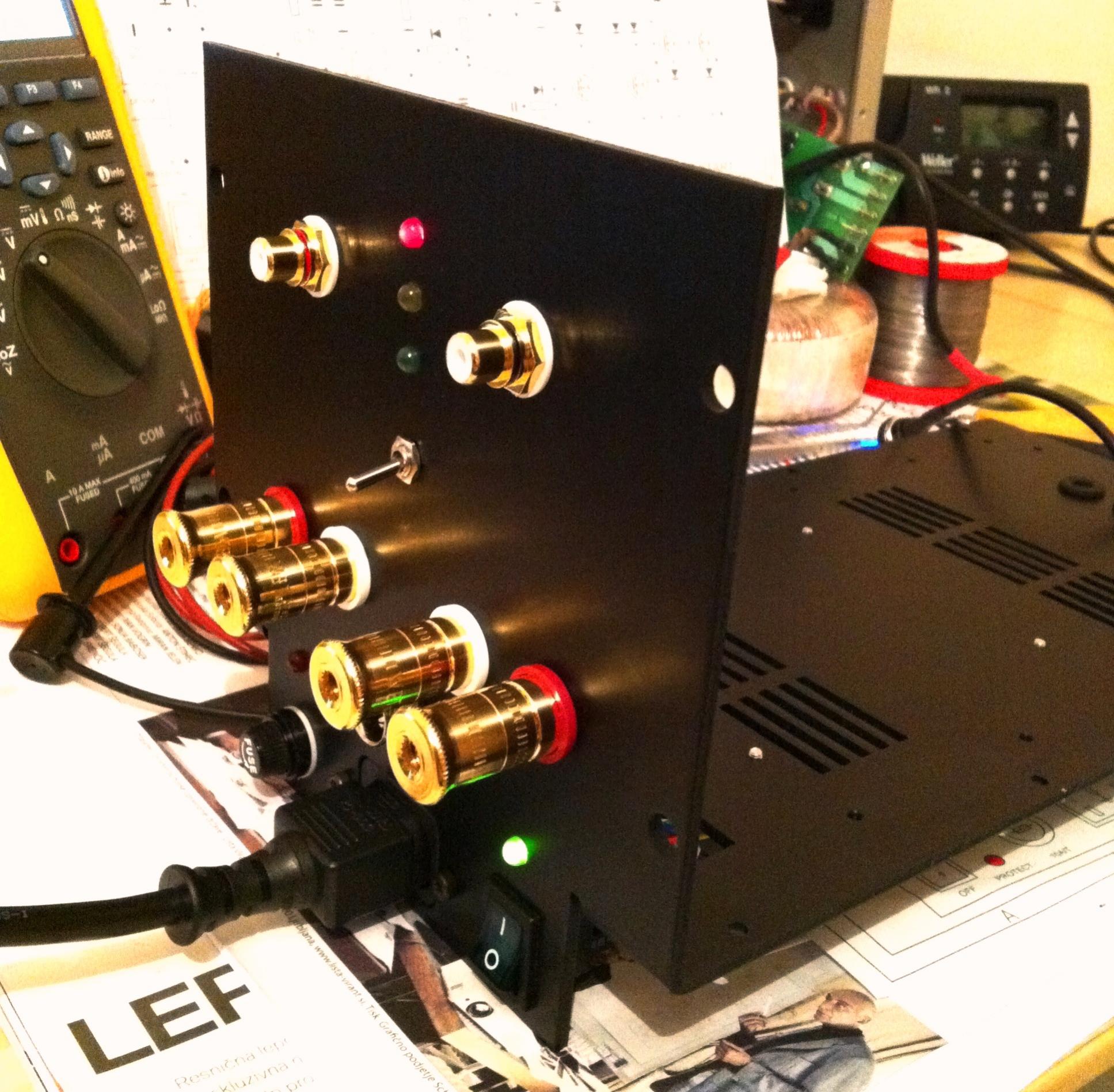

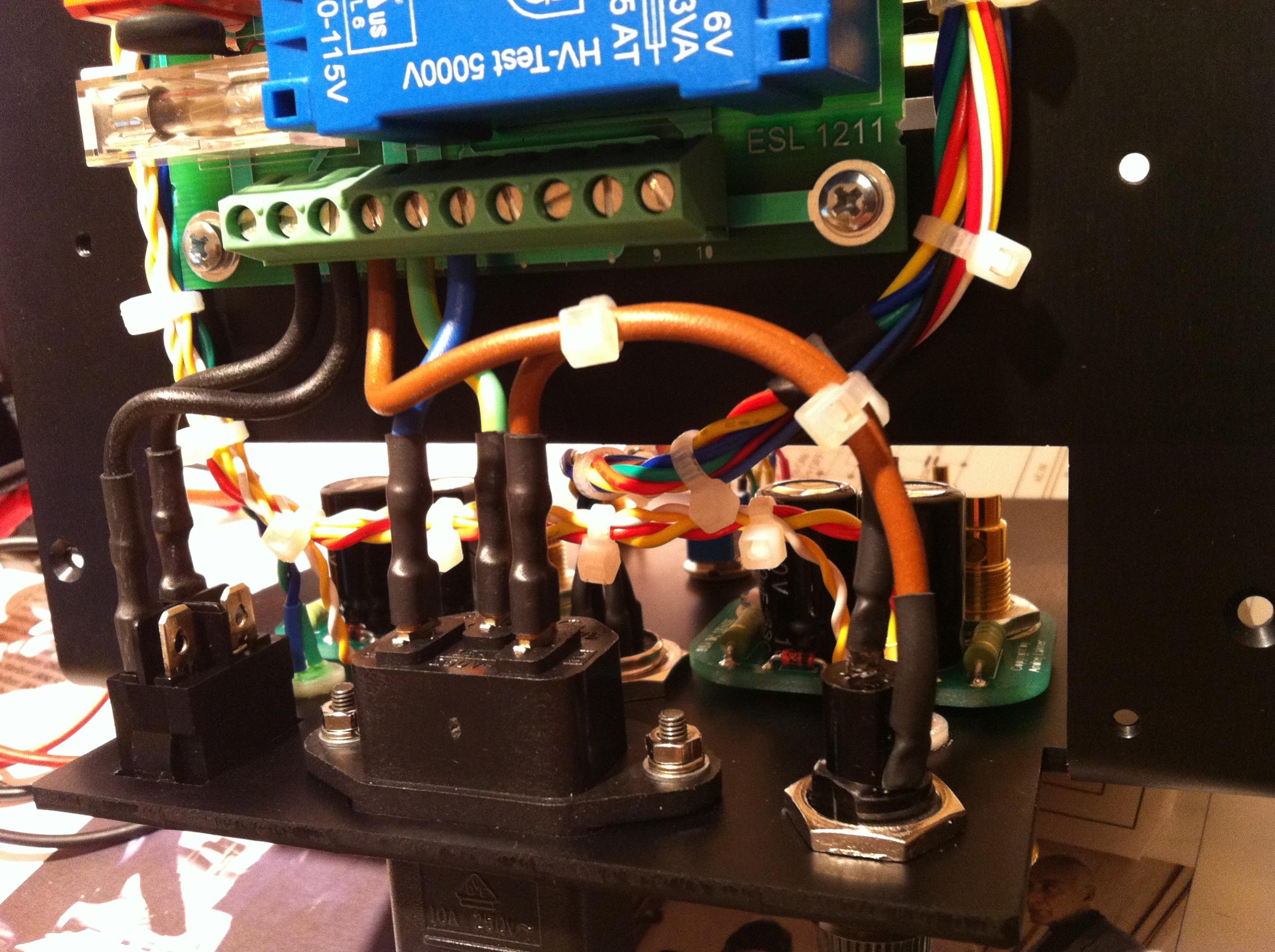

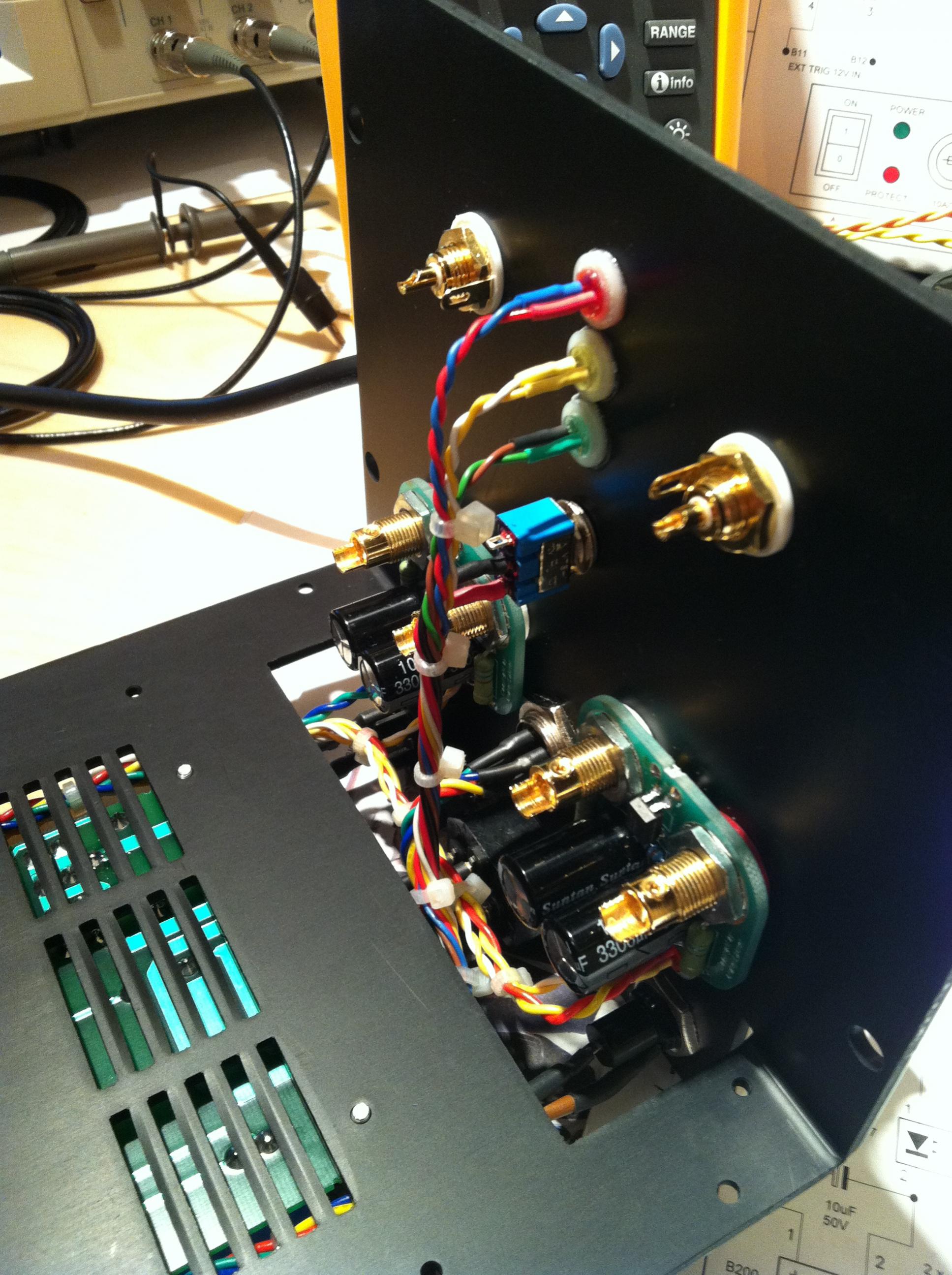

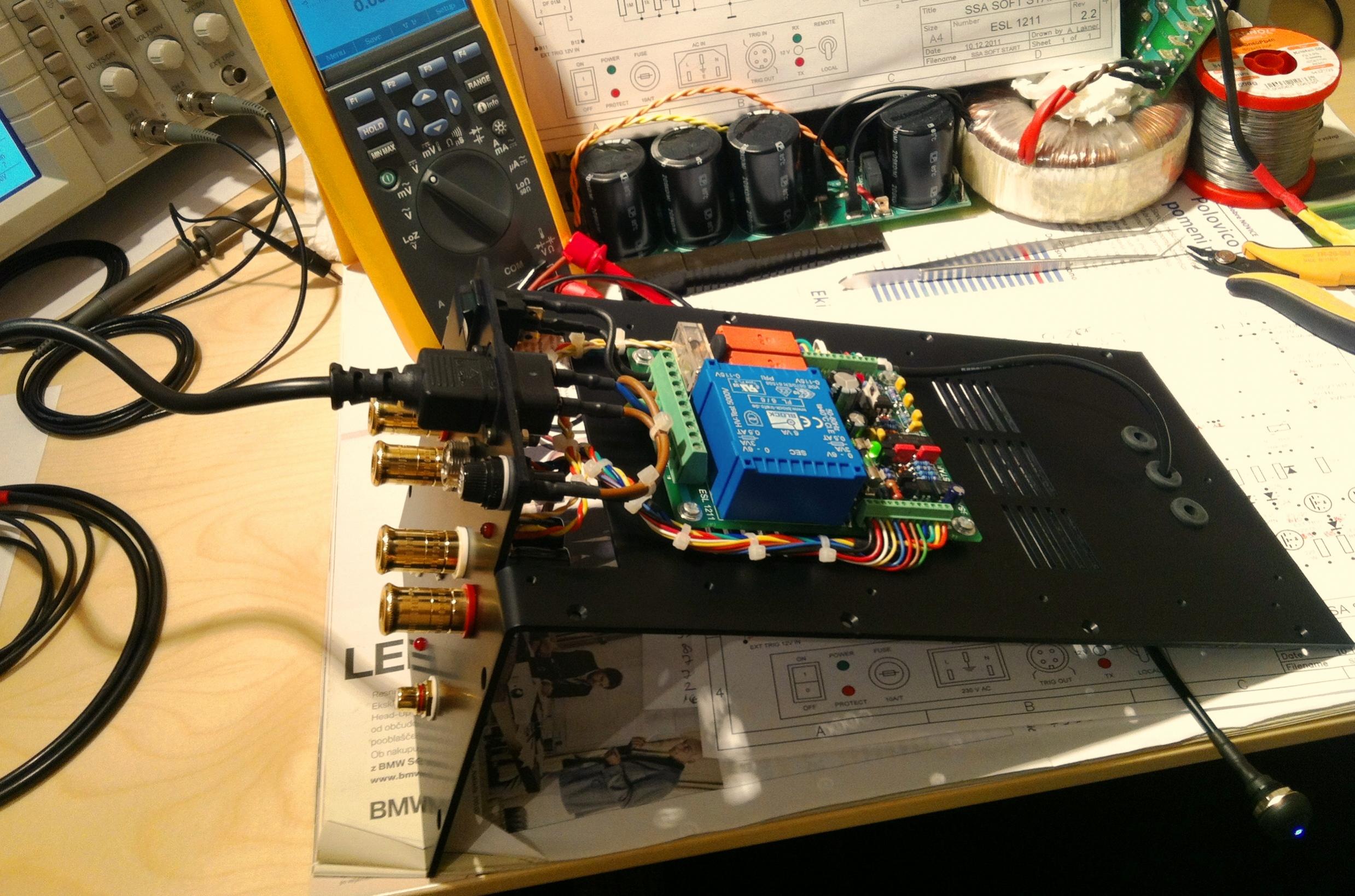

SSA Soft Start utility PCB and all external parts connected today, except input/output terminals which will be wired with channel modules later on. This kind of case module is easy to wire because every connection is made before final assembly, parts are accessible and can be easy to service if needed. 😎

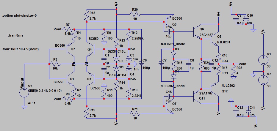

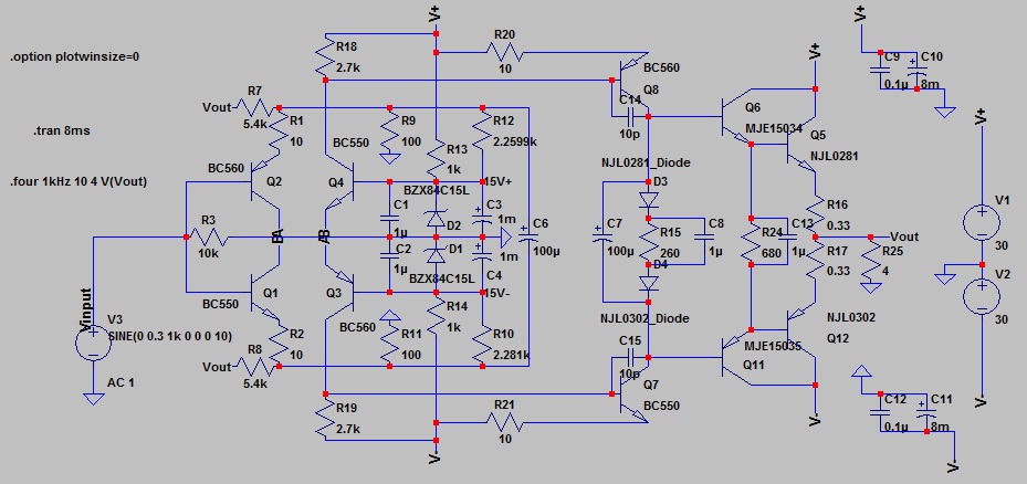

Next Size
LC, I'm planning another one, which using darlington EF.
Brought few good heatsink (0.5°C/Watt),
300VA 2 x 18 VAC secondary transformer, which should not be himalayas anymore.
As per attached, aiming for Vpp to 20+, which about 80-100W into 4 ohm.
By using BC550/560 as VAS with 5mA Iq, the gain, ft, Cob is good, only weakness is no heatsink attachment, but I have BP100 (thermal conductive adhesion tape). The peak dissipation is about 0.35W only, should be no problem.
The thing that i'm not sure about is C14/15 (compensation), according to 1st attachement simulation, 10pF seems to be best. But I wanted to use 2SA1707/2SC4487 as driver as in 2nd attachment, which I have no SPICE model, can't be simulated.
Hope everyone could give me suggestion for improvement.
Edit : I thought about NJL3281/1302 or NJL4281/4302 (and I have them), they seems to need to have slightly higher Iq for better ft response, maybe I will use in my next Class A project.
Also 0281/0302 have lower output capacitance. Should I have 2 pairs of it at OPS (paralleling for better performance) ?
About the previous SSA little I done, maybe because the 1707/4487 I replace in VAS, it oscillate at small scale and deteriorate the sound because there is no Cdom (and its ft is too good) ?
