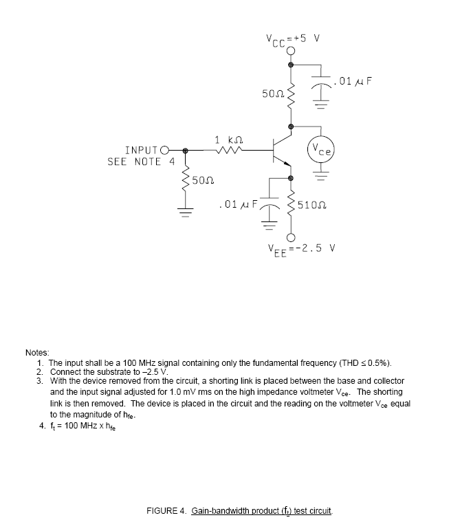

Extra question : I have some spare BD139/BD140 but they are from different manufacturer so their attribute could be very different. So I would ike to know what should do to determine is it "complementary" enough for use in amplifier ?

I was wondering Could they really "complement"
The multicomp one looks like Philips to me, the ST has a bigger die hence lower Ft. To really know two BJTs are following is curve tracing them but no NPN and PNP are ever perfect mirror images anyway. See to have a pair of near hfe and Cob from the same maker is the practical thing. If you can get the multicomp BD139 also it will be OK. What variety is it? -16? In Philips I got many near hfe ones from both sexes in -16.
no idea.... The web-dealer i normally brought from don't have other high FT (>100MHz) that is more than 50 Vce... with suitable for heatsink places... any idea how to know those 2 transistor's ft ?
