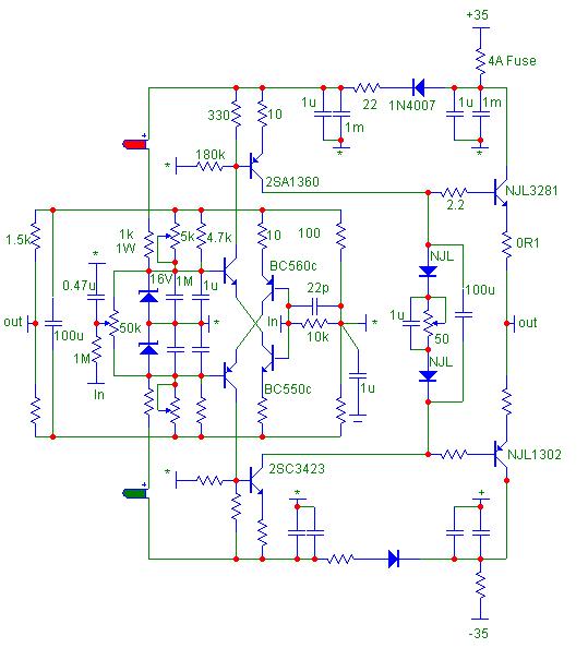

Here's what I've got. I'm not sure if this thermaltrak approach is practical. The VAS current is very sensitive to the VAS device temperature. Ideally they require a very efficient heatsink, but with very low thermal mass, so the equilibration temperature is reached quickly. Hard to do in practice. It takes quite a few minutes to stabilize. This with a pretty small heatsink - about 1mm thick by about 2cm square.
The 180k resistor from VAS base to common speeds up the initial temperature rise, but not the overall time.
I get nice ringing, so some compensation adjustments are needed (not shown on schematic are 15pf from base to collector). But I don't want to spend the effort unless I can get this thing to settle much faster.
You were contemplating some Vbe mult. between the drivers and/or TO-92 DN2540s instead of trimmers, weren't you?
