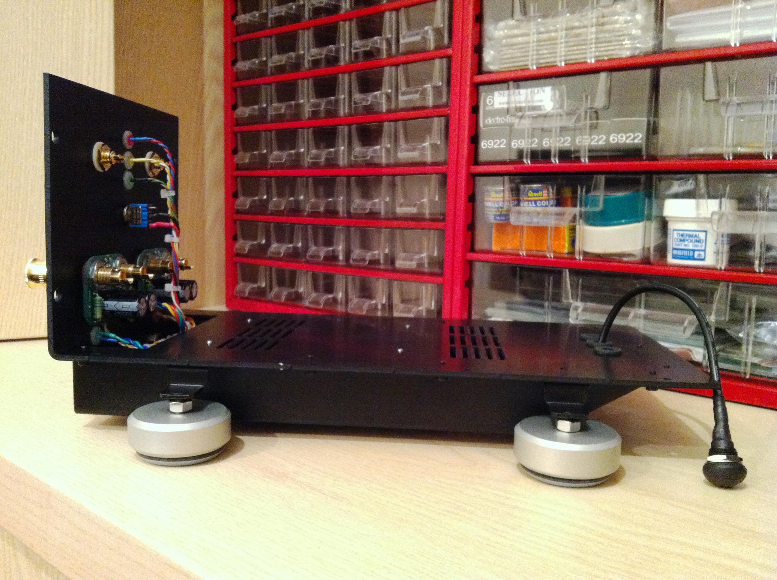

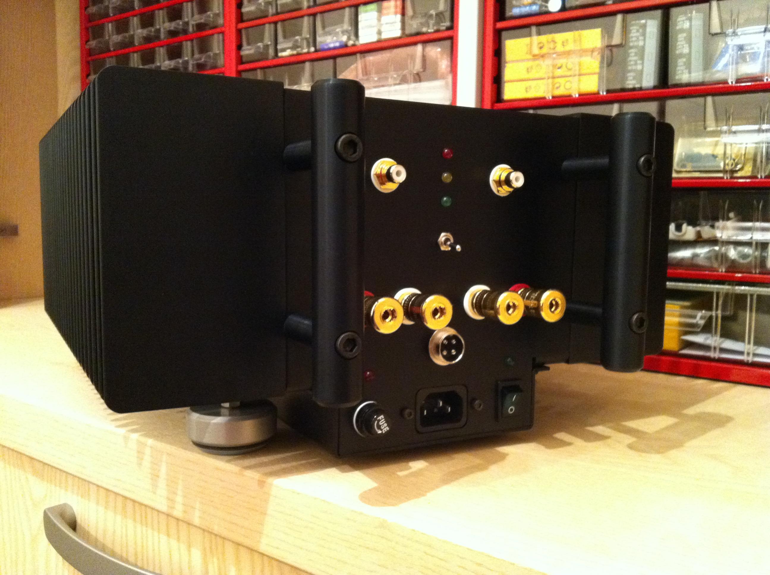

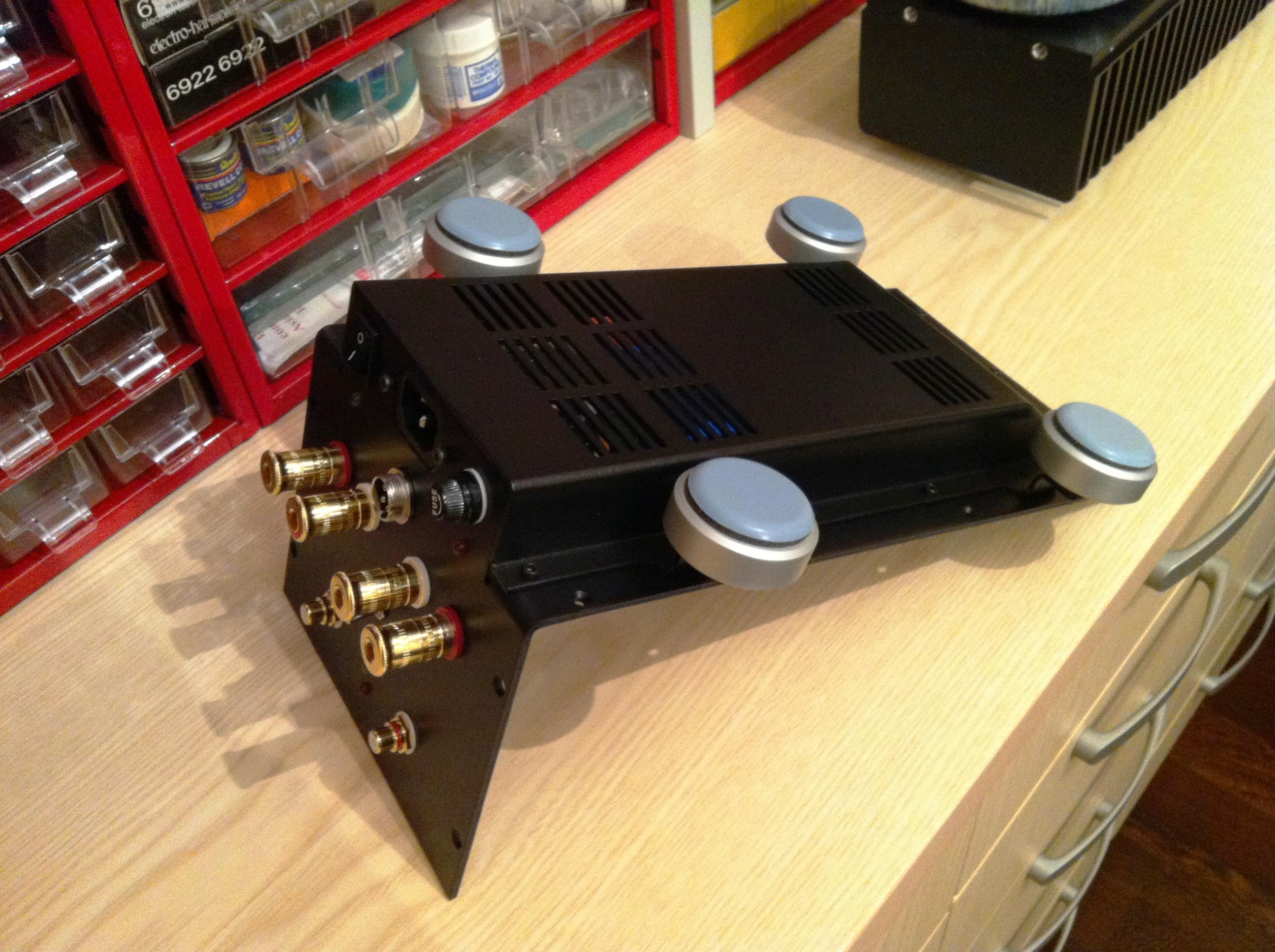

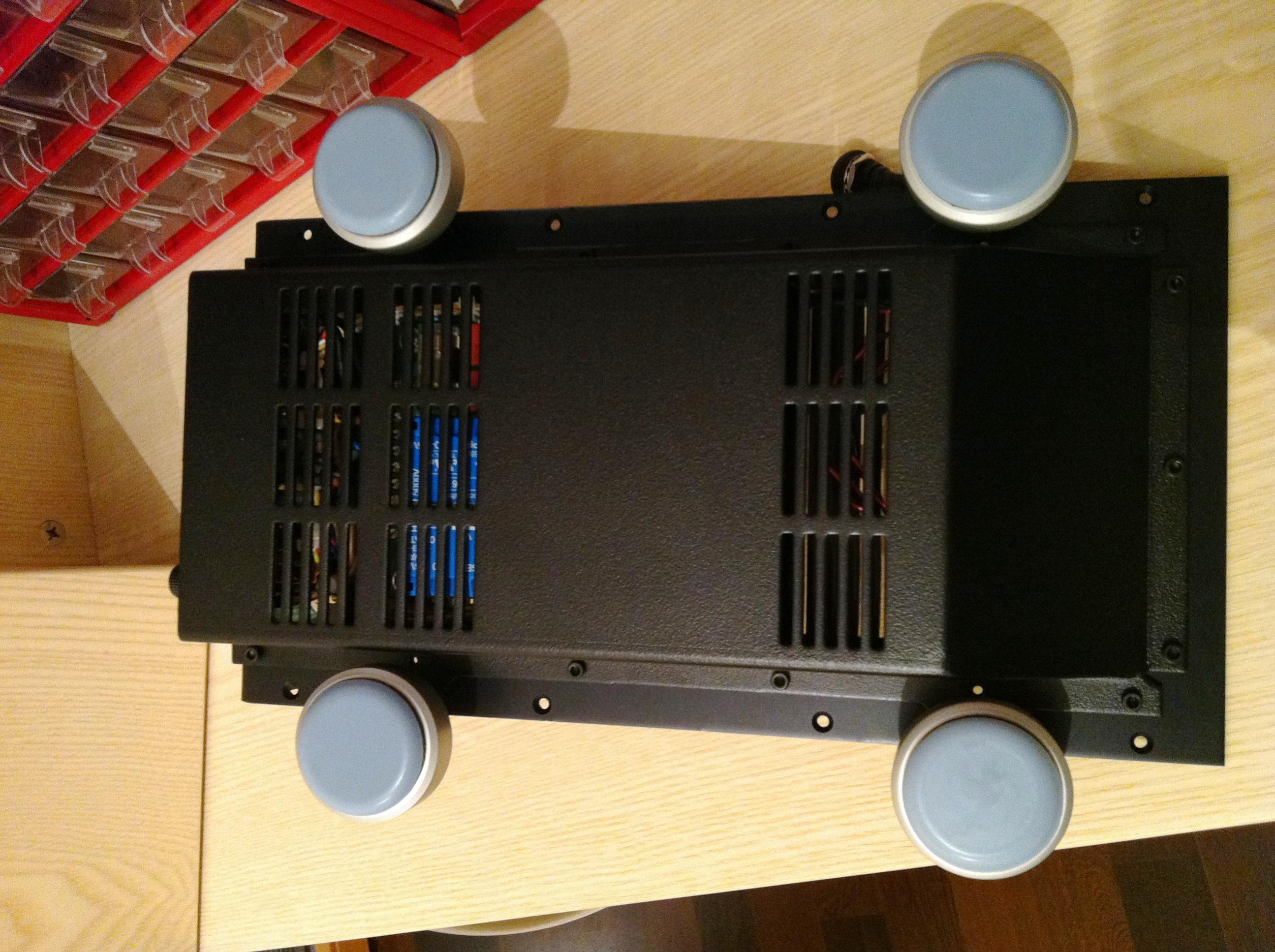

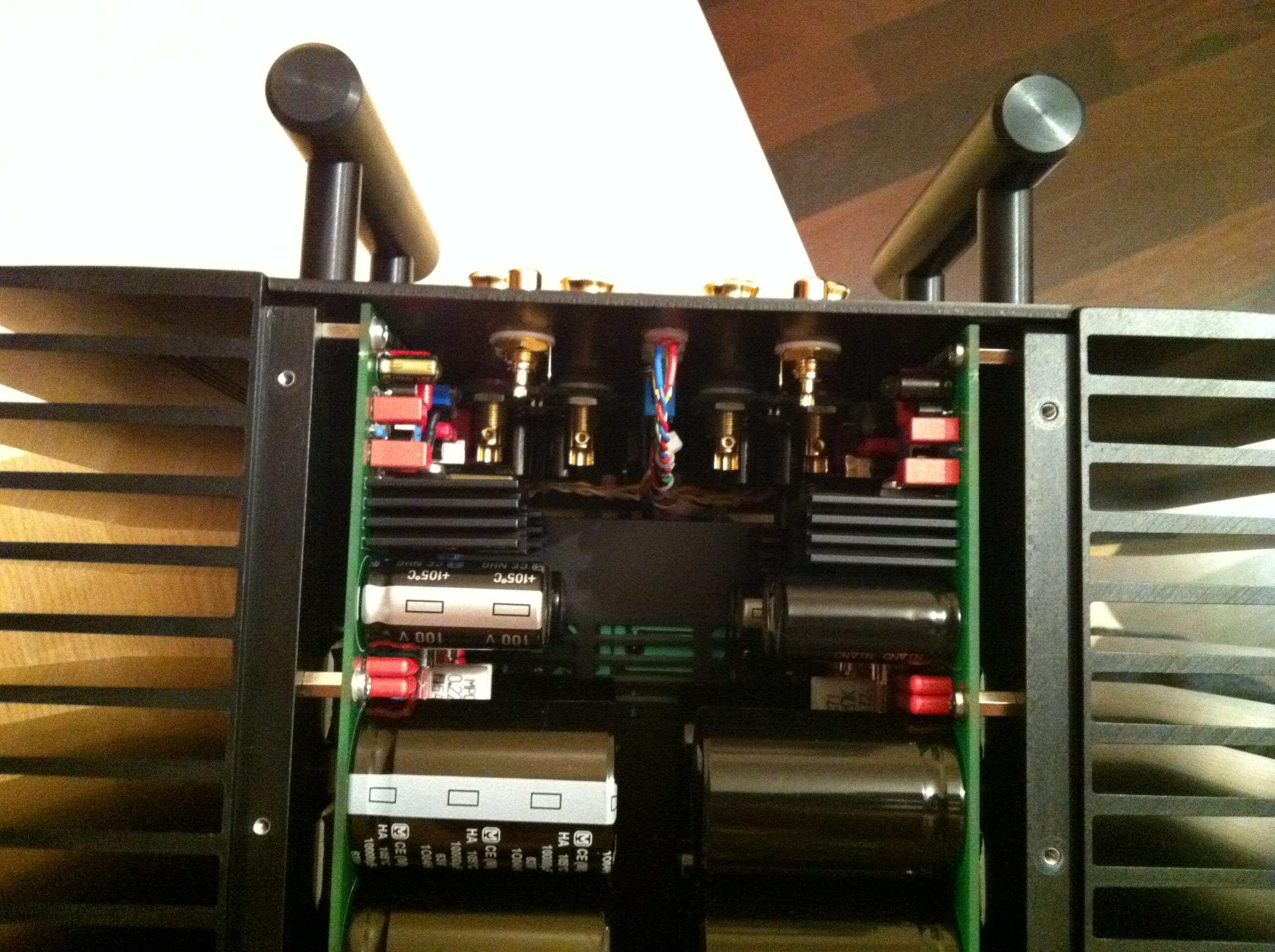

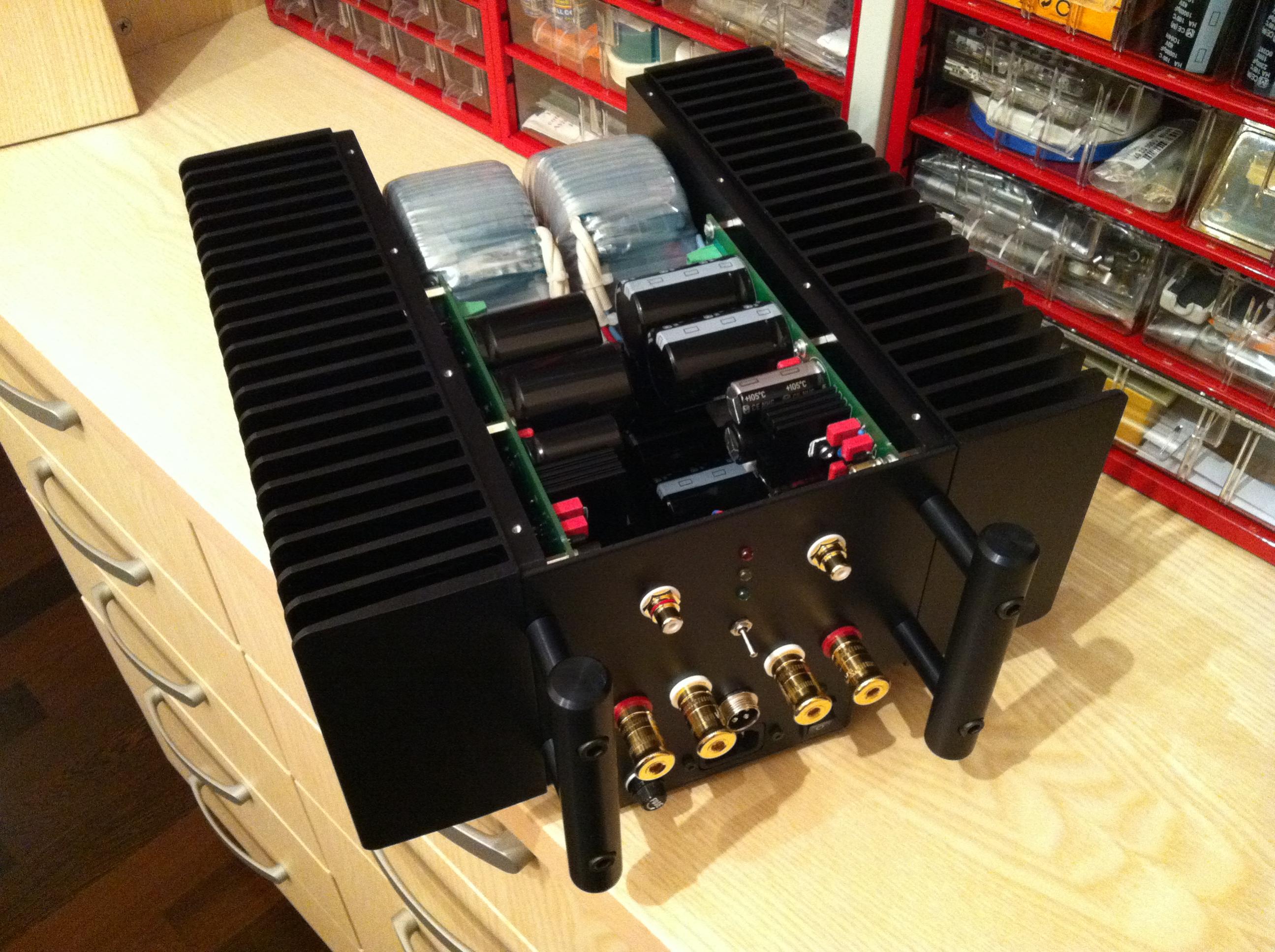

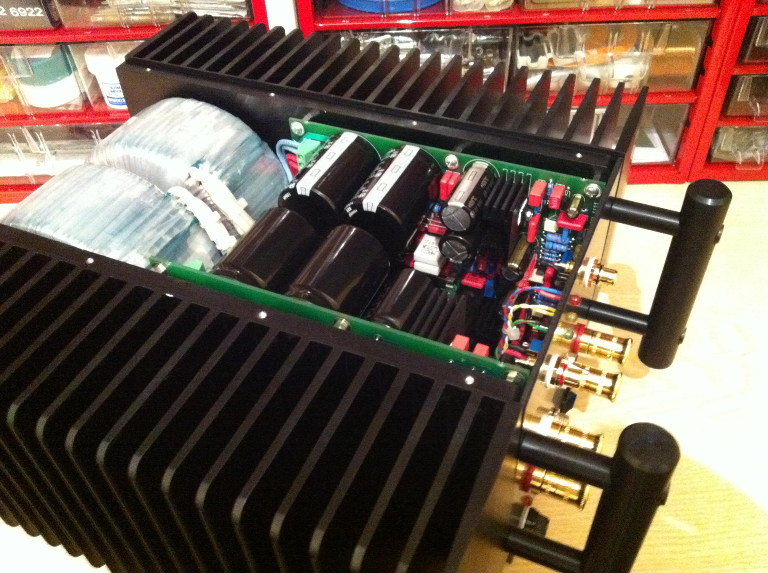

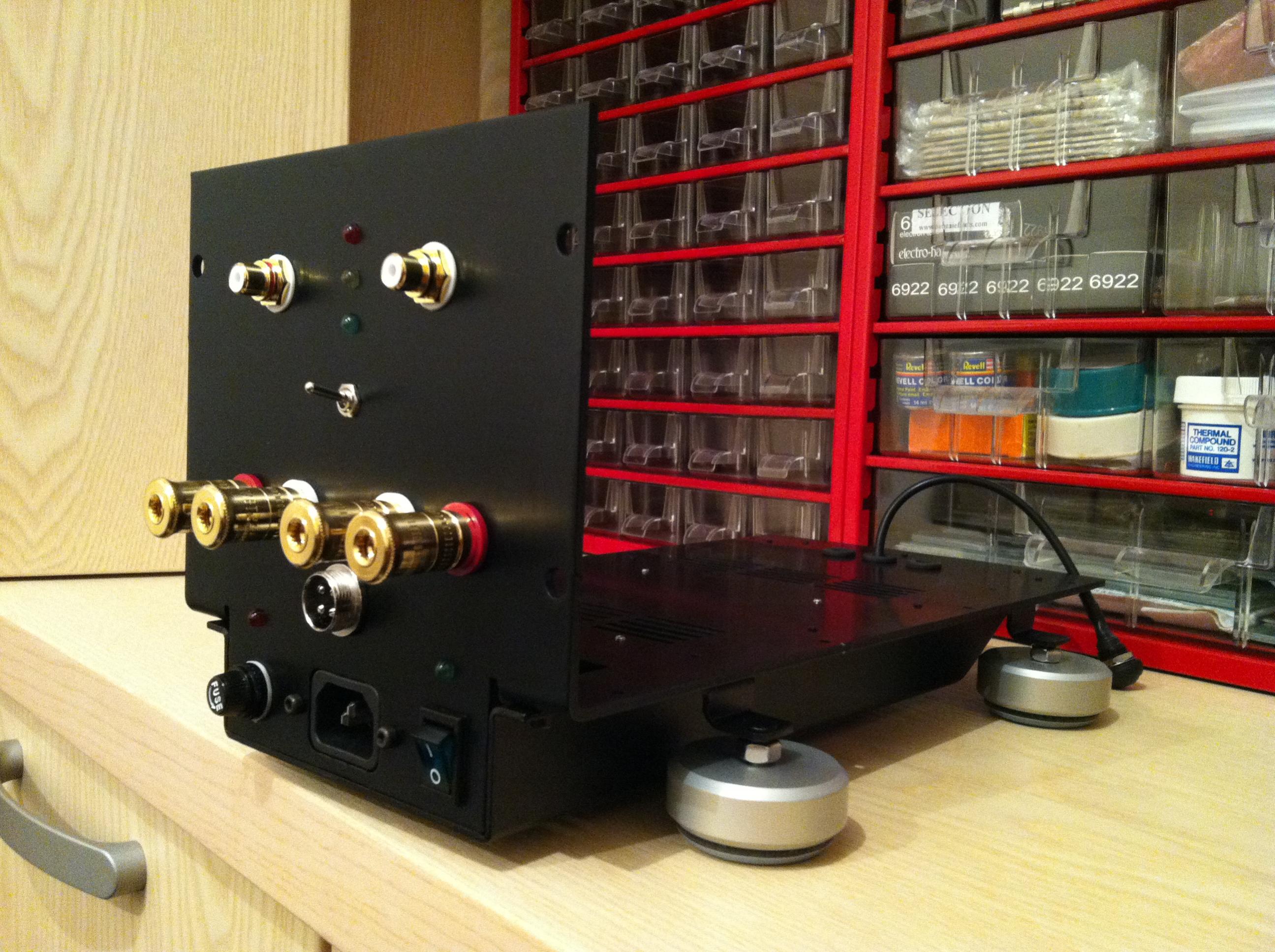

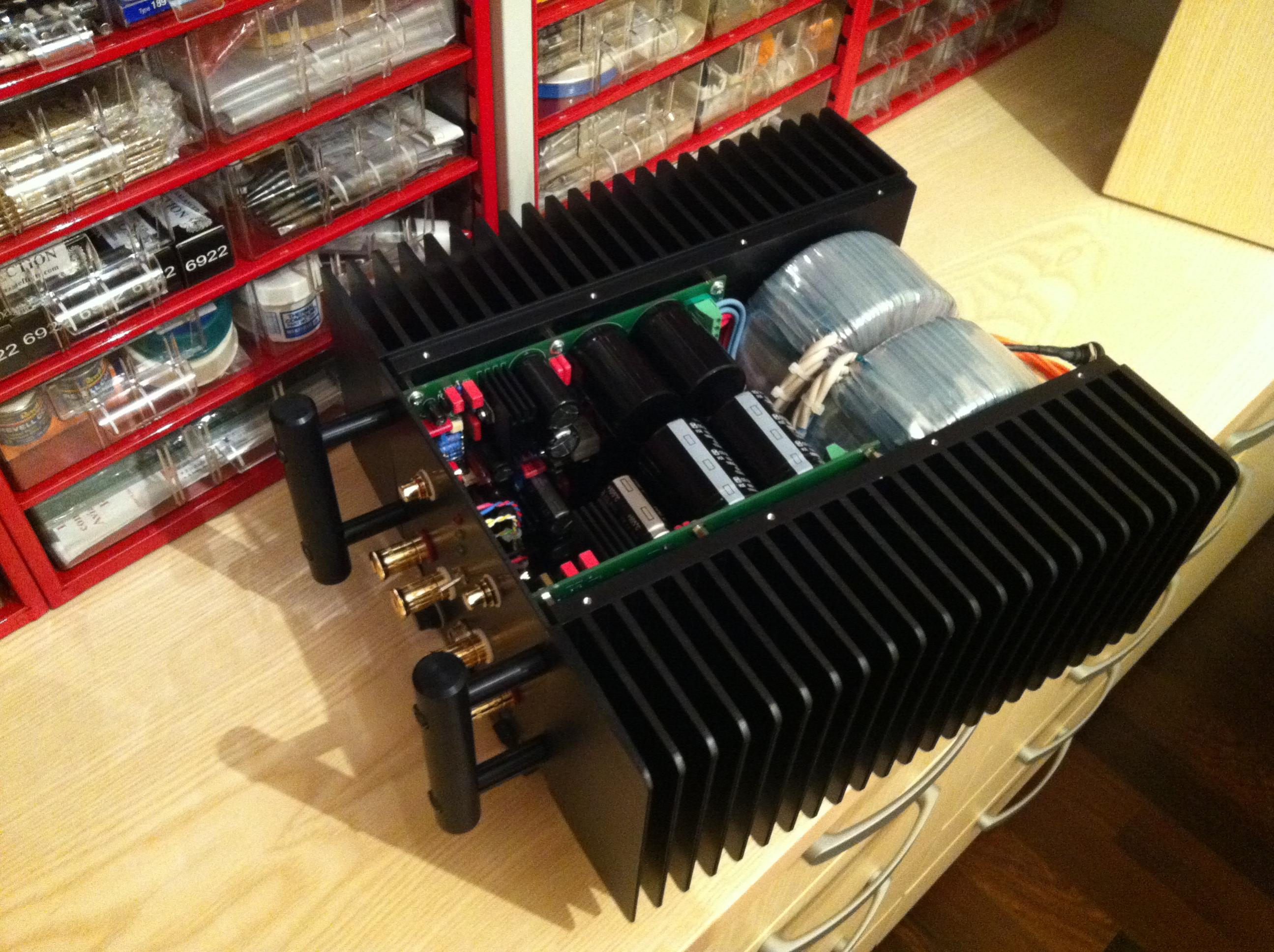

Hi guys, me back :D
I really like the simplicitiy of the input stage and splitted feedback and all about SSA, so I decided to solve thermal stability issue in a simple manner. Of course one could do it by adding BJT's, OP amps, etc., but than this would become something else. The simplest solution of them all is to put NTC + serial resistor in parallel to 100 uF in feedback bridge. NTC must be thermally coupled with the input pair BJT-s and serial resistor is serving to lock the NTC to be in exact proportion to input's Vbe thermal drift. At the end VAS bias current is stabilized to 10 mA from cold start to any thermal condition there is. ;)
And some pictures to show how SSA BIGBT HP should look at the end. :cool:
