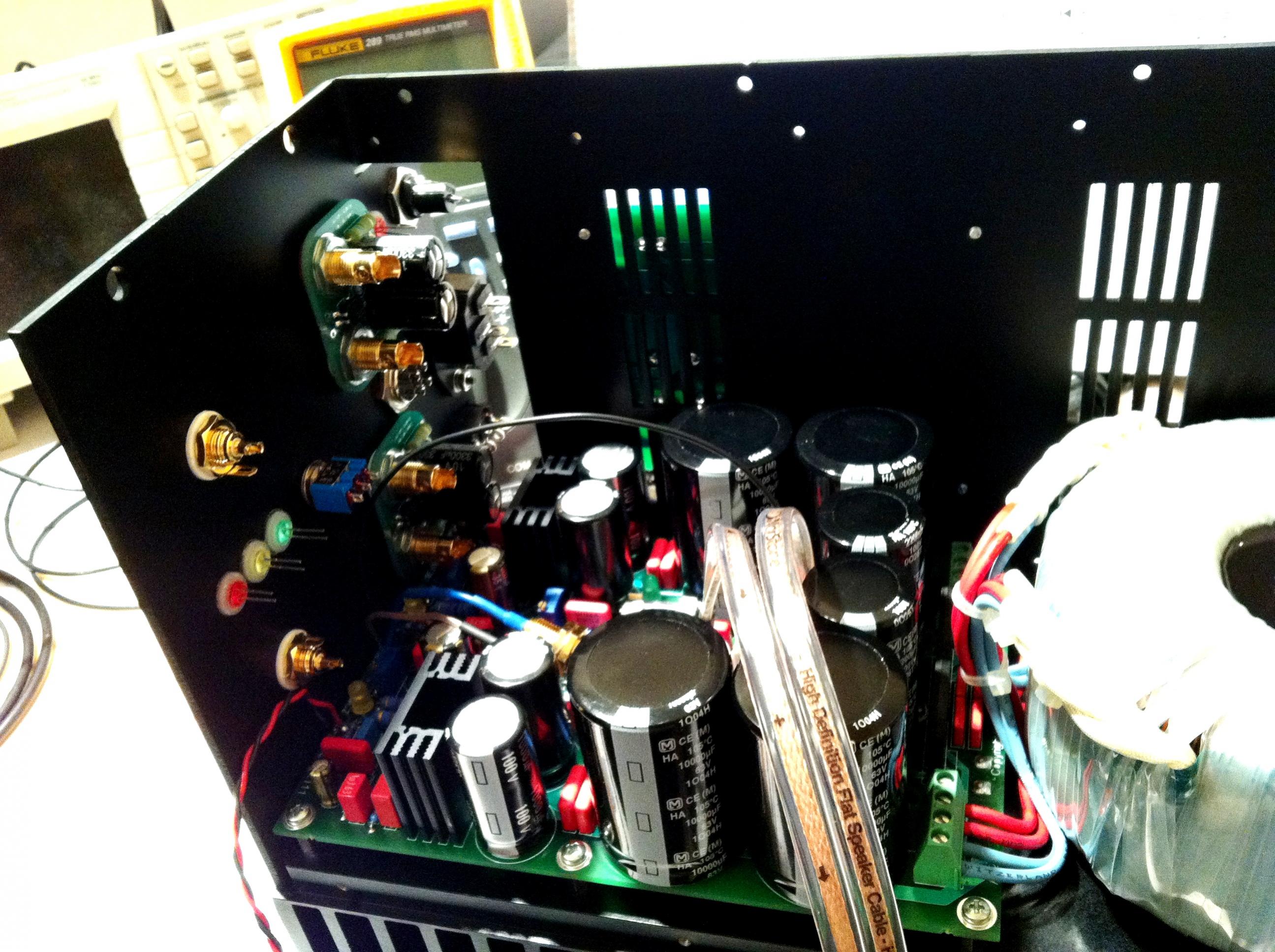

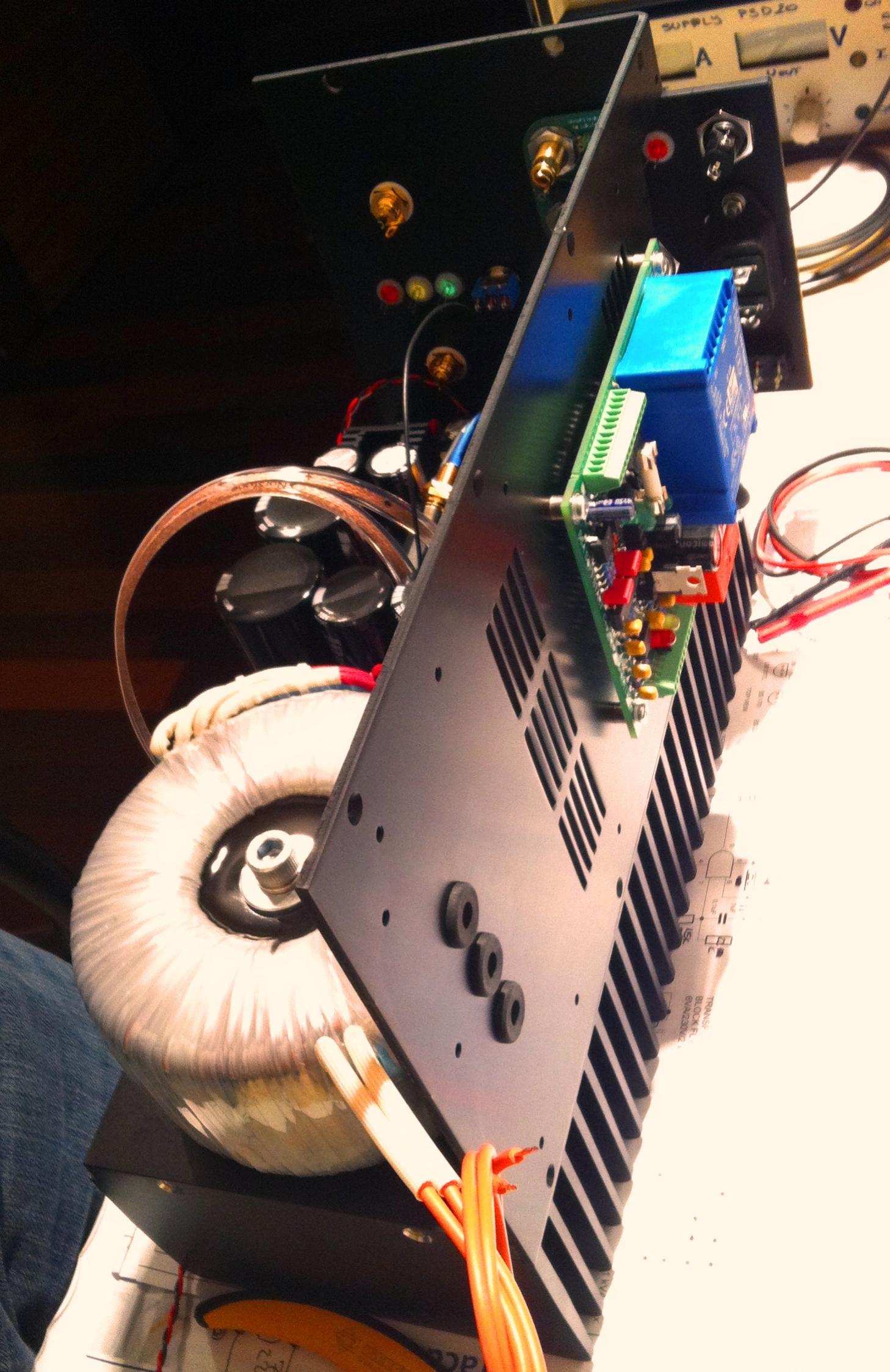

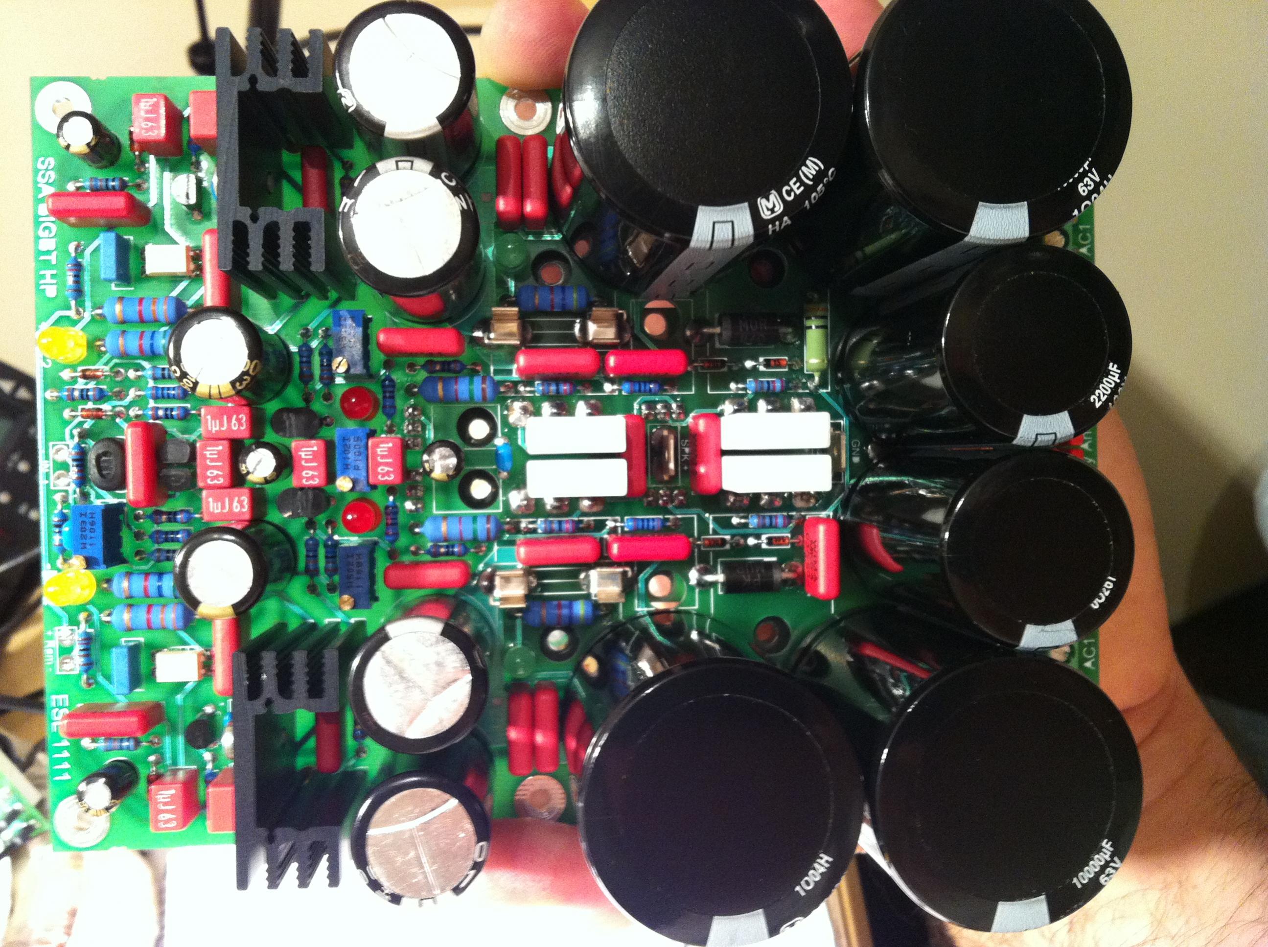

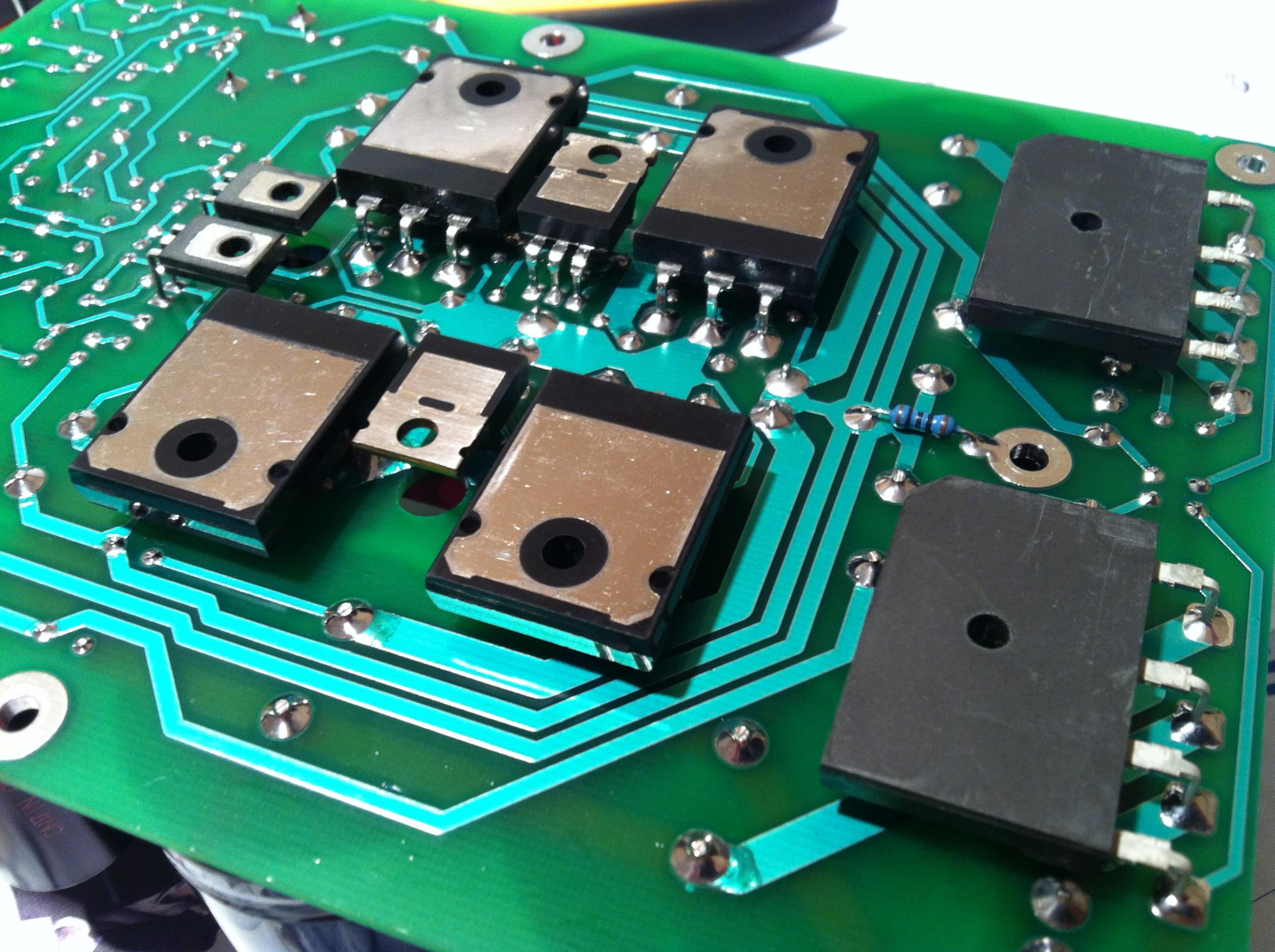

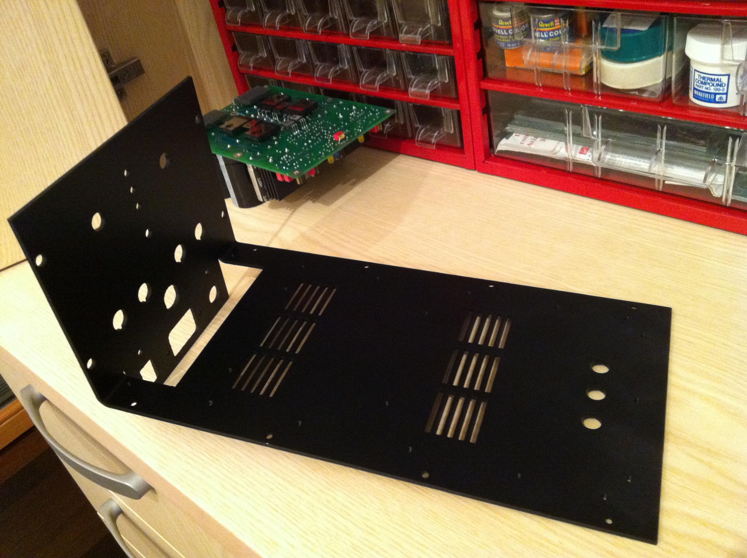

Second SSA BIGBT HP channel before testing. 😎

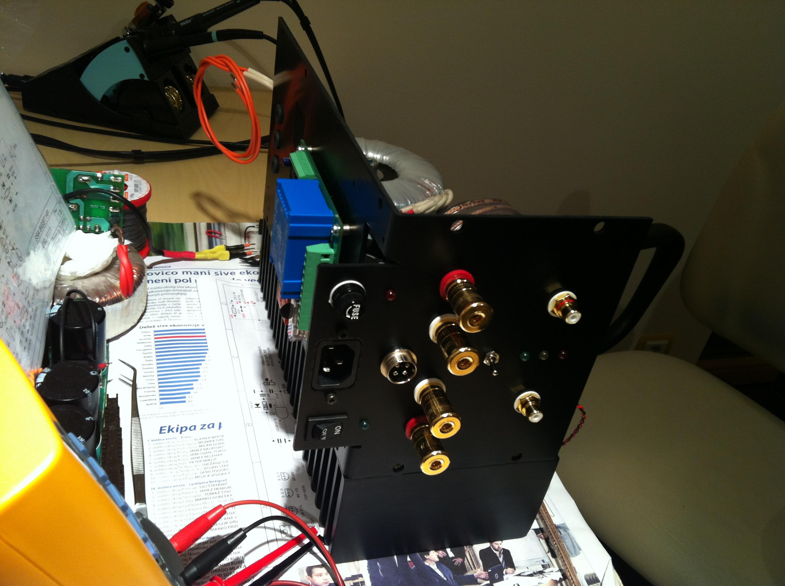

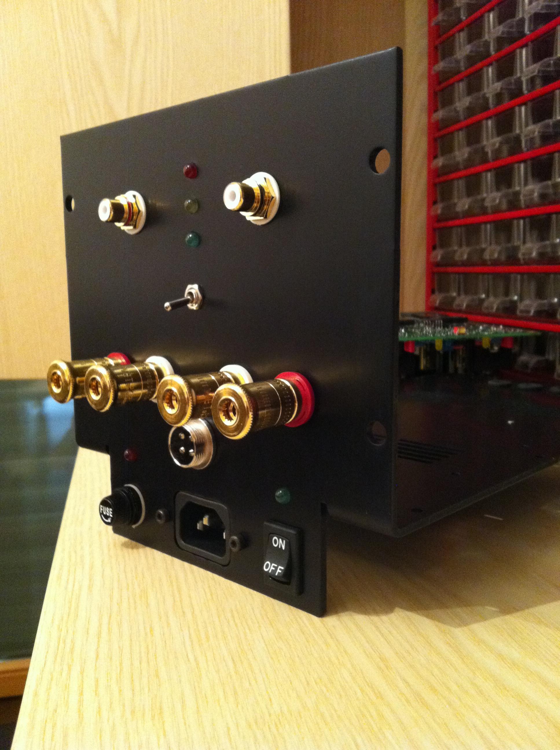

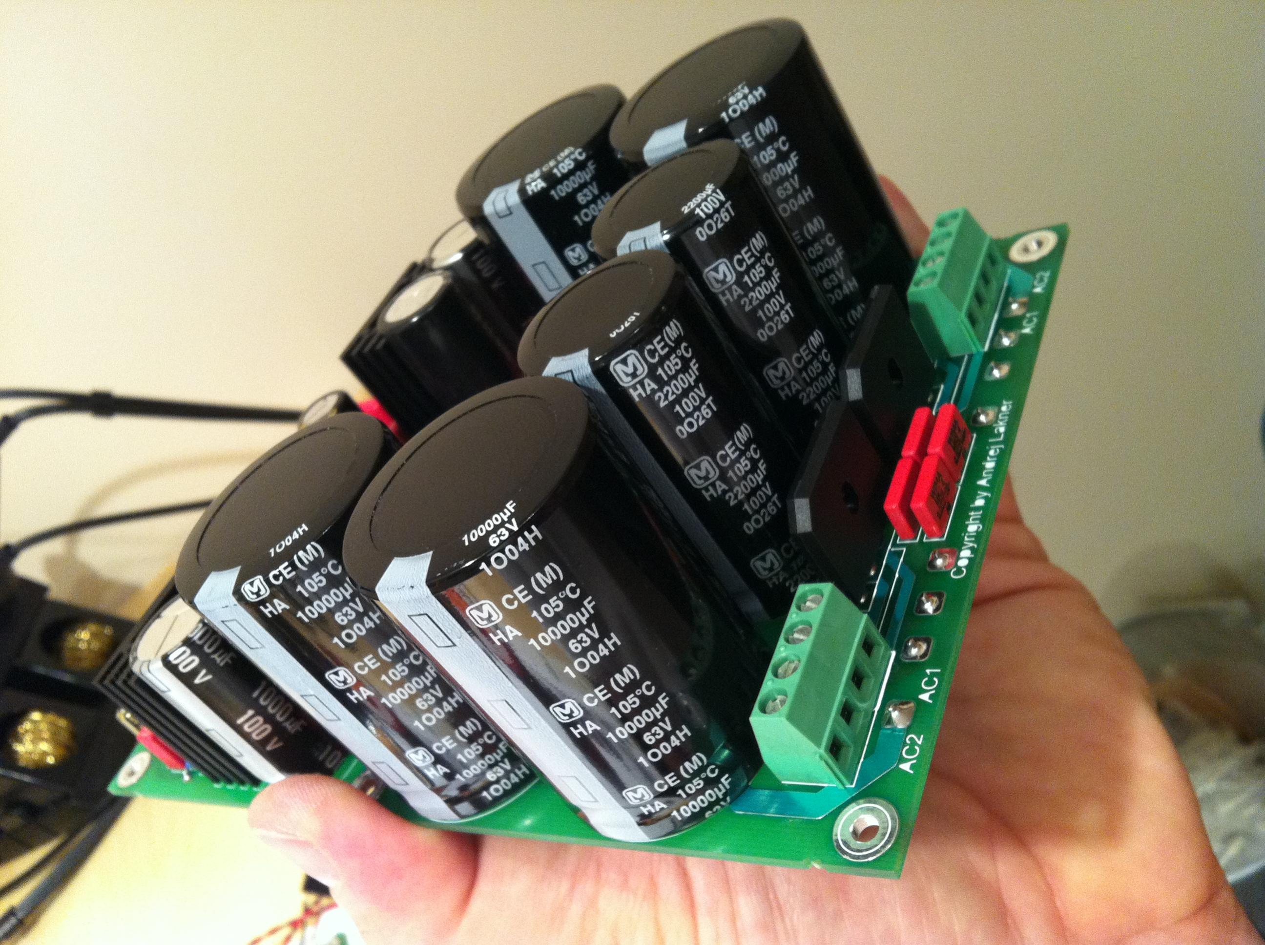

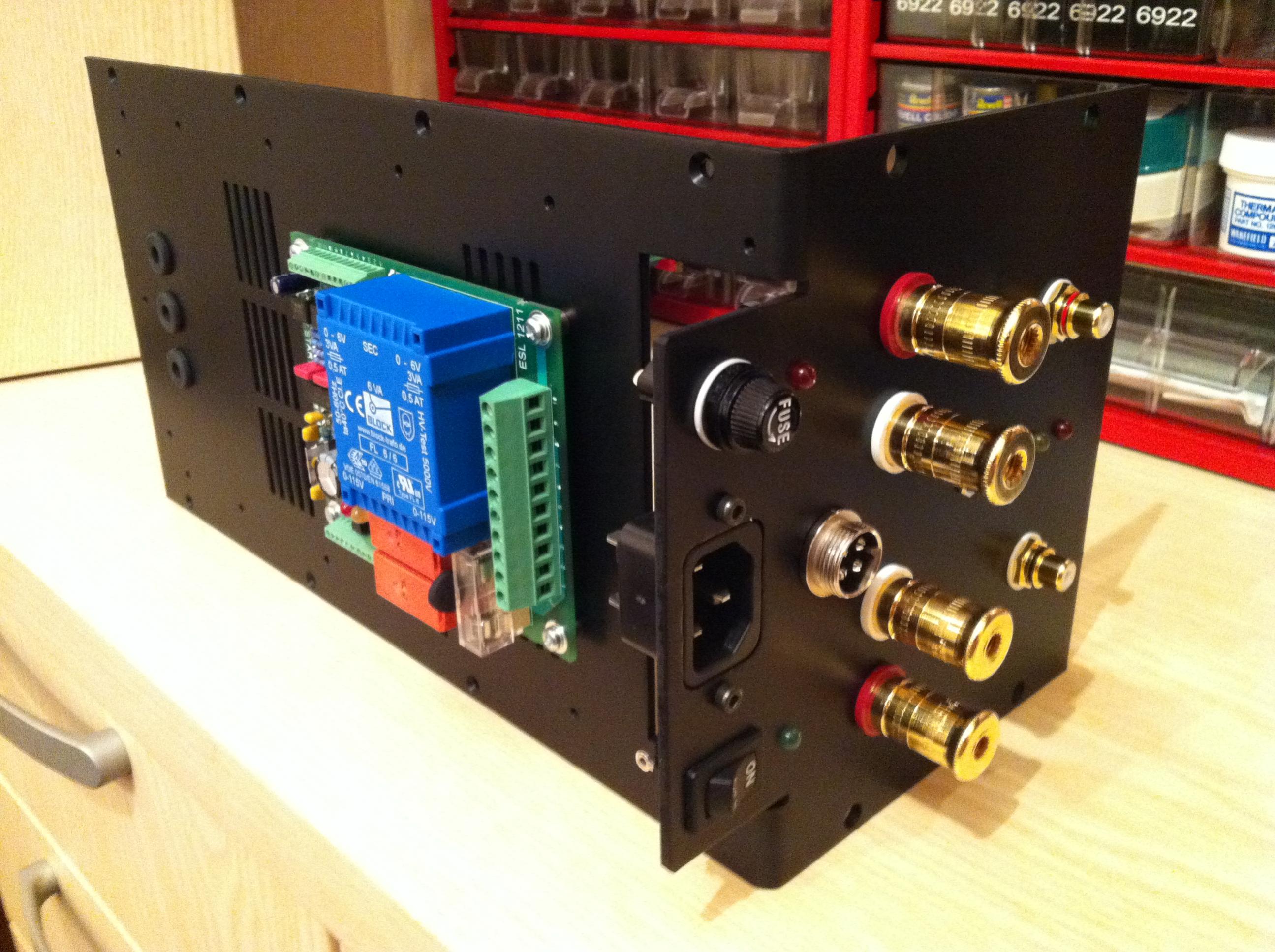

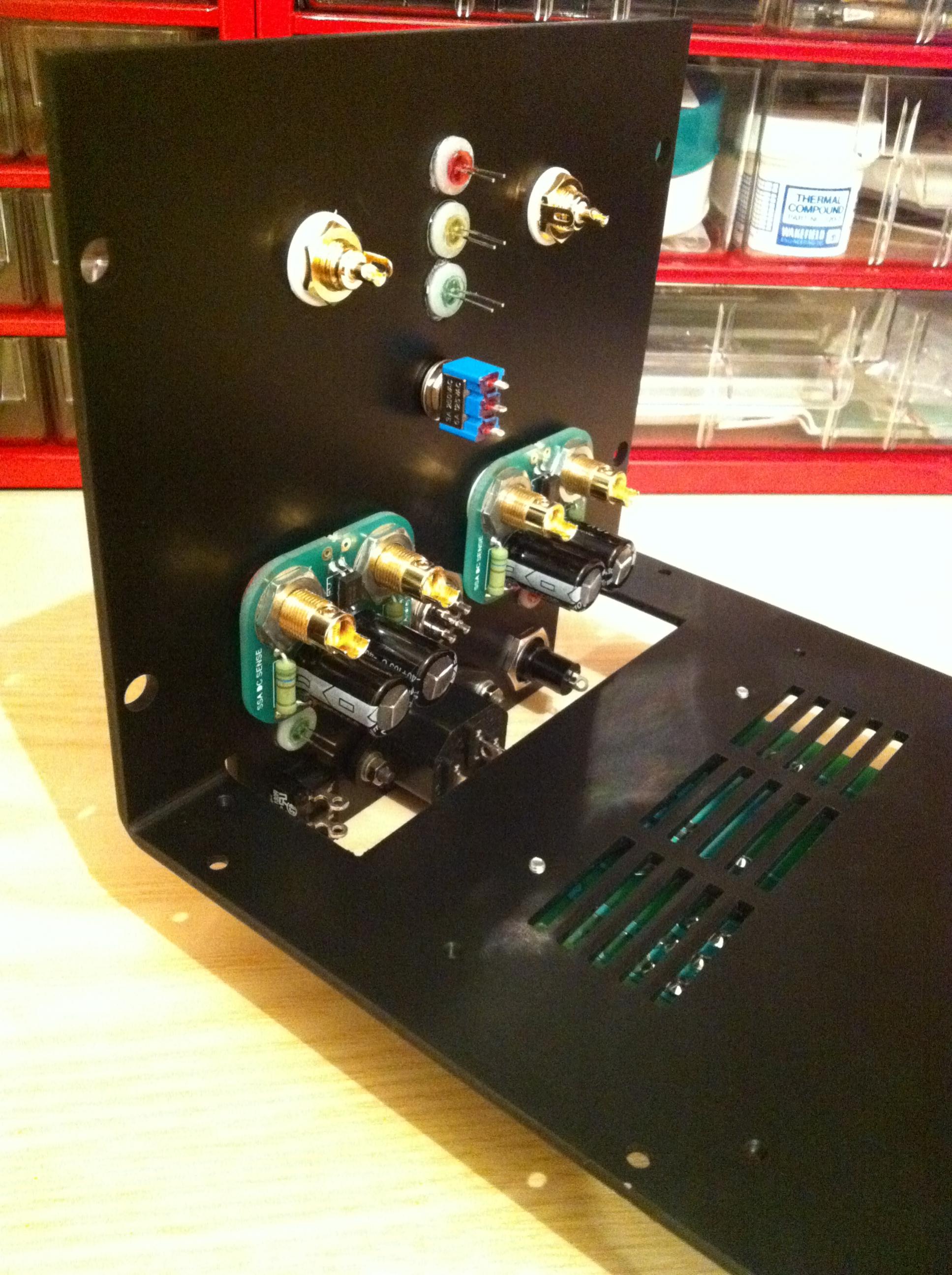

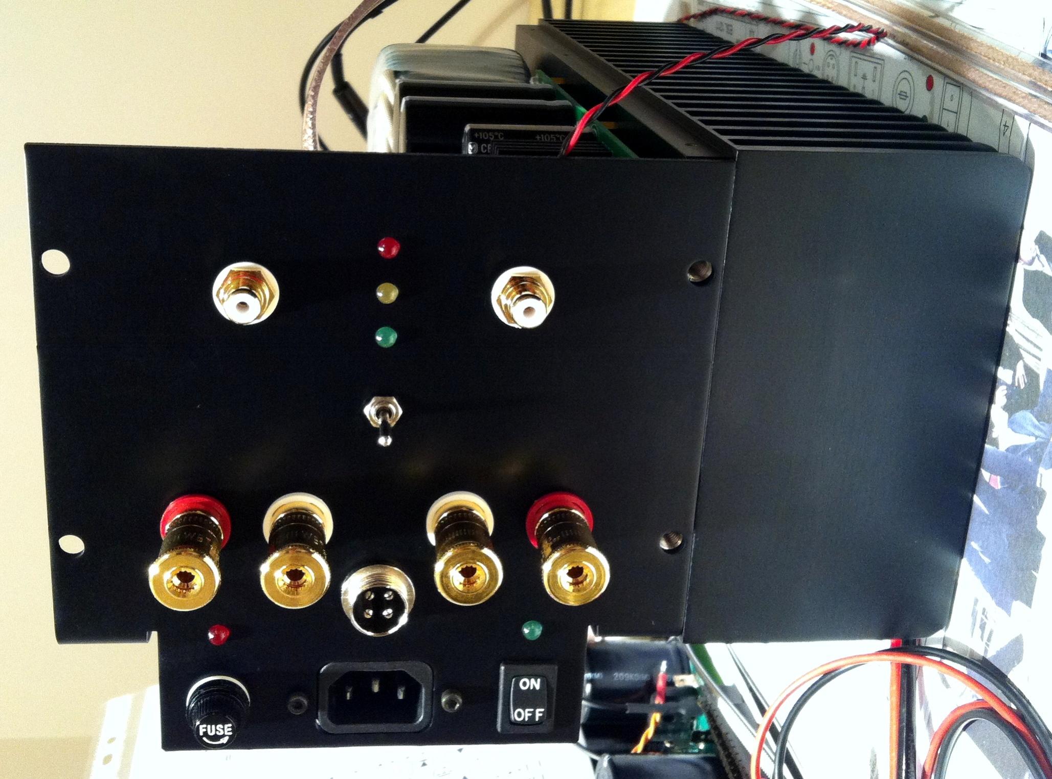

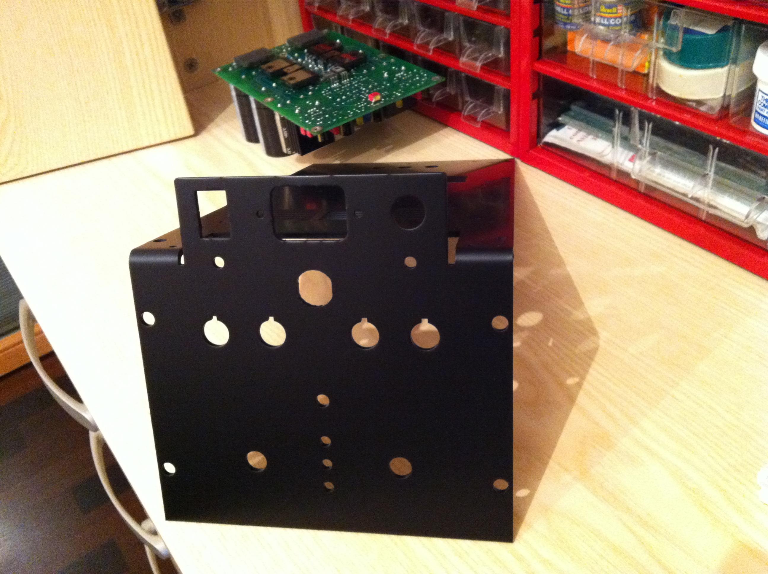

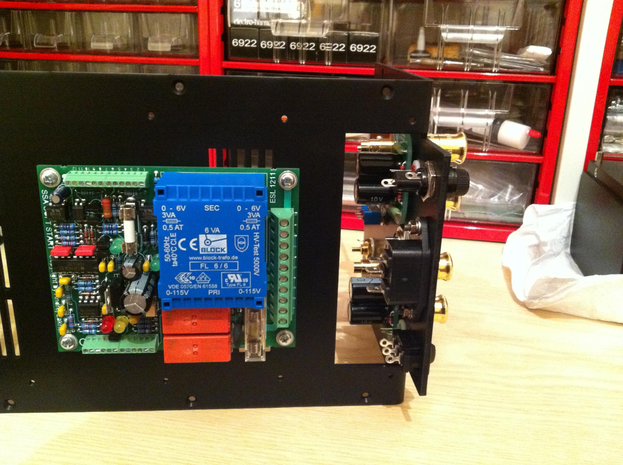

Few more pics from today's assembly. 😉
Maybe less but certainly more than 100 dB/1 W/1 m. Trio alone, but still two more horns in the room to feed ... 😀
Stereo SSA will have 5 PCB-s:
- two SSA Channel PCB
- two SSA DC Sense PCB (at output terminals)
- one SSA Soft Start utility PCB
I'll do complete parts count plus costs summarization when listening the amp in my system, at that point will be my pleasure to do something more for DIY-ers potentially interested to build something like this. 😉
