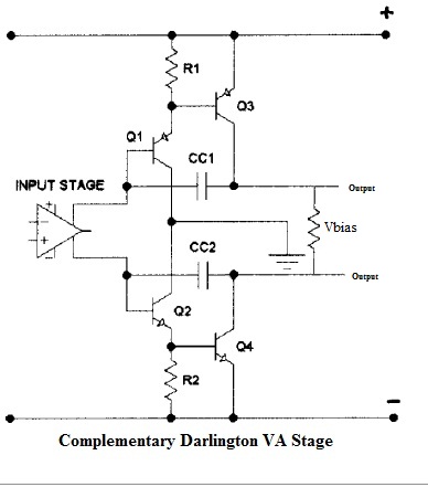

VAS arrangement ?
I'm thinking is it possible to integrate this VAS to SSA ? I think it is known as complementary darlington VAS.
It seems have good properties, but I have no idea what value should be CC1, CC2, R1 & R2. Is possible to use without those capacitor ?
If you don't want to use cascoded VAS this is also very good solution for high current gain "single" VAS device regarding input stage isolation from output load impedance influence. 🙂
Omitting CC1, CC2 would be unwise-impossible cause amp without them would certainly oscillate. Their values depends on many factors but it would be somewhere in between 20-100pF. 😉

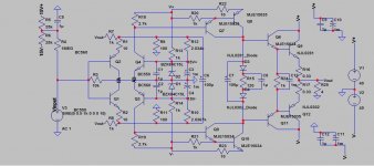

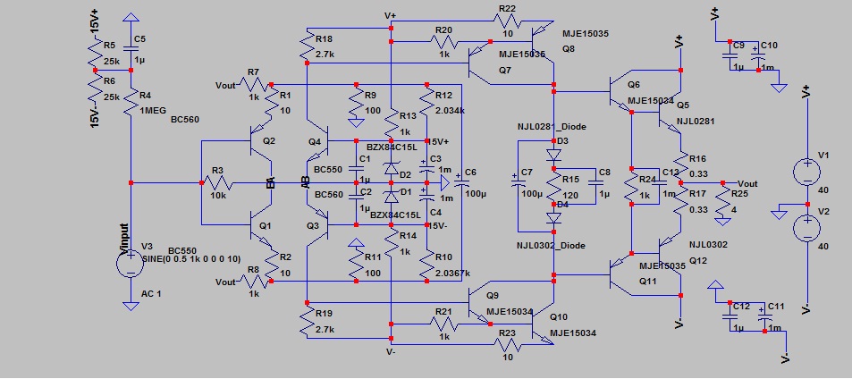

LC, what i'm thinking is such design as attached.
By using those, I get very high open loop gain and low THD.
The VAS are biased as 0.7mA & 10mA
The driver is biased to 1-2mA & 20mA to Output device.
what could be the good number for C13, which is around the OPS, between the Drivers ?
I intend to change those drivers to the 2SA1707/2SC4487 (didn't do in SPICE because no model.....)
and the OPS change from 0281/0302 to NJL4281/4302. (In SPICE, the number is quite outrages......)
Hope it will turn out into a very nice X.x
There is something I dont understand: how can your Q3, Q4 bases be at +15V and -15V while their emitters are at 0V ?
