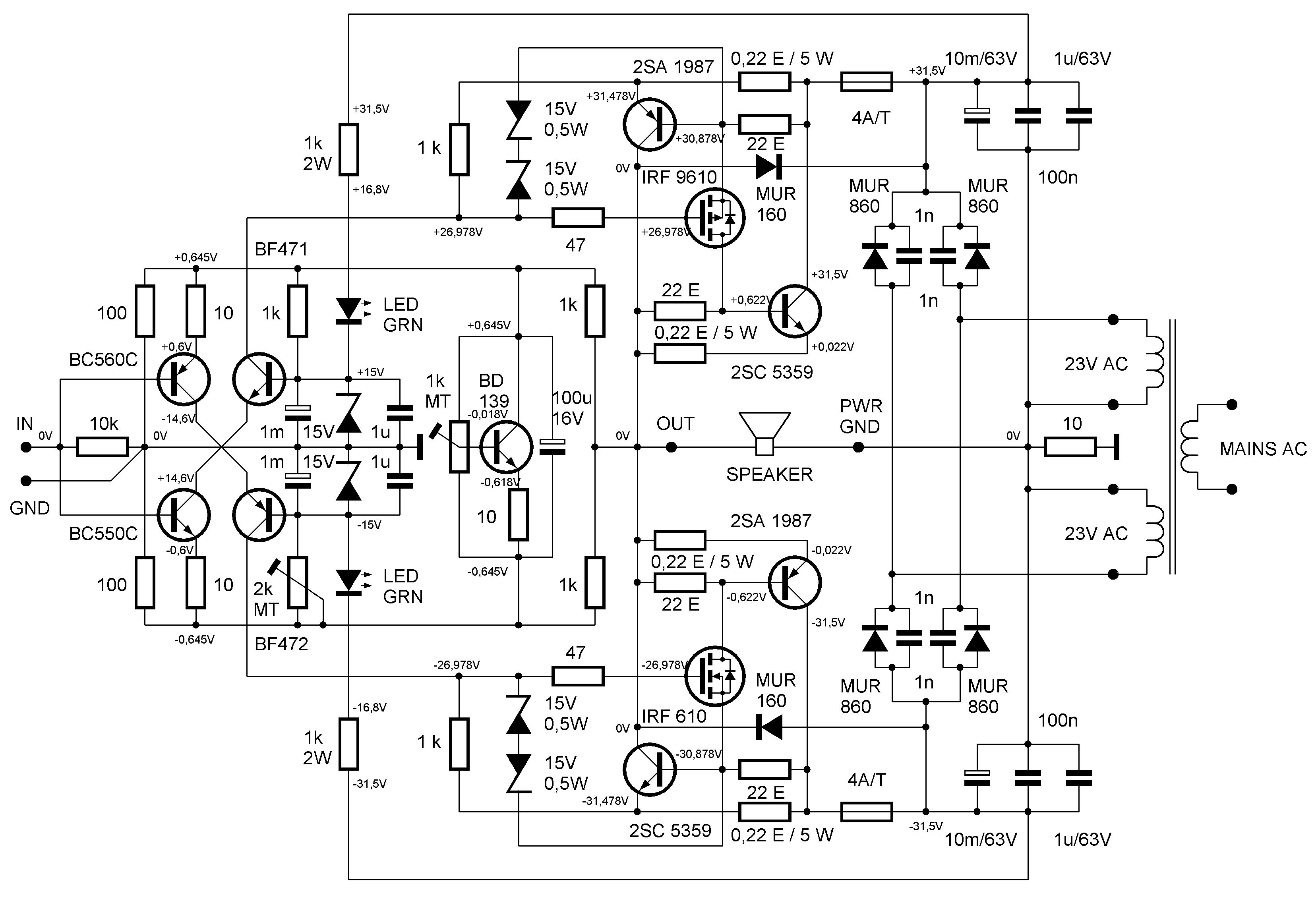

Similarities with classical current feedback topology exist of course, I would be foolish not to admit that, but some guys here would like to sell me that SSA is the same. Mistake. I have to disappoint them in a major way. It is not. In the past I tested those classical current feedback schematics they posted above as a proof of copying. It was always disappointment listening to those creatures, I never liked them at all, never satisfied with the sound coming out of a speaker. :no:
So I put the SSA in action. :bulb:
SSA is unique idea because there's no existing amplifier's schematic the same, similar like the ones posted, but not the same. SSA is evolution from that point on. The major advantage of SSA principle is in merging, using a single gain device for feedback, modulation, differentiation and bias in a balanced bridge configuration. Everything is locked inside, it also has locked - unmatched sound signature (proved already by forum members, many ask themselves how come) because everything is happening in a circle of a single gain device for all the tasks needed to create an amplifier, simple and profound. Everything after this stage is just impedance matching till the output pins. Still important, like BIGBT output stage, but not crucial to get a perfect SSA sound. :cloud9:

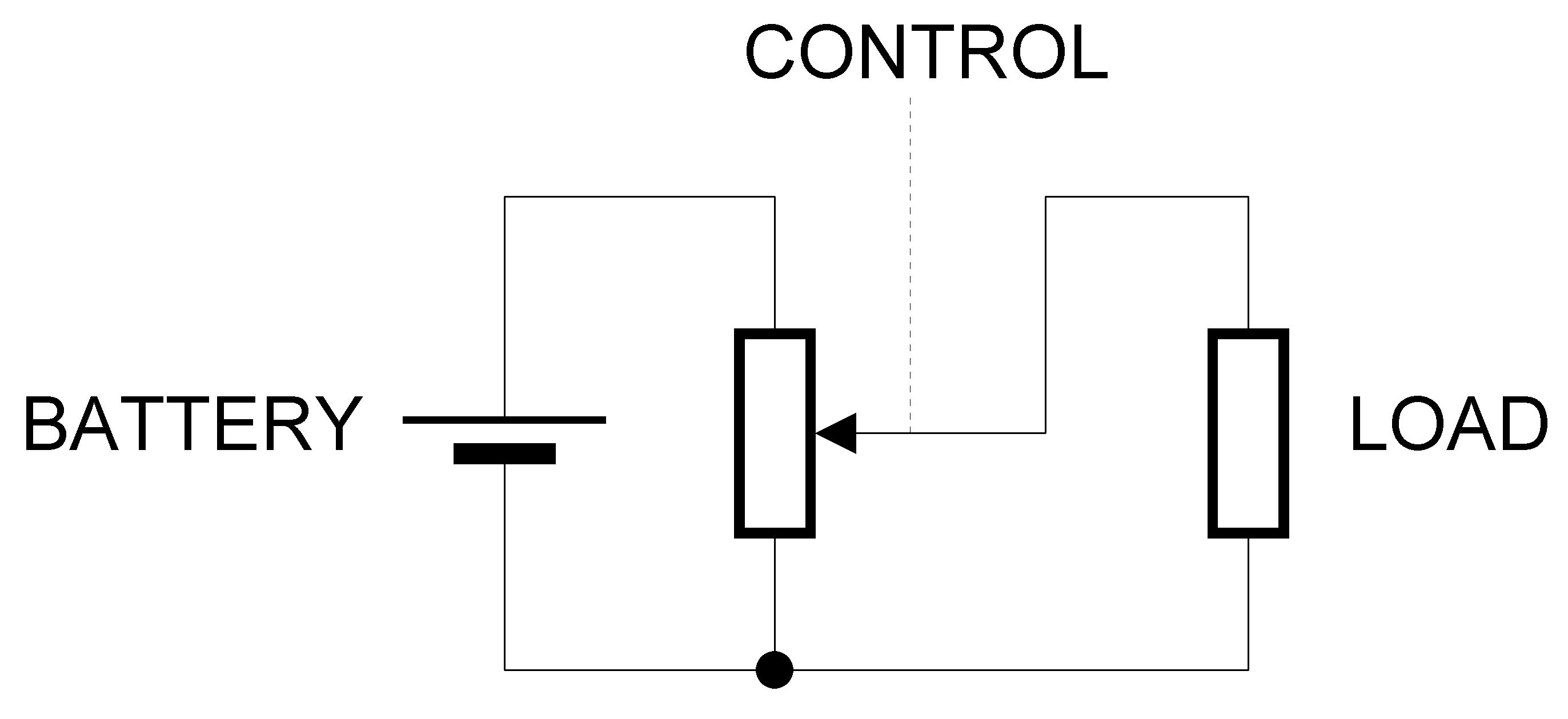

I don't see anywhere in the forum anybody giving a credit to a guy who invented principle of controling current flow, basics of all linear amplifying circuits. 🙄
P.S. Triode tube came long after that ... :yes:

I'm assembling an amp with Thermaltrak output devices. I played a little with Roender's output buffer, but decided that the thermal compensation was going to be tricky, with too many interacting elements (to many for my skill level, anyway). So I'm going to work with Andrej's Thermaltrak design.
Question: Any benefit from paralleling a few BC550/60 devices for the driver, as opposed to a single lower gain device?
