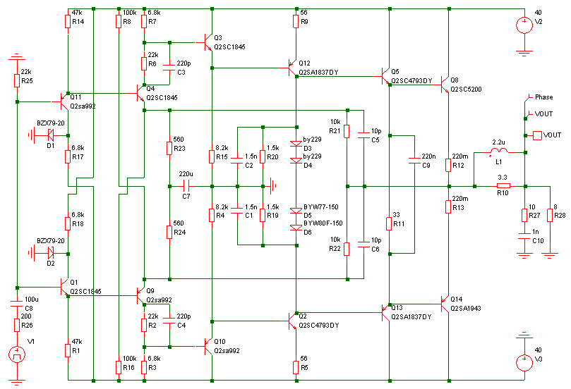

OK in this case you just have to calculate or measure maximum current value through that chatode resistor at max output amplitude. The same amount of current has to be provided from output via feedback resistor to get zero differential error current on that pin at that output swing. With choosen value of this feedback resistor and its voltage drop in ratio to voltage drop on chatode resistor, you will get voltage gain of such current feedback topology.
I had chosen low impedance 1k2/68r feedback resistors and used leds to provide the proper cathode bias voltage above the injection node which are very low AC impedance too and bypassed. Hmm, CFB then... that is why I get 0.017% THD and 235kHz -3dB at 1W from a transformer output tube amp, and ~100dB distance to noise floor.

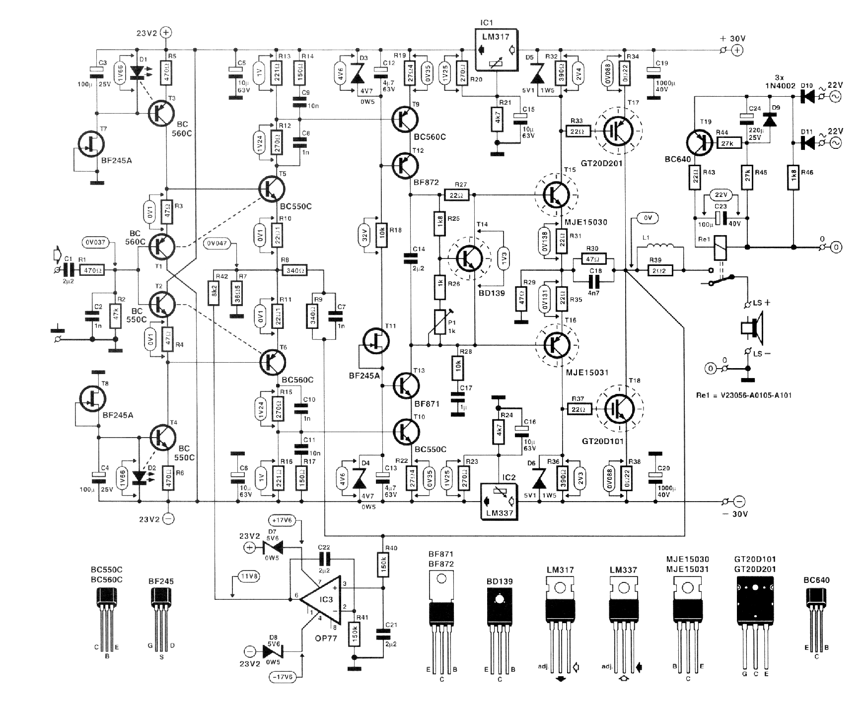

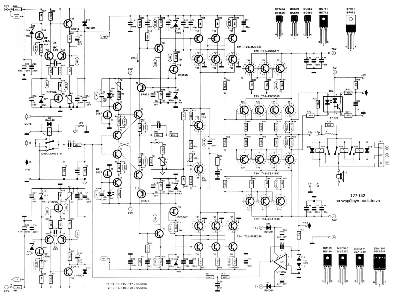

The first solid state Current feedback power amp i've heard about was an Analog device study from Mark Alexander: http://www.analog.com/static/import...tes/58052492001115525484056221917334AN211.pdf that i tried at this time (AD was offering an evaluation board to his clients).
I knew only two solid state commercial power amps using current feedback (One from Mark Levinson), and only one or two DY .( One from jean Hiraga,).
None of them are using the SSA symmetrical CR implementation, and the only similar one i can refer too was the F5 from Nelson Pass:
http://www.firstwatt.com/pdf/prod_f5_man.pdf
I'm very curious to see what i've missed.

Similarities with classical current feedback topology exist of course, I would be foolish not to admit that, but some guys here would like to sell me that SSA is the same. Mistake. I have to disappoint them in a major way. It is not. In the past I tested those classical current feedback schematics they posted above as a proof of copying. It was always disappointment listening to those creatures, I never liked them at all, never satisfied with the sound coming out of a speaker. :no:
So I put the SSA in action. :bulb:
SSA is unique idea because there's no existing amplifier's schematic the same, similar like the ones posted, but not the same. SSA is evolution from that point on. The major advantage of SSA principle is in merging, using a single gain device for feedback, modulation, differentiation and bias in a balanced bridge configuration. Everything is locked inside, it also has locked - unmatched sound signature (proved already by forum members, many ask themselves how come) because everything is happening in a circle of a single gain device for all the tasks needed to create an amplifier, simple and profound. Everything after this stage is just impedance matching till the output pins. Still important, like BIGBT output stage, but not crucial to get a perfect SSA sound. :cloud9:
