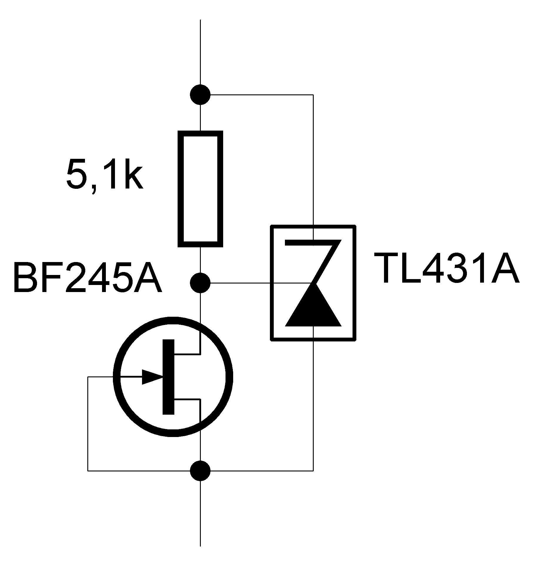

LC, it seems although it reduce the variation of DC Iq, but it also reduce variation of AC signal. SO I guess it is a local feedback, preferable to get another system which only disturb DC portion or thermal.
I'm thinking of making a heater(attached to heatsink) that will activate whenever the Iq of driver is lower than 5mA or so, is it possible ? I'm thinking to use a relay series with driver's emitter resistor, but coil within the relay would form a inductor that cut-off HF or so....
Not likely. :D
Perhaps something like this would help. :rolleyes:
