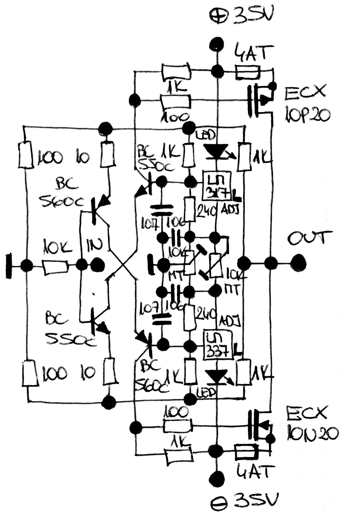

Can you make sim as proposed, turning the output mosfets to IGBT's? 🙂
Yes I can. Which ones did you have in mind?

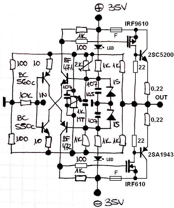

... or maybe just add this output buffer in microCAP to see if THD will lower substantially. If yes than we'll know that current feedback amp basic configuration cannot be easily to overcome. 🙄
Nice, but with HEXFET + BJT output stage the thermal compensation circuit (Vbe/Vgs multiplier) will have to replace the simple 1k trimmer...
What about a low power version for headphone use?
No problem it can be voltage/current scaled down and used with BC signal transistors only and IRF's at the output. But please wait untill we set the right topology with lower THD levels, than any version can be properly settled and calculated. Just wait what Nico will say ... 🙄
Lazy Cat that does not work. You substituted a Lateral MOSFET with a HEXFET. Biasing it is impossible. It switches between 22pA and 82 Amp. I will have to analyse it properly to find the solution. But personally I do not know why you want to mess with the schematic, rather make some real life measurement of what you have and give it a good listen. I will do the same during the week. I remain confident in what you have here is a very good amp.
Jaycee, a low power version is feasible, but you cannot just scale it. You would probably use BD139/140 for the output devices and run it off a +-6V supply, but there would be a number of value changes required. SIM predicts that it could work quite nicely as a headphone amp.
I know, you would need source resistor to stabilise IRF's drain current but it works perfectly cause I have tested and listened them. Now I know that my BIGBT's acted like an output buffer so distortion was infact low in my test amp. I have 100mA per each output BJT and it is very stable, also as you can see in previously posted pic that there is no heatsink at all and I could listen exact BIGBT combo for a few minutes before temperature went over 60°C. 😱
The problem is that I write these lines from the sea and can not perform any tests right now, only communicate. 😎
OK we'll try to stick to basic sch, fine tune the values and than make PCB. 😉
As you probably know common topology to all current feedback amps is similar and combined from an input current diff amp, I/V conversion and output buffer, so the last is somehow missing in our primary sch. 🙄
Lazy Cat, Don't get carried away now. We can reduce THD by two orders of magnitude by using a pre-driver, very little change and remains simple. I am going to bed now but will do some more work and let you know.

PSSR enhanced version
As the sea is rough today I found some time to draw PSSR enhanced version which already includes BIAS and OFFSET trimmer control in a simpler manner. Better PSSR is achieved by LM317/337 L series regulators (100mA output current version) enables -80dB ripple rejection on their outputs. Proper bias regulation is made by changing their output voltages symetrically and offset by balancing their output voltages according to GND. So only two TO-92 devices were implemented instead of zeners but with much more stable amplifier DC conditions and elegant BIAS-OFFSET control. 😉

I do think the same as Nico.... i found second and third ideas
worse in the simulator....now more second harmonics...the first layout was the best one in the simulator..of course real world can be different.
I have just simulated the third one...this one you publish a few minutes ago...was the worst one in the simulator.
