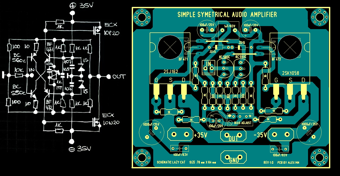

I have started with a PCB design and put the BF transistors on the ouput pair heatsink. Would it help in thermally coupling the input pair?

PCB ready rev 1.0
...... of course I have layout the first PCB 🙂 not sleeping yet 😴
Alex.

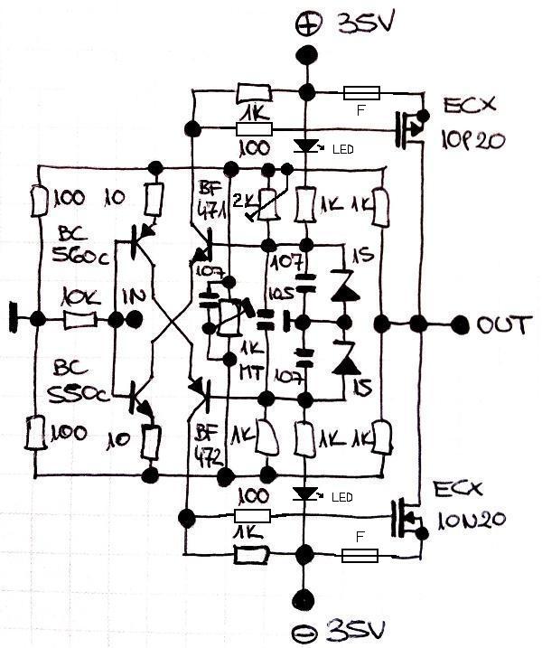

QUOTE=Salas;2662170]R1K under J162 better be 1K2 and paralleled with a 10K trimmer for offset control?[/QUOTE]
Yes we should put some offset control to the circuit, but the resistor changed to 2 k/Muti Turn trimmer should be according to sch attached. In this way we eqalize the currents through the input pair and balance them properly to get zero DC at output.
Also 100 ohm gate stopper resistors are there on the sch to provide some gate capacitance compensation, also to balance their values to fine tune different mosfets to VAS and to make any sound experimenting easy.

An offset control should be on a final PCB IMHO. Now Alex can see the recommended way. Thanks. Are the Zeners well filtered with 100uF by the way? Takes either say 100R series resistor with each Zener to make it easier for the caps to filter more noise or bigger straight lytics to really quiet them down in my experience. Maybe he can add on final PCB too?

What a smart PCB layout, very nice indeed. Thanks Alex. 😉
As you can see some small differences took place on the sch so the board will change a little:
- gate stopper resistors added
- 2 k/MT trimmer for offset control
- two LEDs for rails power control
- fuses added
- input pair should be together with flats
- a little more space-room around BF's in a case they are vertically positioned
Please, one more 6,3 mm faston GND connection should be provided on PCB. Also the GND connection to the input should be routed directly from PWS GND faston point on the PCB to the input, where you connect 10 k together with two 100 ohm feedback resistors.
So far enough changes but Alex please stick to the approximately the same layout like it is now. Thanks again. 🙂

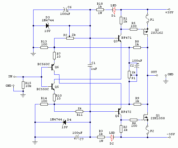

Feedback loop DC supply current through LED and 1k is app. 20mA. 100Hz ripple filter is formed by 1K/100uF parts who's time constant is app. 63ms if the capacitor would be ideal. There is a possibility to experiment and alter its value to max. 1000uF/16V low ESR cap to surpress the ripple to uV region on +/- 15V DC potentials, otherwise turn on phase would be just to long. So observation with scope can define the right value of these critical caps. 🙄
OK, since the schematic has been changed, let's change the "more legible one" too. Also, I propose to use the 1W parts for R3 & R18 since they dissipate about 400mW (20V * 20mA).
