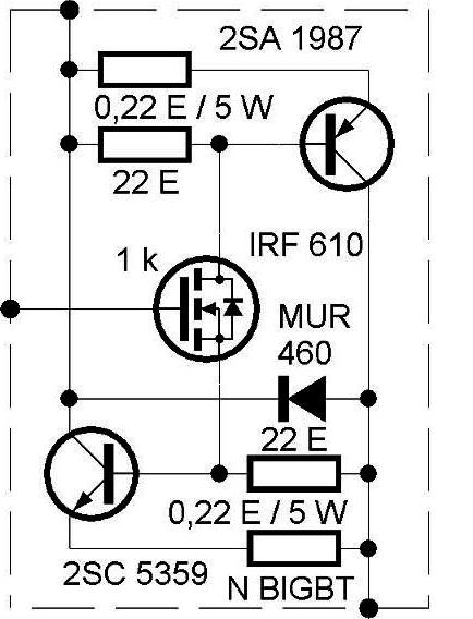

Maybe the use of IRF610/9610 as drivers to power BJT outputs would give much better results (higher transconductance), since this would not complicate the sch to much?

Can you make sim as proposed, turning the output mosfets to IGBT's? 🙂
Yes I can. Which ones did you have in mind?

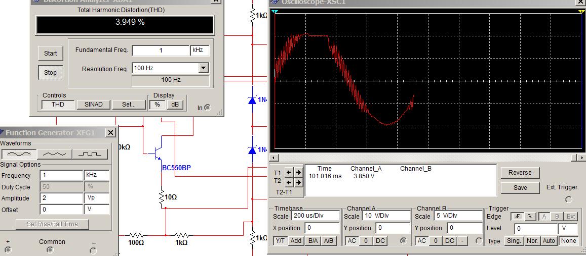

I found it a little bit strange.... my simulation show it becomes very unstable
if you try to overdrive...needs huge current in stand by mode to operate fine...... distortion was big in my simulations 0.026% THD....maybe i have made something wrong.

Something like that for the outputs, as these were inside my test configuration 😉
Would it give any better THD results?
Something is wrong with your sim model or so, because in practice tests I couldn't make it oscilate in any load circumstances. Very stable design, only we have to lower THD a little bit. 😉

Using two series connected diodes instead offers best results. I used 1N4004. Lazy Cat, you want to actually make an IGBT? In my humble opinion, I don't think that making it that complex is worth the effort. You have a good amp here it will satisfy most.
Calos, I think there may be a problem in your diagram. I have not checked the re-captured diagram but I work from Lazy Cat's pencil drawing, re-capturing schematics easily produce errors. This amp overdrives cleanly and symmetrically, I cannot find any fault with Lazy Cats design besides it not using 100 transistors and does not have fractions of a percent distortion.
IGBT's from Toshiba GT20D101/201 are non complex change if they would make a justified improvement.
