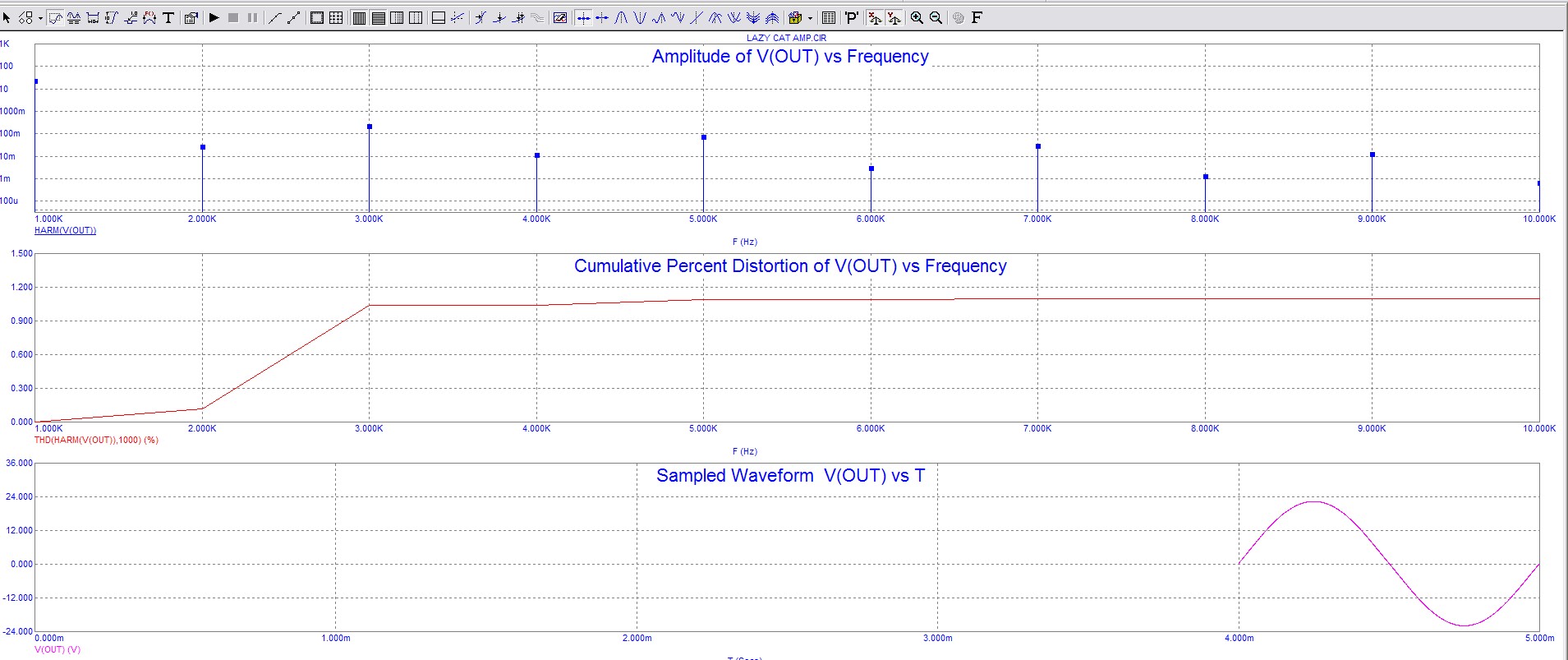

.........Increasing the quiescent current to around 1.2 amps does change the order to even and lowers THD from 1.6% to 0.4%
.... I should have qualified it, at an output swing of 24V peak.
this is 84W of output dissipation for a maximum ClassAB output of 36W and about 24W of ClassA into 8r0.
You are suggesting a very high bias ClassAB amplifier.
Hi Andrew, as I have said the artifacts are very high and odd order while running it in class AB, in other words low quiescent current.
Pushing it into class A works nicely and all the odd order stuff goes away. In my opinion it will make a rather nice class A amp.

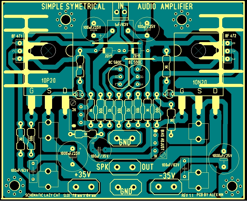

Ready PCB rev.1.1 acording to new schematic
...... few minors changes , and you can see the new PCB rev.1.1 :)
It was my plesaure to do this board , but can be layout again if not ok ;)
Alex.

OK, since the schematic has been changed, let's change the "more legible one" too. Also, I propose to use the 1W parts for R3 & R18 since they dissipate about 400mW (20V * 20mA).
Thanks for the sch drawn and corrected, maybe it is really more understandable to someone than mine. Since I am on vacations I couldn't make it in P-CAD so hand drawing was a nice alternative. :)
I agree for those resistors to be 1W although standard 1% metal film are specified to 0,6W but for the board layout it is better if there is a space to place 1W resistor. ;)
Odd order artifacts is a little on the high side. H3, 5, 7 and 9 contributes most of THD. Increasing the quiescent current to around 1.2 amps does change the order to even and lowers THD from 1.6% to 0.4%
When I listened to one channel the quiescent current was app. 200 mA and the peaks were within +/-10 Vp on 8ohm speaker. I admit I didn't notice any kind of distortion but certainly not that much you got from the microCAP. :confused:
Two steps can be done to improve the THD value in sim or in real:
Please try to place current sources instead of 1k resistors in your simulation, I mean 1k resistors supplying app. 15 mA current from +/- 15V to the emitters of the input pair.
Also one possibility to lower distortion is to use standard one BJT zener instead of only resistor for bias adjustment.
In that case we stabilise current and voltage around input pair thus enable them to work in nice linear conditions no matter the level of the input signal amplitude. ;)
Alex.
Your pleasure is our fascination. Really very nice board you've made here Alex, congratulations. :wiz:
For now please wait for some results of testing to see if there is some improvement we can make and than adjust the layout to final version. ;)

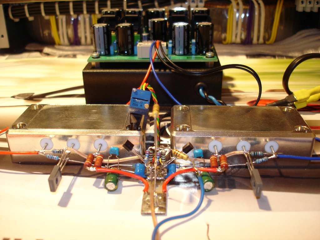

In my test rig as you can all see I used BIGBT power outputs which have low input capacitance of IRF610/9610 at the input and two powerful BJT's at the output. Maybe my BIGBT outputs are the reason for lower distortions and very pleasant musical presentation I experienced. :confused:

Lazy Cat, at what Iq did you listen to the amp?
Nico Ras, what is the distortion profile at 1 watt?
Thanks,
Hi Samuel
I get H3 sitting at 0.83% @ 1 watt (@1kHz and 2% @1 watt @ 10kHz.
Lazy Cat is right in saying he does not hear such high distortion. It is very difficult to hear distortion of 2% or more listening to music even-though you may hear this quite easily when listening to a pure sine wave.
I am not too perturbed about the high odd order distortion in this simple amplifier. In fact with the relatively high odd order distortion it would sound subjectively crisp and detailed to most listeners.
The amplifier frequency response is in fact very high with the -3 dB point at 2.35 MHz. The phase margin at 17 MHz is still great at 61 degrees, so stability is not at all a problem. It remains perfectly stable and no hint of oscillation driving pure capacitive load of 10uF.
The slew is 115V/uS and is perfectly symmetrical once the off-set has been nullified.
Overall, I would say a very worthwhile amplifier project for DIY, and attempting to turn it into "high-end" would complicate it far too much.
I would leave it as is. Well done Lazy Cat you deserve applause.

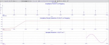

Lazy Cat,
I have run another SIM using only small signal transistors, THD dropped slightly to 1% at 10kHz.
-3dB bandwidth changed slightly to 2.018MHz but phase margin went up to 80 degrees and the slew rate improved to 156V/uS (interesting)
Power dissipation on the small signal transistors are <20 mW, so I can safely say that using BC550/560 through-out in the front is fine.
I have also briefly looked at increasing the gain. It is better increasing the value of the feed-back resistors to 2.2K than halving the shunt resistors as reducing the shunt resistor values introduces cross-over distortion.
