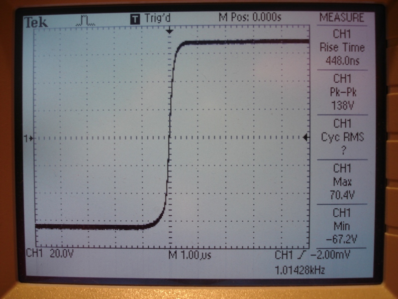

I know, look to my pic of my test bench, and there it is, Vbe multiplier sitting on the top of BIGBT. I know it is one more transistor in sch, but it works perfectly. As I metioned before, the BIGBT temperature went well over 60°C, because of the signal present on 6 ohm load at the output (no thermal runaway) without any heatsink, and bias current was still perfectly stable.

On the pic you can also see what is possible to get at the output of my simple symmetrical amp with BIGBT's incorporated. 😱

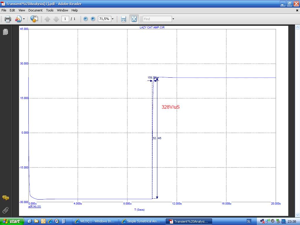

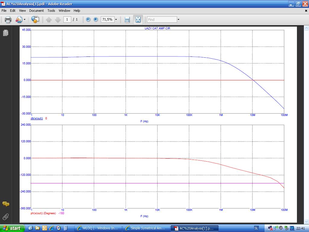

This graph Nico got from sim is somehow related tu upper plot or am I wrong. 🙄
Yes it is. Here is BJT driving MOSFET
OMG speed and stability, that's the way we like it. :c_flag:
So quite obviously for now BJT driving mosfet is in the lead, considering listening tests and sim performance. 😎
