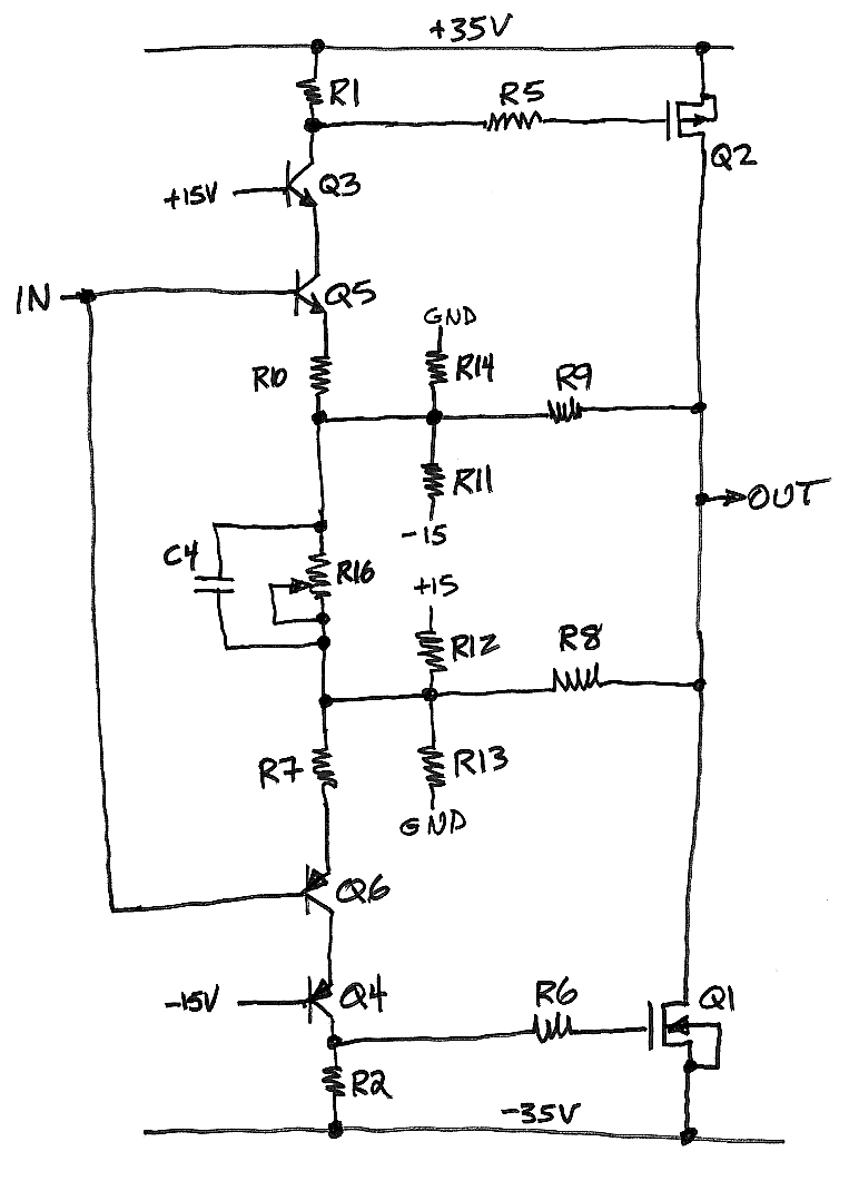

I redrew Juma's circuit schematic, one more time. The redrawn schematic (finally) made the circuit's operation obvious, to me at least.
  • It's a two stage amplifier, both stages provide voltage gain
  • First stage is a cascoded BJT common-emitter amplifier
  • Second stage is a common-source MOSFET amplifier
  • (R3, ZD1, C2) and (R4, ZD2, C3) create DC bias voltages of +15 and -15 for the cascodes
  • Negative feedback is applied to the emitter of the first stage
One surprise that emerges from this drawing but not its predecessors, is: capacitor C4 is connected across two nodes that are perfectly in phase. So the AC current flowing in C4 is: zero. I didn't realize that until seeing this drawing.

AAAAA-AND, the drawing prompts the question: What if the MOSFET output transistors Q1 and Q2 have different "threshold voltages" (VGSon) or different transconductances gm ? There doesn't appear to be a way to trim the positive (P-MOS) side, independently of the negative (N-MOS) side. Please, if I am mistaken, point out the error. Viciously and without remorse.

Yes there is 1,2V DC potential across R16/C4 defining bias conditions, but when FB signal modulation starts, this potential tends to change because R11 & R12 are not current generators and there is also a hFE difference in input pair, so to keep this potential unmodulated DC the C4 is needed as a simple solution. 😉
Please see the post #36 where R12 from you sch is changed with 2k trimmer to balance the circuit to zero DC offset at the output. 😉
