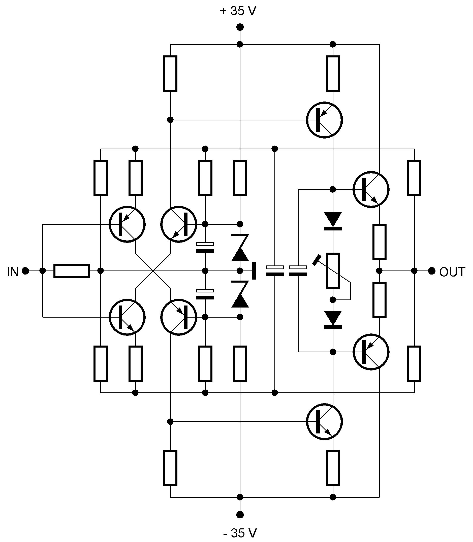

SSA complete BJT version

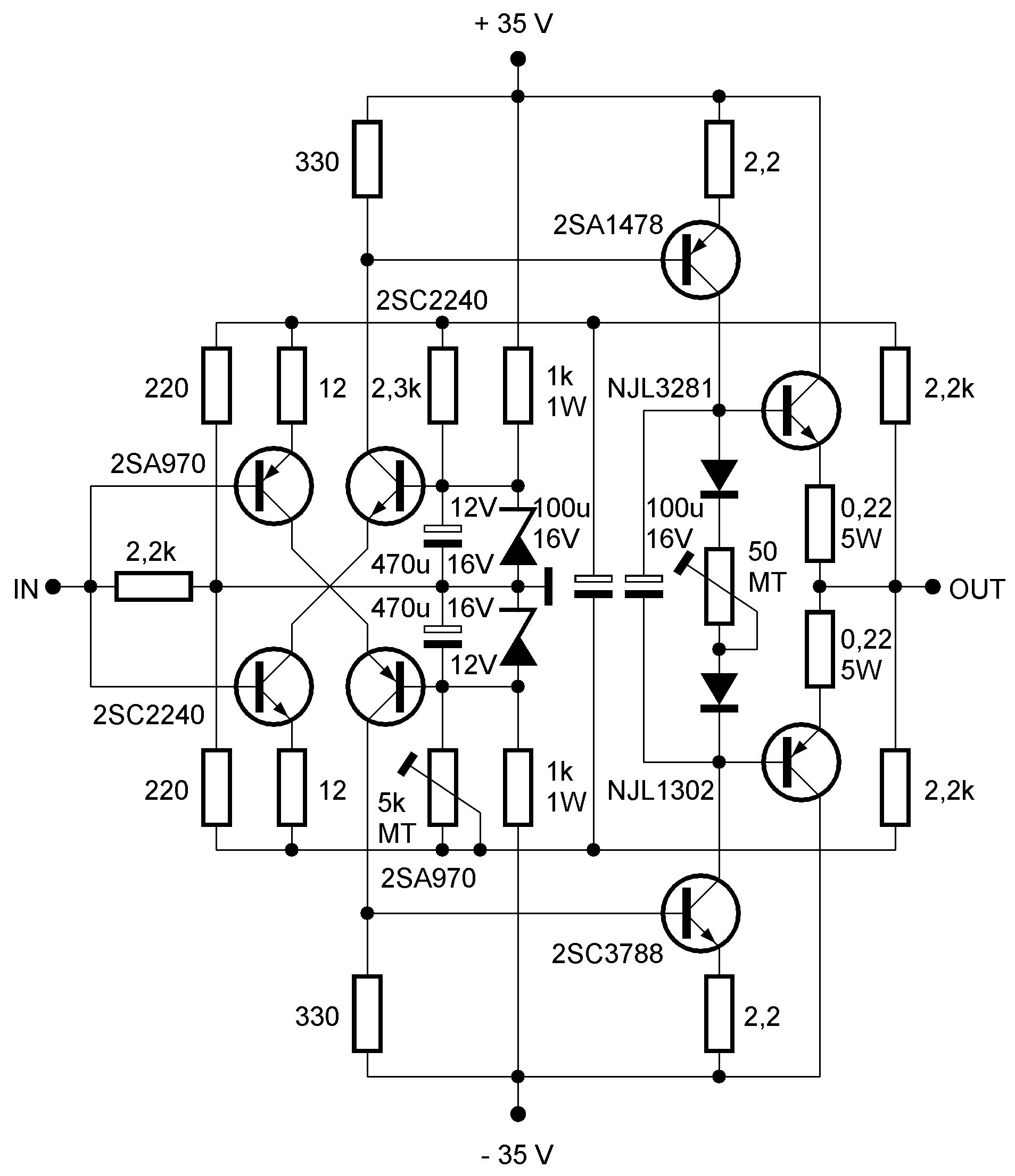

As we agreed with Nico that there should be three versions of SSA (Simple Symmetrical Amplifier), regarding output buffer, presented for listening tests:
- BJT driver/BJT output
- BJT driver/MOSFET output
- MOSFET driver/BJT output
Here is my sch proposal for the first one from the list. I intentionally left blanks for the values so we can have something to discuss about here. My only suggestion would be about the currents: input pair 2-5 mA, driver current 15-20 mA, output current 100-250 mA. Defining these currents will lead to proper resistor values, types of BJT's, etc. Any comments? 🙂

How should the 4 input devices be thermally coupled to gain best resistance to varying output with variations in ambient temperature and operational dissipations?
Thinking about Roender's amps, he used some diodes to provide some temperature compensation for the input stage. Can we gain similar performance advantages doing something similar?
Input stage is in a perfect temperature balance regarding symmetry if the two input BJT's are in thermal contact - tested. Cascodes are non critical, drivers should be separated from the main heatsink - small, almost constant power dissipation, outputs are compensated with Vbe multiplier, so thermally looking everything is in order. 😉

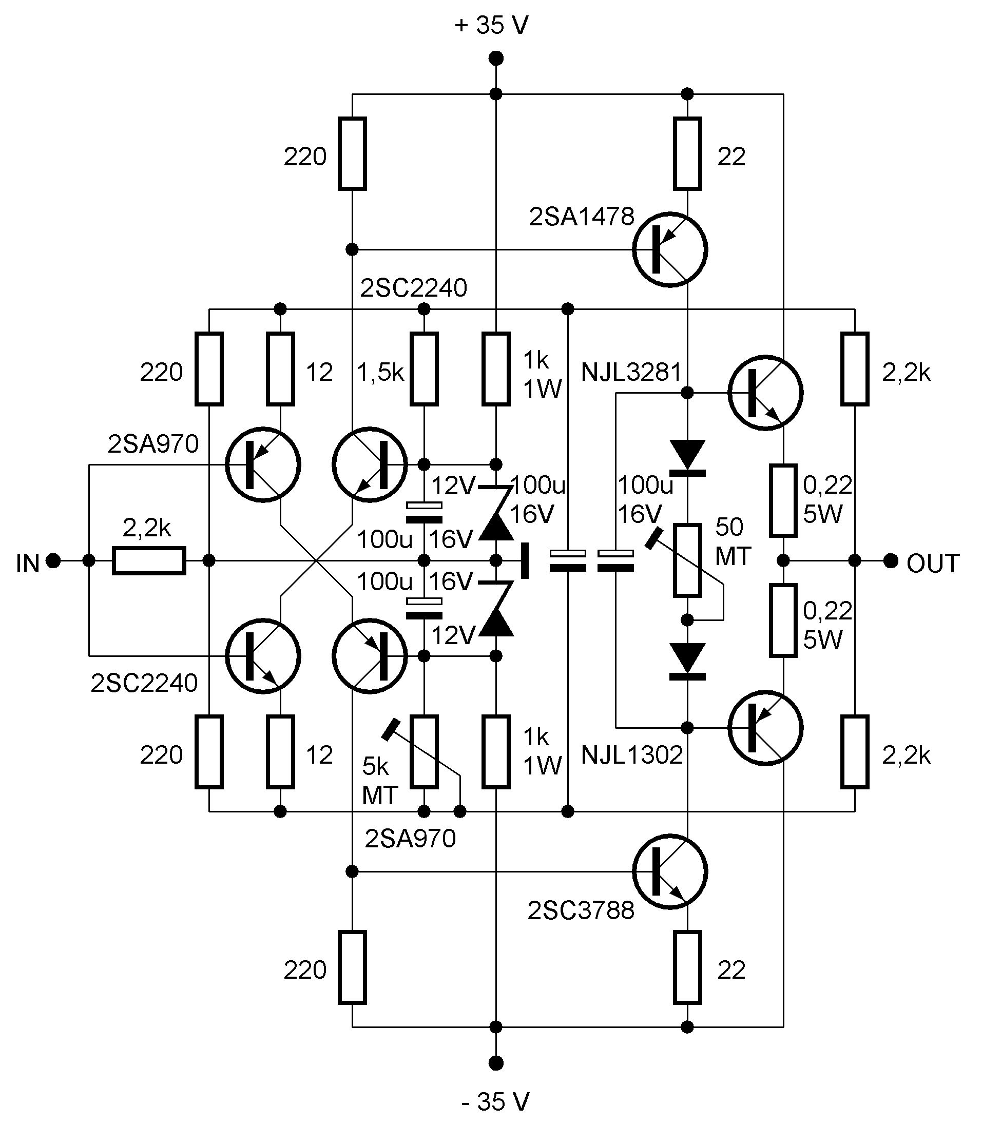

It will be even more popular with values given. 😀
So now in this configuration we have 4,3mA input BJT's collector current, 15,9mA driver's current and an output BJT's quiescent current adjustable from 0 to 1,8A. 😉

These values are of course discussable, cause now I see that the second stage (driver) voltage gain should be significantly higher, so substantial reduction of 22 ohm emitter resistance must be done. Recalculation in progress ... 😀

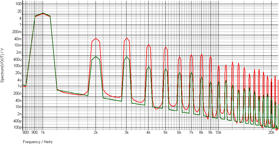

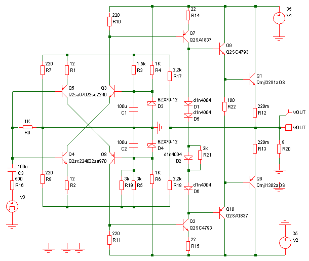

A good option would be to simply implement a double EF
as output stage , reducing THD efficently , as displayed
in the following graph.
IQ is about 0.42A in both cases.

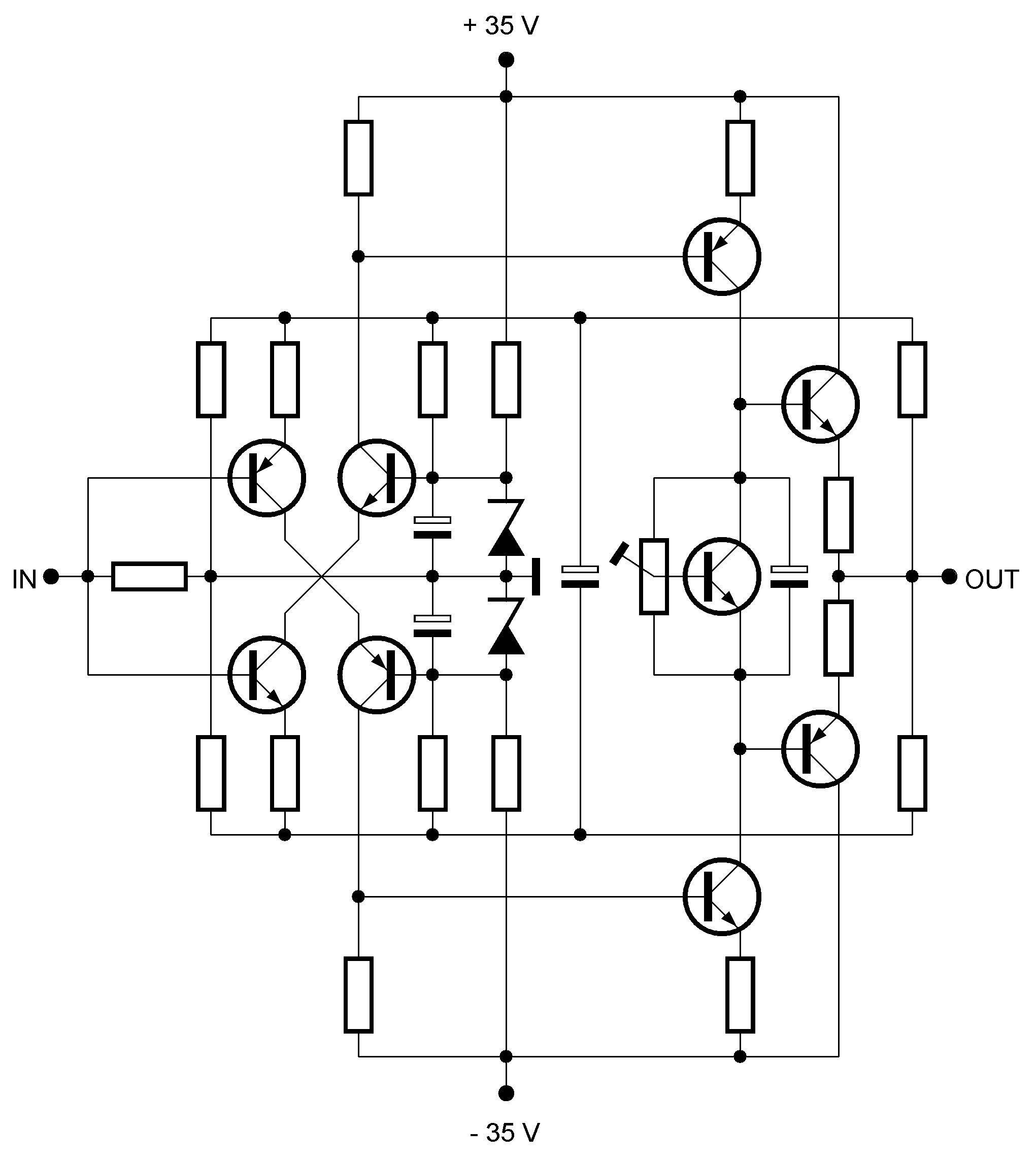

It looks in this concept with 8 transistors, lateral MOSFET output's would give the best THD figures, loading the VAS less than other versions.
MOSFET driver is another option, maybe ... the best solution of this simple concept lies in the right driver/output configuration, as we have already discussed here. 🙄
