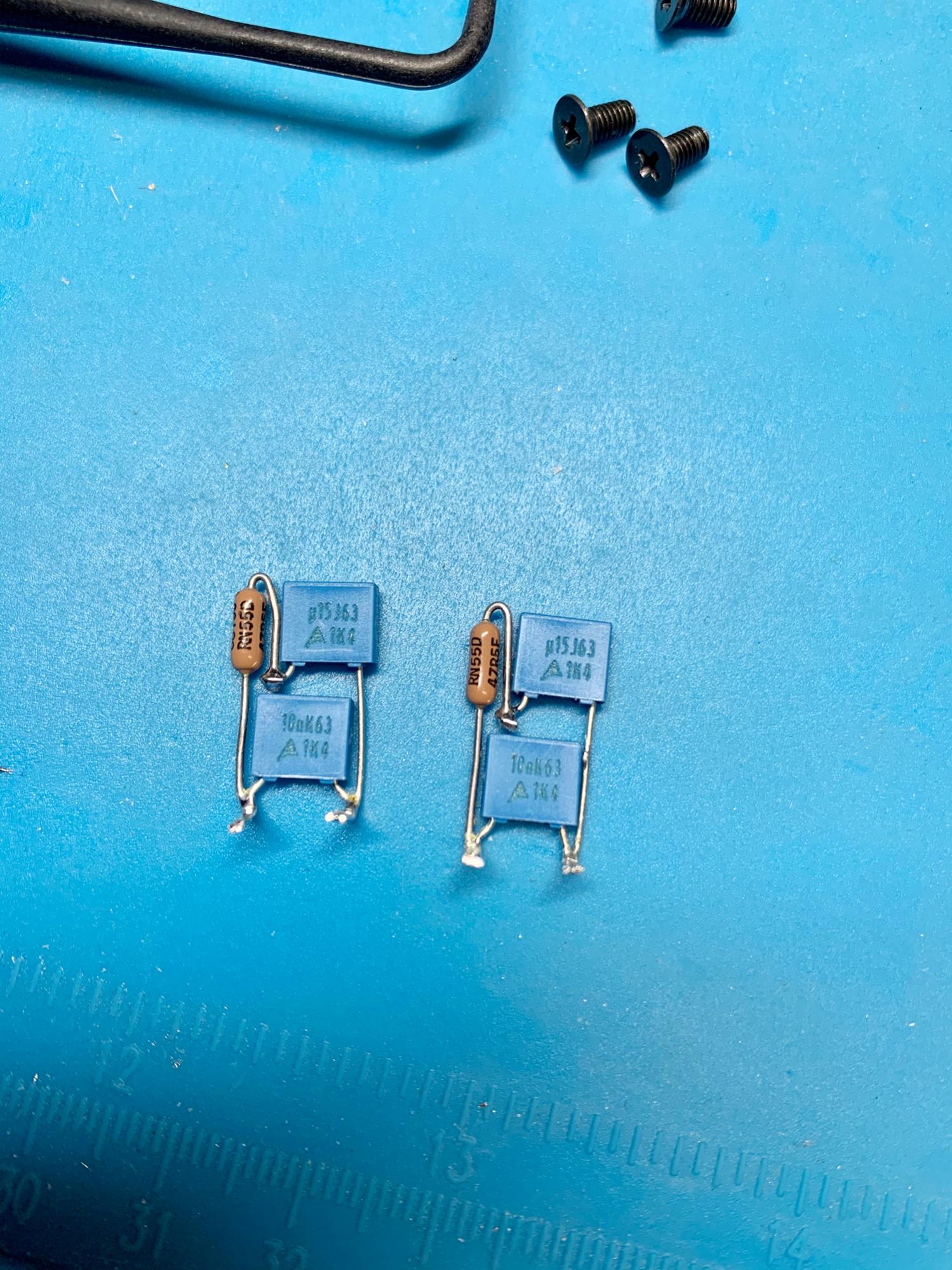

And I was also wondering if anyone had made a snubber for such a high voltage transformer.
I just got around to using my "jig" for the first time the other day for a high voltage supply. For the caps I prefer to use the Panasonic 1600V polypro parts (ECW-H16103JV for the .01uF). Largest value I had on hand for the snubber cap was .047uF, half the recommended 10X value. As a result took a little more resistance to reach critical damping (1.8K). Looks good on the scope. Haven't finished project yet. Proof of the pudding is in the eating. ;~)

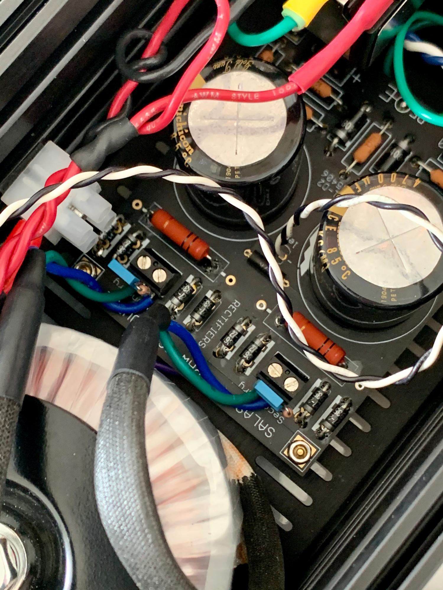

Per Marks post above #1784... here's a why not scenario.

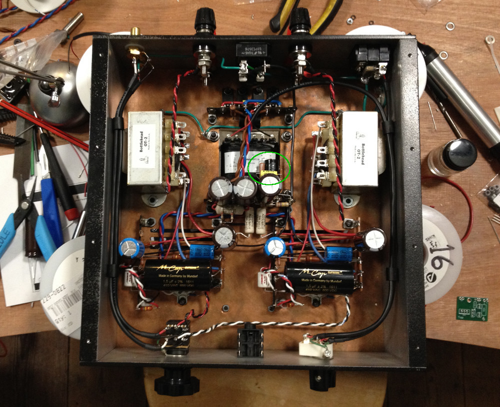

Learned from 6L6 that one needs no PCB to snub! Snubber hack-of-beauty on the power supply for the Salas phono pre.

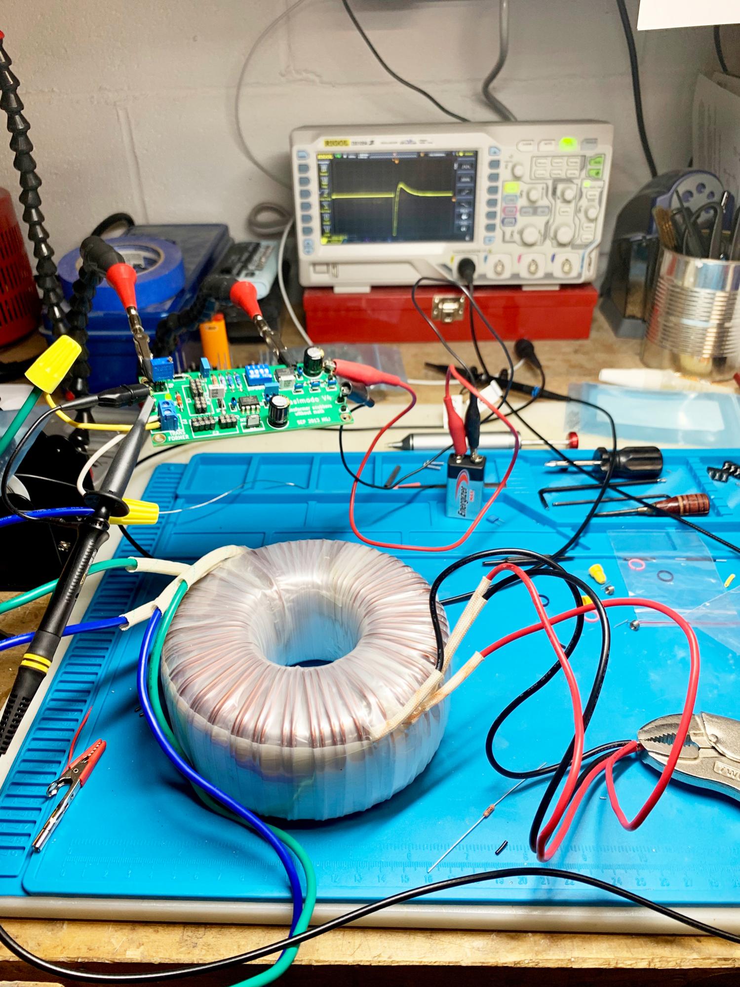

Also a pic of my first snubbing adventure 1am style having just received a scope and built the Quasi jig. That was an epic night of learning adventure!
Thanks Mark!
Thanks Mark!
Congratulations on your success, Patrick! Your scope photo shows a textbook perfect zeta=1 damping waveform.
When shorting out the other transformer windings, I prefer to twist the wires together and wrap the junction with blue painter's tape instead of using Vise-Grip pliers (!). But hey, if it works then it works. Nice job.

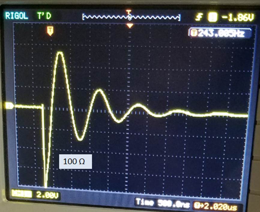

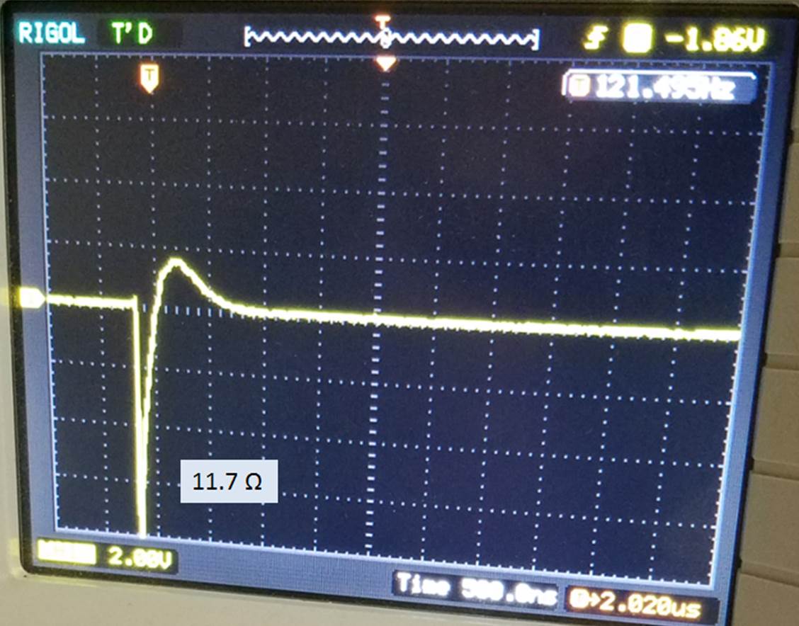

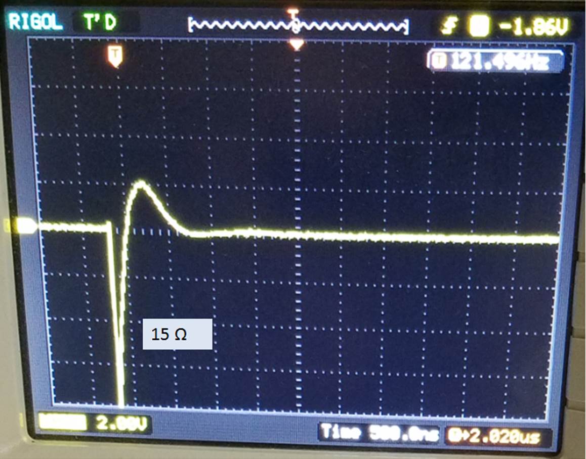

So I am a relative newbie making a first attempt at this snubber testing. The traces here seem to look OK, but the R values are low. This is an R-core transformer from a Hafler XL-280. It has 2 secondaries, both which share a CT. One is a high current secondary which gives rails around +/- 65 VDC, and the other is a low-current secondary which gives rails around +/- 75 VDC.
The photos here are measuring half of the high-current secondary, wired as the bottom example in figure 13 of the Quasimodo document.
Any thoughts?
Thanks,
Ron
Any thoughts?
Thanks,
Ron
