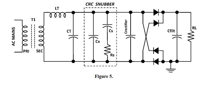

If I need Rs to be 10 ohms and my transformer secondary is putting out 9.6Vac RMS, then:
V = I * R
9.6Vac = I * 10 ohms
I = 0.96 amps!
The current passsing through my 10 ohm Rs will be 0.96 amps and I will need at minimum a 10 watt resistor...
Yikes!
It will also run my transformer a lot warmer.
Is this all correct?
I see Cs is in series with Rs - how much voltage is dropped across Cs? I would think very little.
Is it posssible to change the values of Cx and/or Cs to get a higher value of Rs? I tried this quickly and it did not seem to do much.

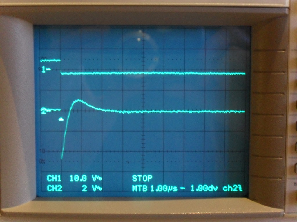

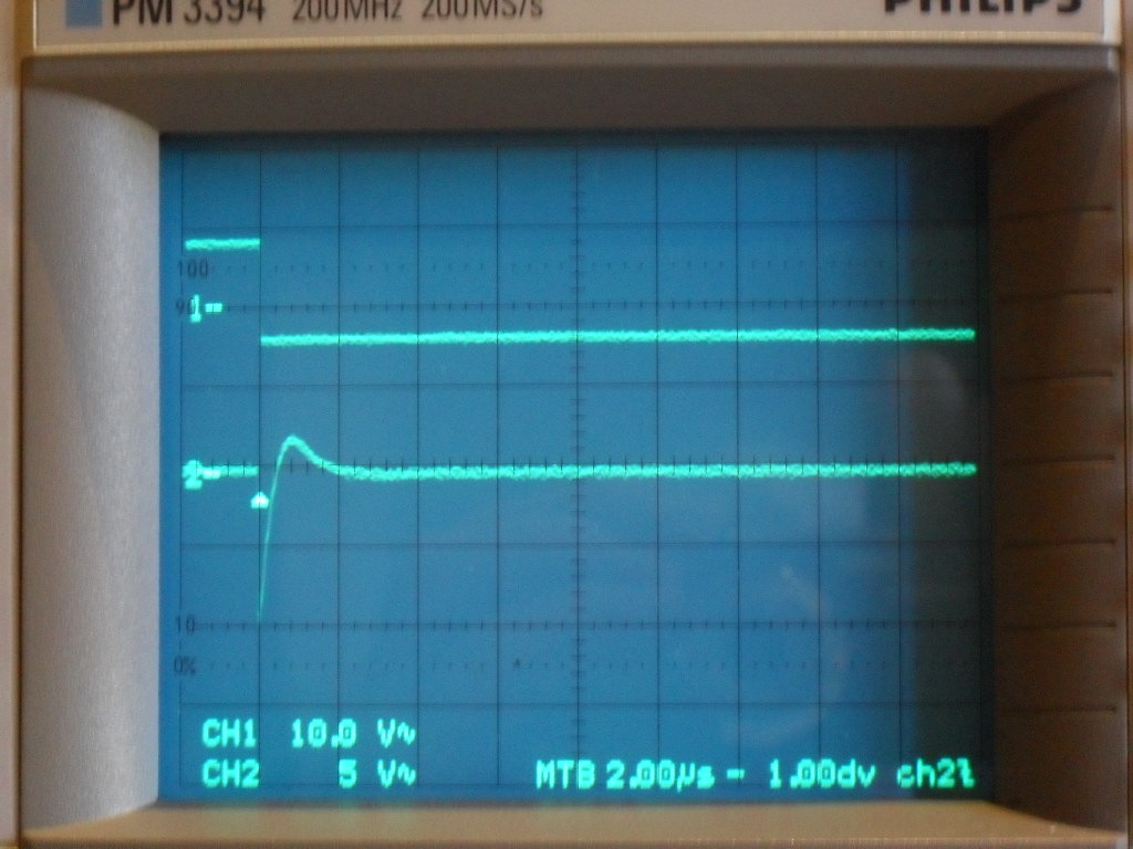

Hello Mark, hello all,
Sorry to all for my basic English......
I have try to learn and understand all about your Snubber calculate via your Quasimodo
I have search and buy a used Oscilloscope FLUKE PM3394
I have buy in this forum a good Quasimodo V4
And after a long périod to learn Oscillo.
I started to take measurements on transformers
Transformer was a 120VA(TOROIDY-SUPREME-AUDIO-GRADE-V2)....primary was 220v.....only one secondary was 20v
CH1=10v
CH2=5v(or 2v)
For obtain Zeta(ζ)=1 the résistor was 34.90 Ω
For Cs(C3)=100 or 150 or 220 nF the résult was the same, and the response curve is the same.....correct?
With Cx(C2)=10 nF and powered by a battery 9v
......I think until everything seems correct......
However I noticed something, in beginnig of this measure the résistor was 36.95 Ω
After one hour, two and three hours the value fell to 34.90 Ω
have you ever noticed this phenomenon...?
the PCB Quasimodo V4 does he need to heat..?
Thanks for all your works
And happy new year to all
Charles
Charles, congratulations on your success! Everything you observed is normal including slight "wandering" of the optimum. It's nothing to be concerned about, choose a fixed resistor within 10% or 15% of 35 ohms, and you'll have a critically damped secondary.

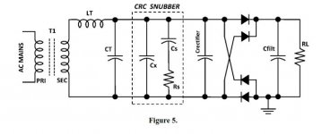

Hiiii Mark,
Thanks to your answer.

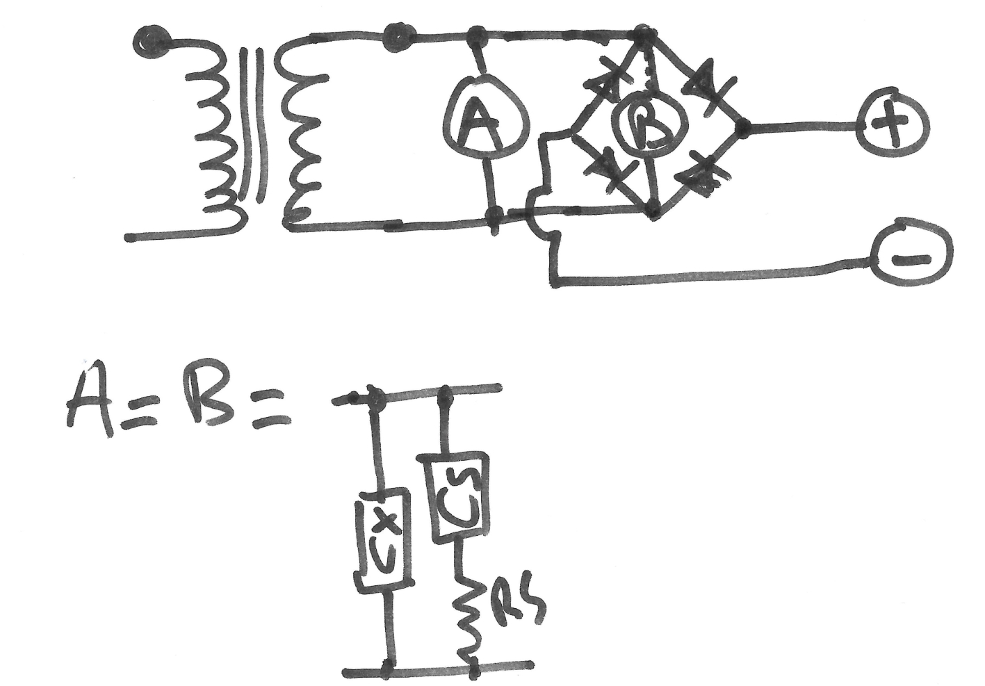

Now, for snubber implementation
What are the best implementation
A or B or other..??
In your opinion what type of diode would be the best..
I have
.HEXFRED:
.VS-HFA25TB60-M3 -VISHAY, 600 V, 25 A, 1.7 V, 75 ns, 225 A, TO-220
.SCHOTTKY:
.MBR40250G -ON SEMICONDUCTOR, 250 V, 40 A, 35 ns, TO-220
.DSA30I150PA-IXYS-Schottky Diode Gen ², 150 V, 30 A, 10 ms, TO-220
. Avalanche Type:
.IXYS-VBO25-16A02, 1600 V, 38 A
Or others
Regards
Simple, no-math transformer snubber using Quasimodo test-jig
Charly, there's your answer. You are snubbing the transformer not the diodes. Therefore: locate the snubber as close to the transformer as is reasonably possible. Pragmatically speaking, that's probably on the same PCB as the diodes. 🙂
Diode choice is a matter of personal preference mostly; choose whichever ones your wife likes most, or whichever ones will impress your audiophile friends most, or whichever are cheapest and available at your favorite diode seller, etc. Soft recovery diodes are a little better, but once you use a snubber to achieve zeta=1.0 damping, all diodes become equally pitiful bell-ringers. They all provoke the same amount of ringing: zero!
I've just closed out a Group Buy of a power supply PCB designed to drive two LM3886 chip amps (40W per channel into 8 ohms), its schematic is attached to post #1719 of this thread. For that chipamp application I chose Schottky diodes, because I wanted them to run as cool as possible. Diode power dissipation is (I_load x V_diode_fwd), and the power supply designer has no control over I_load. So the only thing left to do is pick a diode with very low V_diode_fwd. That's what I did: I chose the MBR10100G. It's "only" 10 amps and "only" 100 volts, which may not be big enough numbers for your needs.

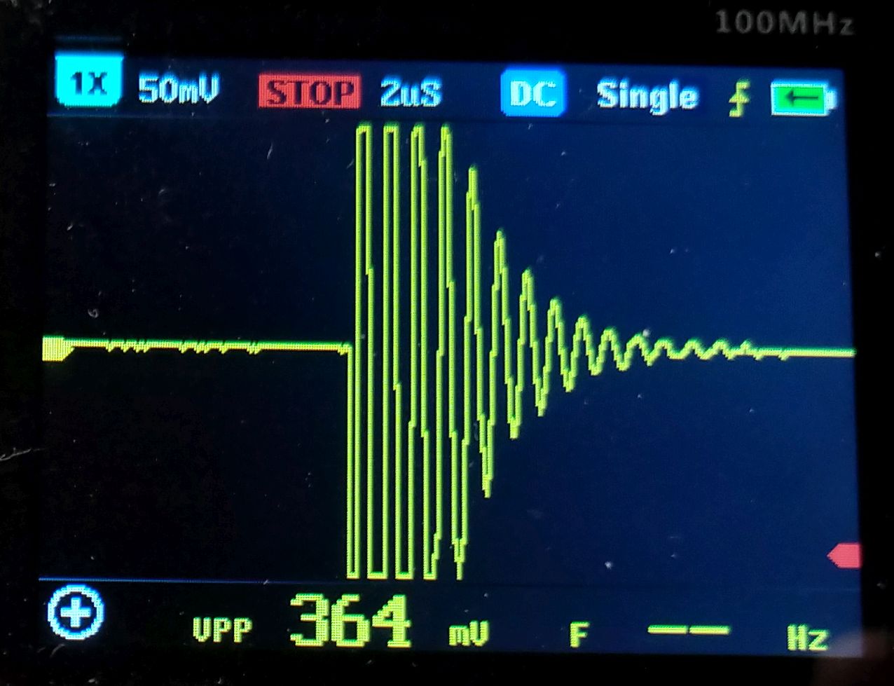

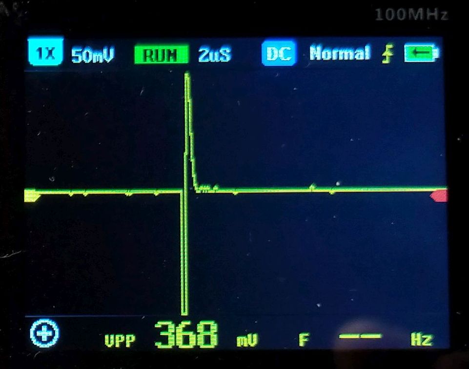

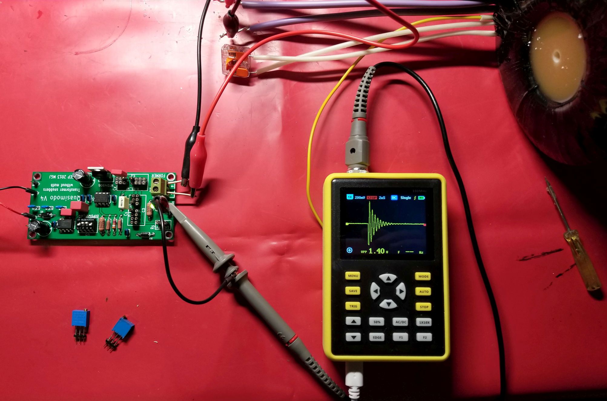

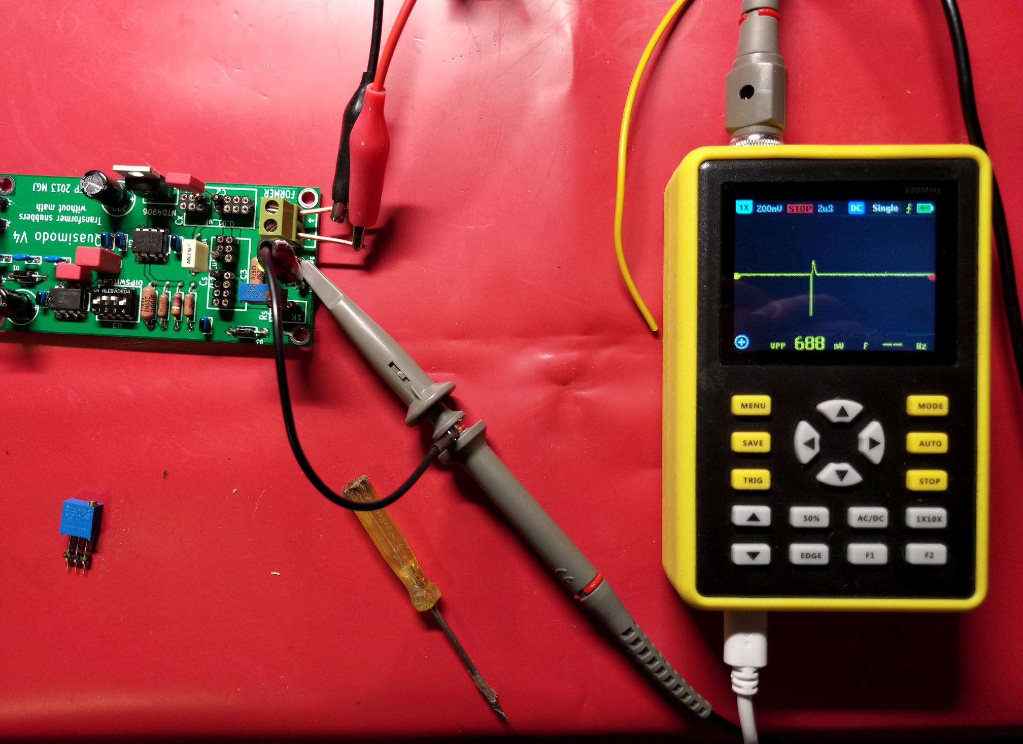

Mark, thanks for this nice Quasimodo test-jig !
It works great.
My 2nd scope is a very cheap handheld one,
surprisingly it's also usable with your test-jig.
Pic1: infinity resistance
Pic2: 10 ohm
Pic3: infinity resistance, v zoomed in
Pic4: 10 ohm, v zoomed in
Thanks to the dipswitch to select the oscillator freq I could locate a resonance on the cheap one channel scope.
The transformer is a Toroidy 230v/2x18v 400VA
Congratulations, danny_66! You've got excellent damping in the "after" pictures. Maybe you would enjoy the waveforms even more, with a faster horizontal sweep rate, such as perhaps 1 microsecond per division or even 500 nanoseconds per division. If your scope will sweep that fast and if it will correctly trigger!
My own experiments with the $19 "DSO-138" oscilloscope kit were a disaster: post #846
