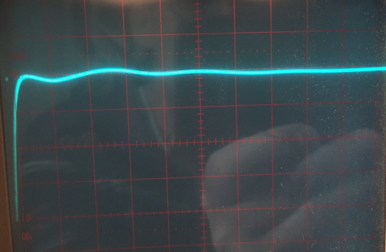

Yes, I tried a faster sweep rate but then the trigger function didn't work correctly.
I think that's too much asked from this cheap scope.
It was good for what you needed and did the job. 😉 Nice relsult and thanks for posting in the results thread as well.

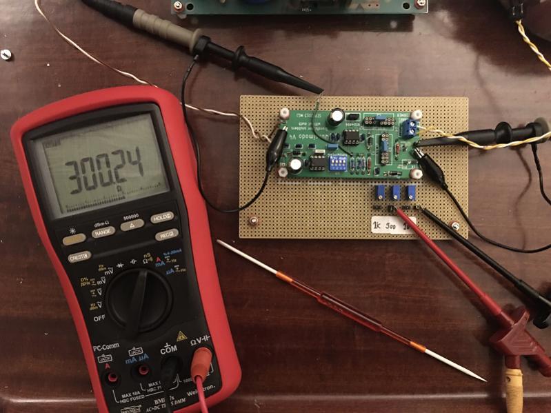

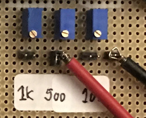

Hello Snubberfans,
maybe my Quasimodo based Testjig is inspiring to some people here...
Using the original Quasimodo I felt like I needed something more comfortable 🙄😉 :
- The Pot went onto a separate board which has jumpers to allow 1k, 500 and 100 Ohm Pots to be jumper-selected.
- Removing the jumper enables Rs measurement without unplugging the Pot
- The Trigger-connection is extended by ~5cm wire, so the Scope-Testhead can be connected more easily
- Having mouted Quasimodo and the Pot extension on a 100x160mm board makes the whole set-up somewhat more stable
See the pictures below.
Greetings,
Winfried

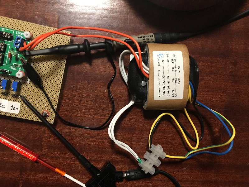

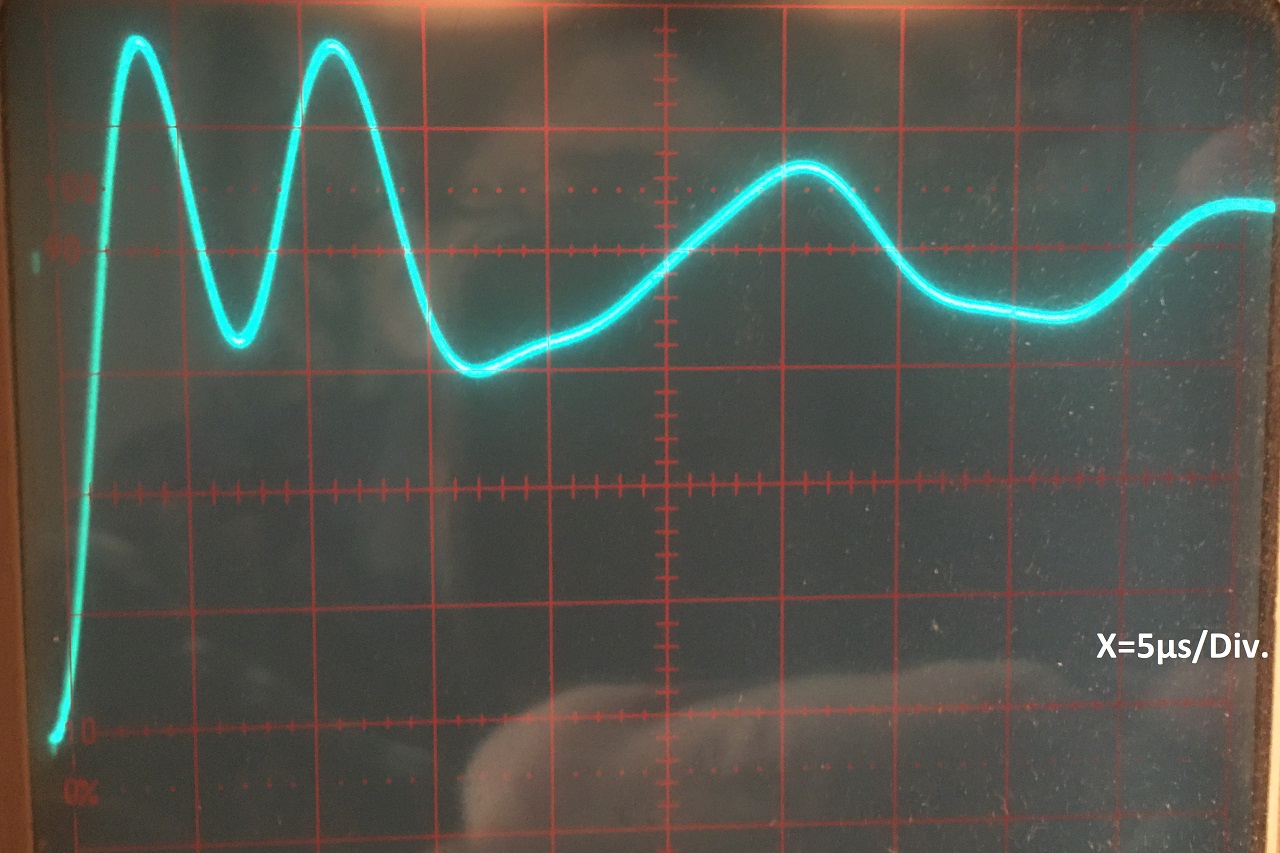

Thanks for the cudos dear friends!

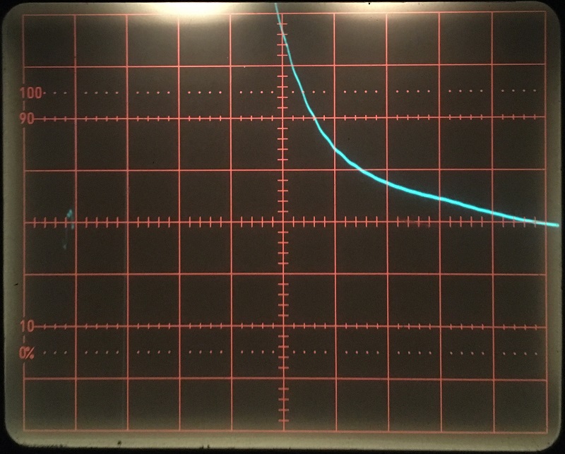

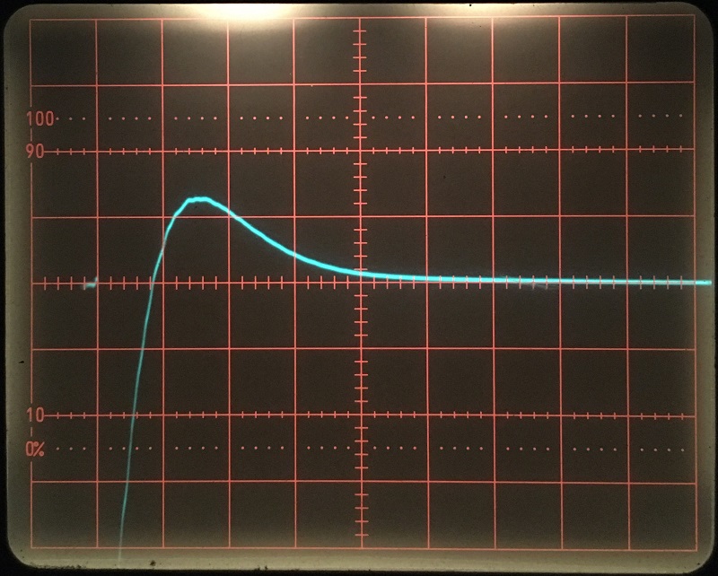

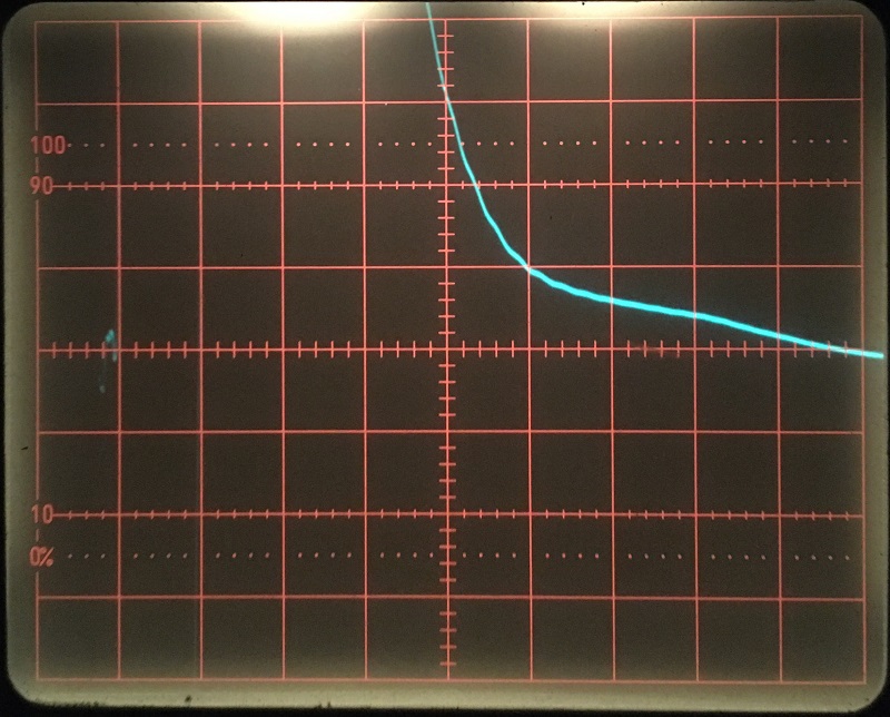

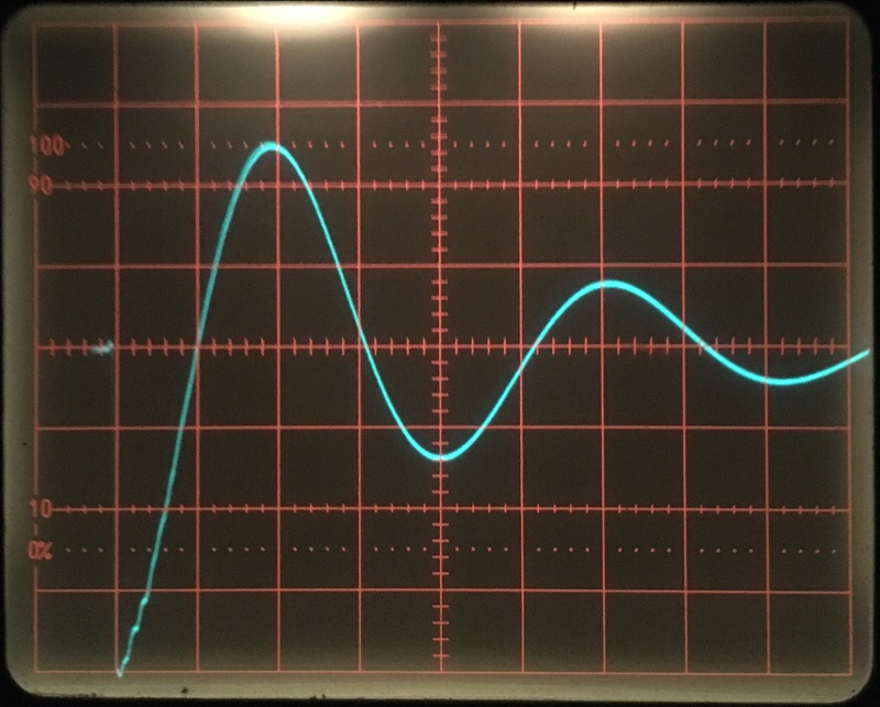

I did some measurements with an R-Core Transformer in the mean time.
The pictures show traces with open Rs, small overshooting (56Ohms) and without overshoot (17Ohms). well, I'm struggling with the optimization between the last two, because I do not get to the "quasi textbook" traces like some people have shown in the thread.
What may be wrong? Please provide some advice if possible.
Thanks and Regards,
Winfried
Thanks and Regards,
Winfried
@wgh
Man I thought you had it hooked up wrong, but I blew up the photo and it looks like you have it right, but something looks off there. I will wait for one of the others that know more. I wouldn't think either of those values are right... something else appears to be amiss.
When in doubt, leave everything exactly the same, but replace the transformer by a fixed inductor manufactured by a top tier electronic component company. Something between 40 microhenries and 400 microhenries, for example, any of these:
short-link to possible inductors at Mouser.com
If the scope display is still "ugly" then you know it's not the fault of the R-core transformer, it's the fault of your Quasimodo jig arrangement.
On the other hand if the scope display becomes clean and perfect, like Figure 3 of the Quasimodo .pdf document, with beautiful sinusoidal oscillation, then you know it's not the fault of your Quasimodo jig arrangement. It's your transformer.
I am afraid there is some chance that all the extra wires and connectors and flexibility you added to the bare Quasimodo board, may have accidentally damaged the signal integrity of the test fixture. If you get lousy results with a known-excellent inductor, that's proof your fixture needs improvement.

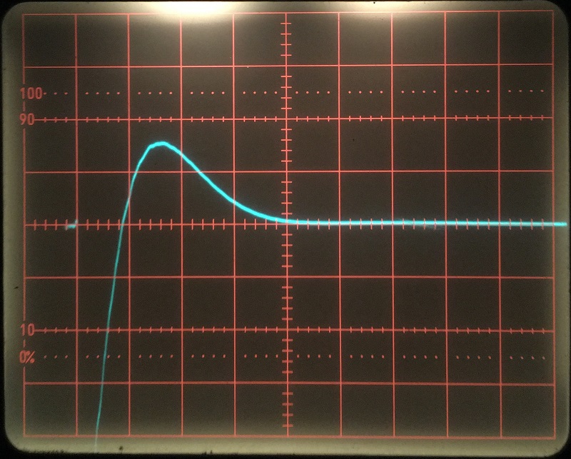

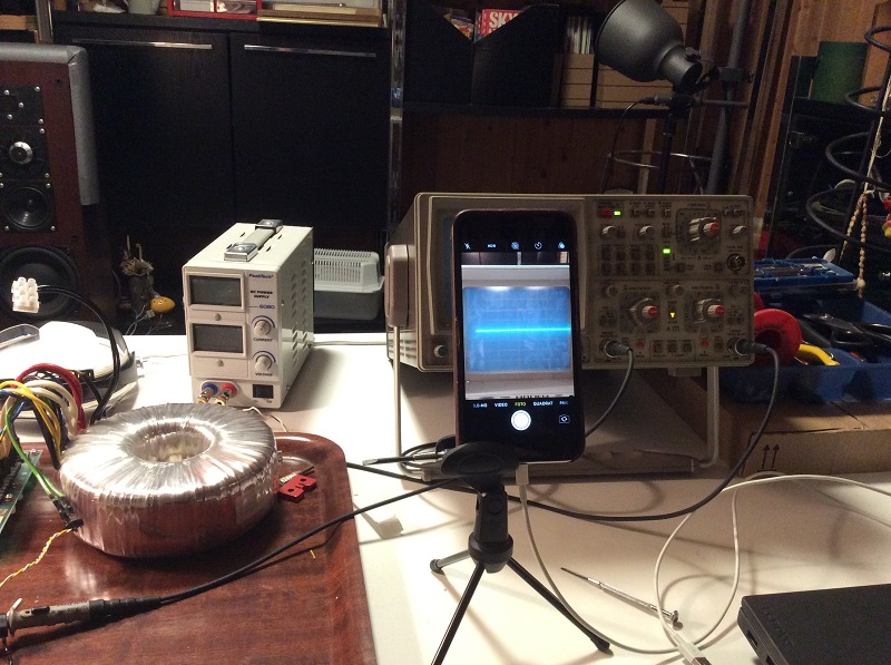

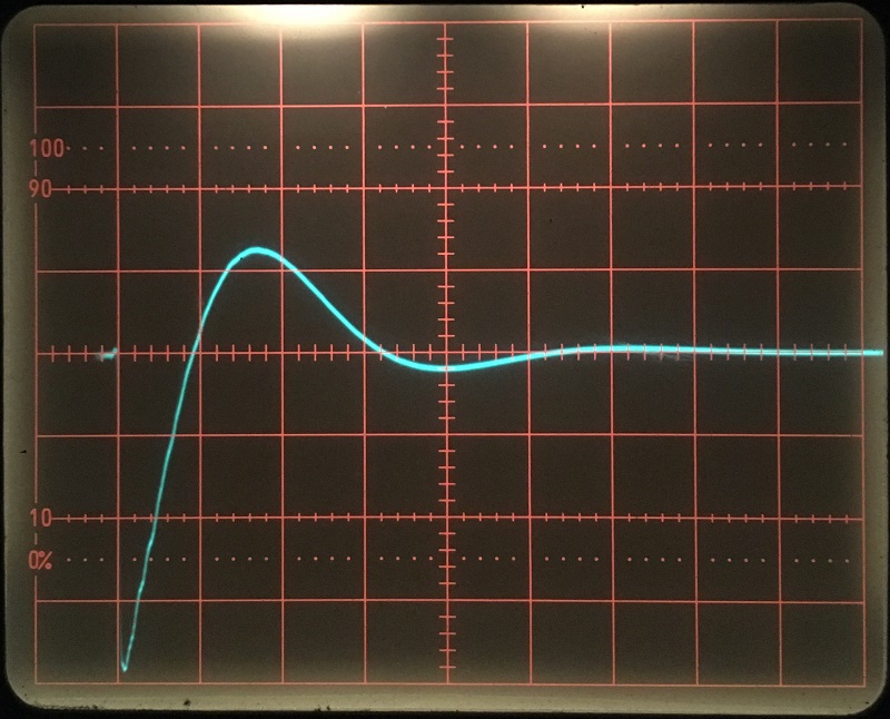

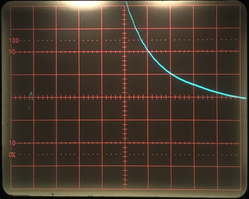

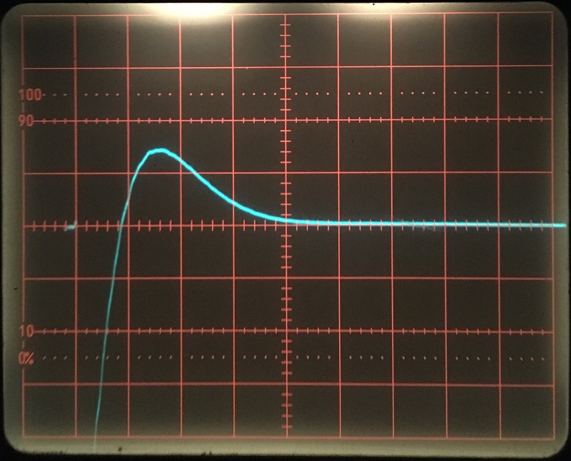

OK - let's take advantage the teaching moment... 😉
Well, honestly... I have NOT built back, but too a known good 750VA transformer, did a thorough snubber RTFM 😉 and then went to measurements. You see my set up in the first image.
Three initial findings:
1. varying Cx can/may be helful, even advisable if Rx values get too low
2. optimising Rx by a "normal" scope trace is a bit tricky (i.e. coarse)
3. my Rx "extension" is not the problem
The 750VA measurement (despite the long story, this literally took a few minutes!):
For this I connected the 500Ohm and the 100Ohm Pots in parallel (i.e. two Jumpers) and tuned the 500Ohm first. When I thought "this looks optimal" I increased vertical resolution from 1V/Div. to 50mV/Div. and Ha! ...there's still a hump in the curve! So I went on by slowly tuning down the 100Ohm Pot. to find the optimum. Look at the sequence of measurement traces: The last trace looks OK to me, may be there's a hint of a bump, but so be it 😎
So these are my results for time being, up for discussion and advisory.
Best Regards,
Winfried
Best Regards,
Winfried
