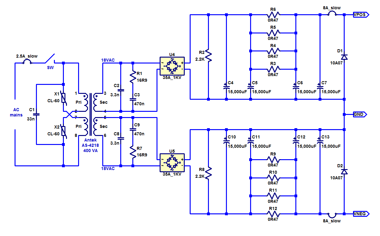

However I myself absolutely insist upon always setting Cseries >= 15 * Cparallel . In the notation of the Quasimodo design note, Cs >= 15 * Cx . The recommended starting point for experimentation is
Here in the Quasimodo thread, I have offered the advice "If you know what you're doing, do whatever you like. If you don't know what you're doing, use Cs=0.15uF and Cx=0.01uF". More than once.
And I took that advice myself. I built a power supply for my First Watt "M2x" class A power amplifier, schematic below. Since I knew what I was doing, I set Cs however I liked. I set Cs to be a factor of 142 greater than Cx. Not a factor of 15 ; a factor of 142.
I strongly recommend choosing Cs >= 15 * Cx unless you know exactly what you're doing.
- Cs = 0.15 uF
- Cx = 0.01 uF

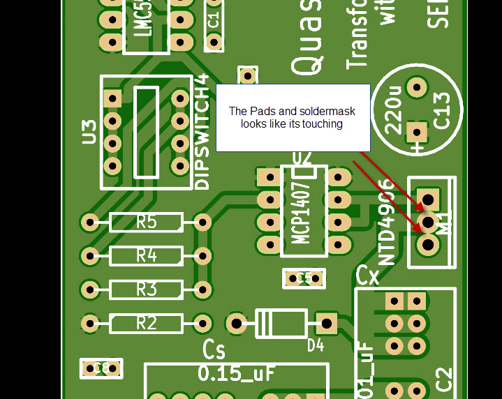

Hi Stuart,
By all means, if you are nervous about the Quasimodo PCB layout, don't use it! Hundreds of other diyAudio members have built Quasimodo from these exact same Gerber files ... but perhaps that's just a combination of plain dumb luck, plus reluctance to report an unfavorable result.
The Quasimodo schematic is fully disclosed and the parts placement on my 2013 PCB is fully disclosed, including the "IPAK" footprint for the MOSFET. That will save you some time if you decide to re-layout the board. Perhaps you will choose to instantiate a TO-220 MOSFET footprint (?) rather than IPAK. I encourage you to perform this exercise; you'll have fun, you'll learn a couple of things, and best of all, you'll end up with a layout that does . not . make . you . nervous. How valuable is that? (answer: infinitely valuable!)
Seize the day. Create the best electronic designs and PCBs you possibly can. Don't accept compromises. Follow your heart!
MJ
MJ
