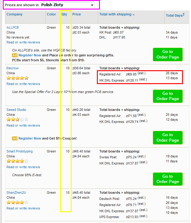

For anyone who needs boards made. I had these made at https://www.seeedstudio.com/fusion_pcb.html , and from memory 10 boards cost about $18 incl shipping.

Last year in August I had an all to easy, event free experience with Seeed Studio making 10 of "V4 Through Hole" boards for a total, inc. postage to North Sydney Australia, of $AU32.10. I simply sent the provided Seeed files and got back the boards which look OK, see scan attached to my first post in this thread. I chose Seeed's cheapest option; the following cut and pasted from my Seeed completed orders page:
PCB Dimension - 5cm Max*10cm Max
Layer - 2
PCB Thickness - 1.6mm
PCB Qty. - 10
PCB Color - Green
Surface Finish - Hasl
Copper Weight - 1oz.
Panelized PCBs - 1
The boards are (99 x 46 x 1.6)mm and weight 14.6g each.

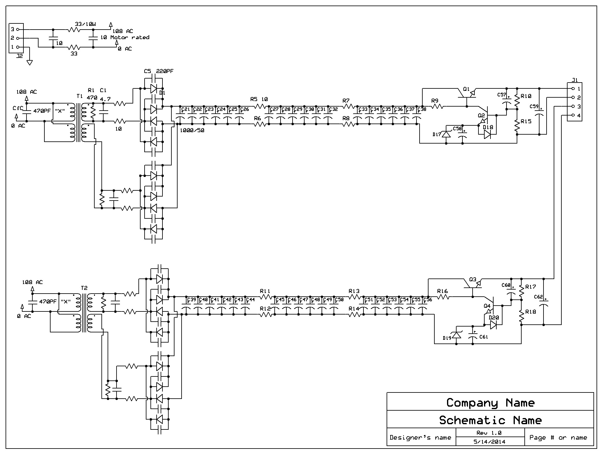

C14 is in series with C8. So it is effectively across the power transformer.
Snubbing a schottky diode with a high value of capacitance is probably not a good idea. A capacitance of more then 500pF probably lets in more noise from the power line than it squelches.
Overall this is not a state of the art power supply design.
Better results would occur using a transformer snubber on each winding. Then using a full wave rectifier on each winding before filtering and regulation. The common or ground can best be combined after all of this. Another added technique is to reverse the phasing on the two transformer windings feeding the pair of bridge rectifiers and then adding a rail to rail capacitor to the outputs.
With transformer with two secondaries and two bridge rectifiers I do not see how reversing the phasing has any influence. I tried it in my system without any results. I wish to know theory behind it. On power supply schematic, any position is correct.
It is a technique to cancel HF noise riding in on the power line. The simplest version is to put a capacitor from the dot on one winding to the not dot on the other and a second capacitor from the dot on the second winding to the not dot on the first. This makes an easy to measure drop in power line noise. (If you have the right equipment.).
As to the effect it had on what you perceive that depends on your transformer winding balance, equipment, location etc.
But you do get a star for trying it.

My transformers are flatpack PCB type with split primary and sec.
There are no capacitors connections you have described, in your PS which is attached.

That is an older and more complicated design. Measured it had 20 dB less noise pass than the two winding version. The simpler version just uses a single transformer and the capacitors to cancel the line noise. Still a work in progress. Just added some test equipment to do a bit more investigation of noise paths.
As to the flat pack design I have some that are great and some that mis-match by 5% or so. A quick check of the AC voltage on each secondary will show the match quality.

Q2 is a shunt regulator feeding a series pass follower. A common circuit before IC regulators became available.
Joined 2011
In fact the circuit in #1112 was the grandfather of Walt Jung's "Pooge 5.51" super duper voltage regulator; Walt replaced R1 by a PNP constant current source, and added a PNP emitter follower between the collector of Q2 and the base of Q1. He also added a couple flourishes and pirouettes that I encourage "serious students of the art" to look up: R859 and Rr3. Google for walt jung pooge 5.51
