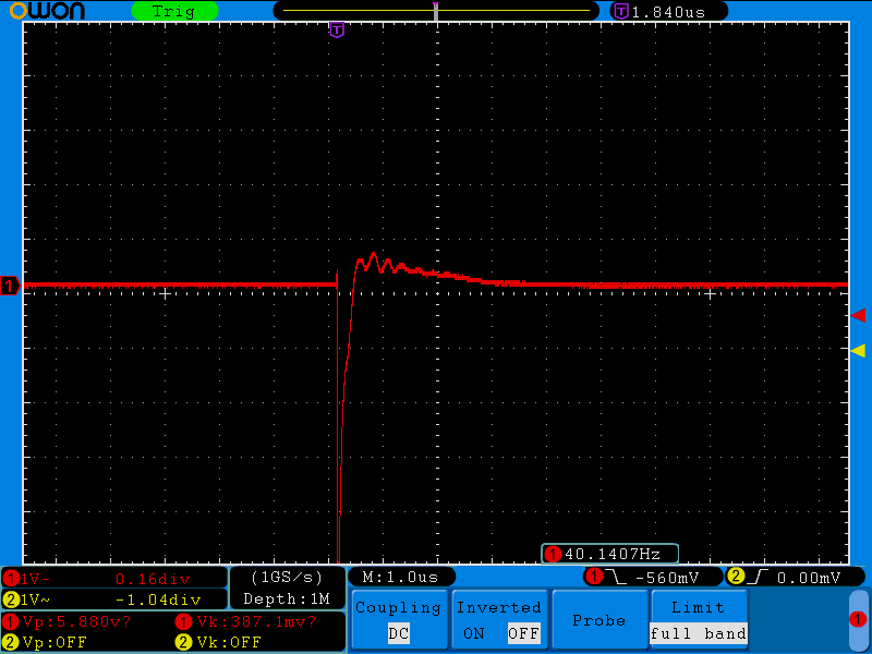

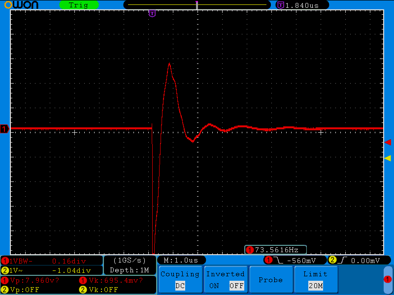

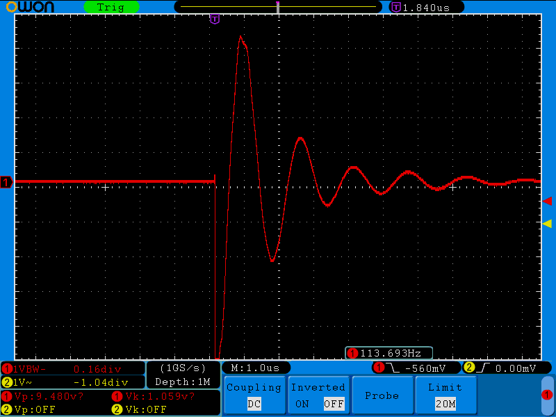

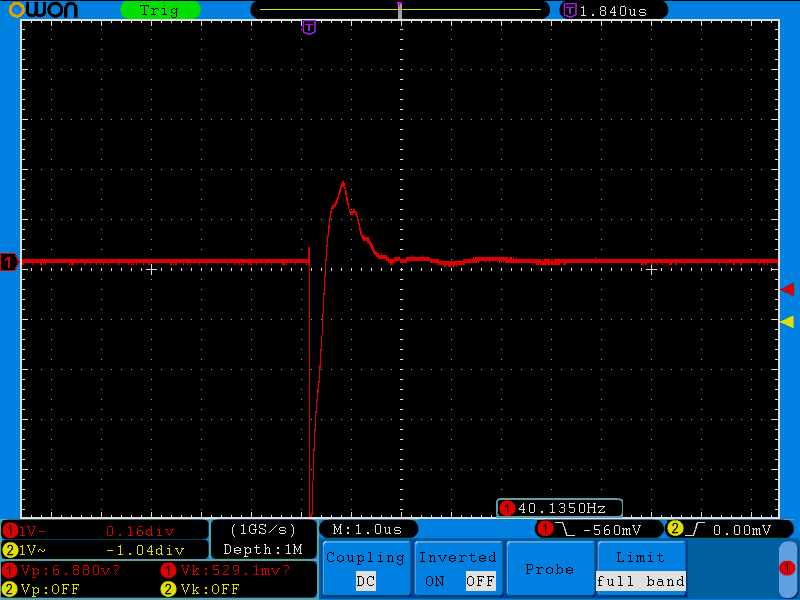

Hi to all.
I have an amp psu with a center tapped transformer.
I followed the connection direction as described at the datasheet, p.11 fig.13 "Center Tapped Secondary"
The initial measuring was the following
As decreased the variable resistor values the capturing was:
With the last final position to:
As you can see, there is no any smooth snubbering, but why? Any suggestion is welcome!

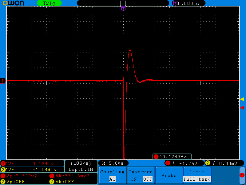

The previous captures was with Cx=0.01uF, Cs=0.15uF, R=28R.
I saw at the psu of my amp that it uses Wima 0.1uF/63V parallel with each diode. As described at the datasheet p.6 fig.8 these capacitors are the same position of Cx.
I tried this Cx 0.1uF value with the Cs=1uF and the final capture was OK with 11R resistor.

Andrew thanks for the reply.
No, I didn't removed them. My test wasn't on the psu circuit.

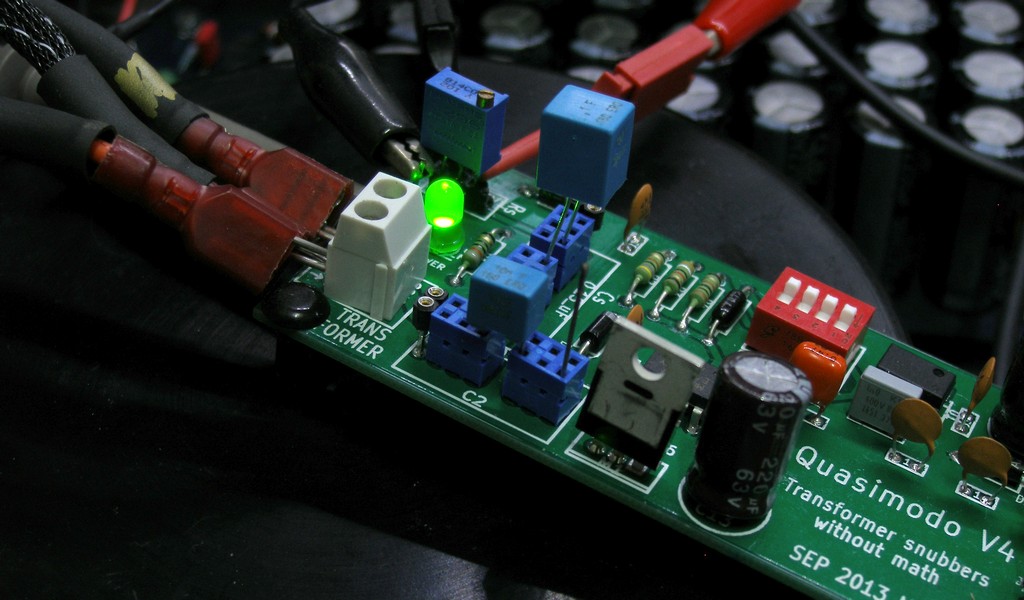

This psu is from Aaron No3 Millennium. The 500-600VA transformer has +35.9/0V/–35.9 Vac secondary.
First, I removed the secondary from the psu and make the appropriate shorting at the primaries. I used the suggested Cx and Cs values on Quasimodo Test, as described at the datasheet but I haven't smooth capture.
Then I read again the datasheet and I saw at p.5-6 fig.8 Mark's notes for the Self’s Elektor Preamp-2012, that the C15...C17 with the 47nF (parallel to each diode) is the Cx (p.5 at the end), this psu is center tapped also.
At the last, I used the 0.1uF as Cx and 1-1.5uF to Cs and the results was OK, as you see.
I see, that the Cx is across the transformer secondary, but I have confused with the Mark's prompt for the Elektor Preamp.
Sorry for my English...

At the Quasimodo test, no.
I shorted one of the secondary windings to the center tap, and connect the other winding and the center tap to Quasimodo. I used one Cx and one Cs on quasimodo test pcb. As the 1st photo on my 1072 post.
It wasn't OK?
It wasn't OK?

Back to the pics:
what is the difference between last pic in post1072 and the pic in post1073?
Replicate that on one side of the centre tapped secondary
and replicate again on the other side of the centre tapped secondary.
Back to the pics:
How to put the right values on centered tapped secondary, I think that Mark's notes are described very well and they are identical as your proposal.
I don't have problem with that.
My problem is the right procedure quasimodo test. At the post 1072 results, I used as I told the Cx=0.01 and Cs=0.1-0.15uF but with no smooth capture.
Because I didn't know why this happening, then I tried (post 1073) other values on Cx and Cs on quasimodo test. I saw that if I used Cx=0.1uF and Cs=1uF with 11R the result is fine OK.
I am wondering about the parallel capacitors on diodes! Can I leave them as Cx or not? And why the Mark suggests this on Preamp's example (p.5-6 fig.8)?
