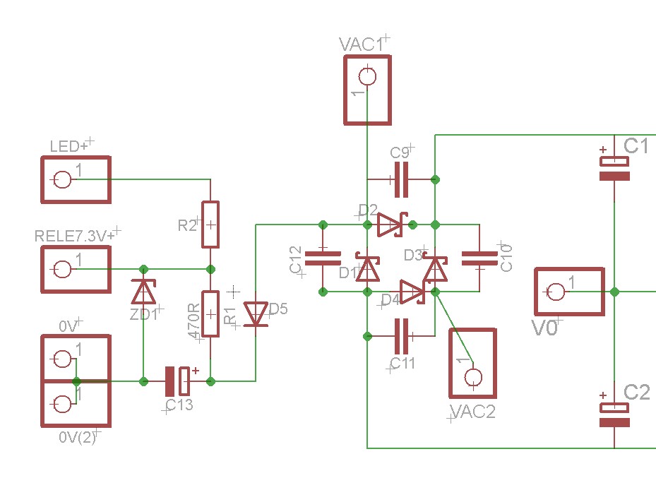

Here the Aaron No3 Millennium PSU toplogogy. Look the parallel C9...C12 at the diodes.

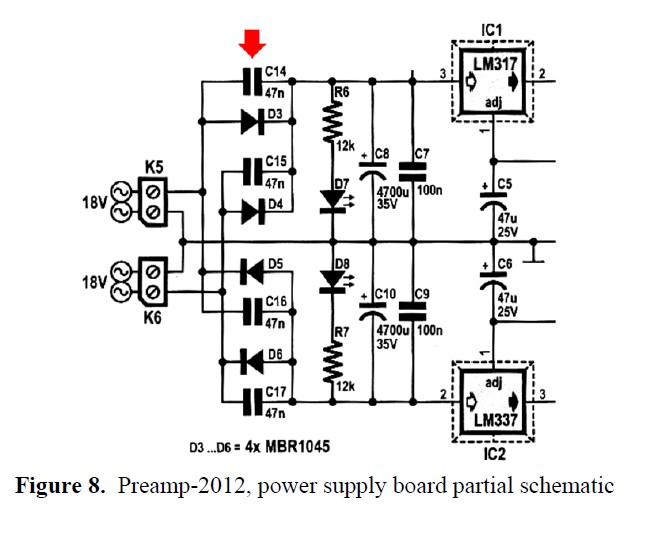

And here the Mark's preamp example. Look the parallel C14...C17 at the diodes.
That's why I am wondering about the Cs...If I am right I think that are same at the two examples. Mark says at the datasheet. that the C14..C17 can be evaluate as the Cx (except I am wrong with my bad English)

The capacitors across the rectifier diodes indeed do function as the Cx capacitors: in every half-period one of them is connected in parallel to the respective secondary.
However, in the case of a transformer built into a power supply (PS), the snubber resistance can also be determined in operation, i.e. when the PS is feeding a load. Connect the RS-Cs combination (the Rs being a trimmer) across the secondary, connect the scope, switch the PSU on, and taking the usual precautions (there are lethal volatges in a running PS!), adjust for a snubbed waveform at the falling edge, i.e. when a rectifier diode switches off.
My routine is to determine the Rs value using Quasimodo, and then to check the waveform at the secondary once again in a running PSU (with load!). In most cases, I get the correct snubbing with a value of Rs higher (less dissipation) than the one determined with Quasiomodo.

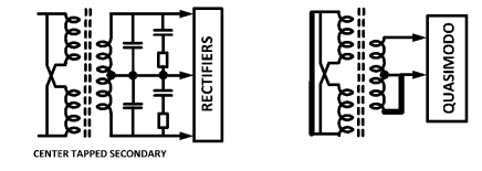

There is some confusing about this. Across the secondaries is when the secondaries aren't center tapped! At the center tapped secondaries the snubber is across of windings but with contact to 0V with the same materials and values at the two halfs. Like that:

Before this, Mark says: "...when refurbishing or modifying existing audio equipment, it is quite likely that Cx is already fitted in the circuit. For example ... in D. Self's Elektor Preamp-2012, Cx=C14-C17=47nF."
From what I see, this topology is a Center Tapped Secondary. But the C14-17 is across the transformer windings but without contact to 0V!
587529d1482573386-simple-no-math-transformer-snubber-using-quasimodo-test-jig-preamp.jpg
And Mark says that C14...C17 is the same like Cx.
Is that the same topology like center tapped secondary?

Have I the same topology like Preamp-2012 or not. Are mine C9...C12 (100nF each) the same with Cx and don't need to add two Cx more?

C14 is in series with C8. So it is effectively across the power transformer.
Snubbing a schottky diode with a high value of capacitance is probably not a good idea. A capacitance of more then 500pF probably lets in more noise from the power line than it squelches.
Overall this is not a state of the art power supply design.
Better results would occur using a transformer snubber on each winding. Then using a full wave rectifier on each winding before filtering and regulation. The common or ground can best be combined after all of this. Another added technique is to reverse the phasing on the two transformer windings feeding the pair of bridge rectifiers and then adding a rail to rail capacitor to the outputs.
